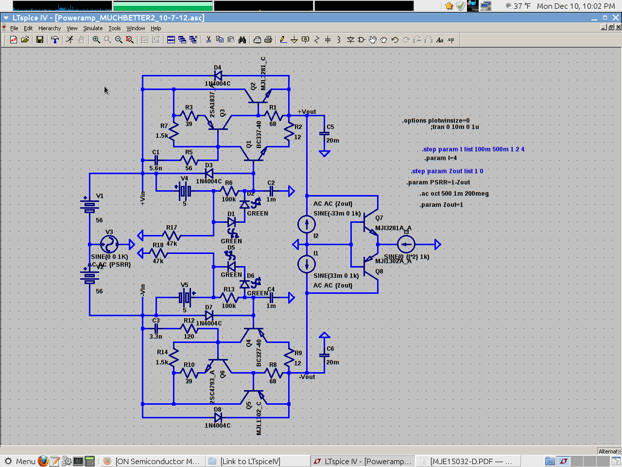

Here is a poweramp version of the Kmultipliers. I use this on the class AB BJT amps I design. FET amps don't seem to improve that much with it.
As you can see, going over a few amps gets messy. This is the version I will try out next; I haven't tested it yet but it should be better than my previous version. Consider it experimental.

Is that extra transistor to increase the base drive on the Q2 o/p transistor, and the C1, R5 for extra stability? Increased bias to 5 volts? 56 volt rails, a big power unit?

The power Kmultiplier must push the same currents as the output stage it's powering. The third transistor is needed, if not for drive, then for increasing current gain so that R6/R13 can be very high. Furthermore, at these currents the output and driver will have bad Early voltage so we need a TO92 BJT with great quasi-sat specs to apply feedback and fix it up.
C1/R5 are for stability.

The schematic I sent you contains some possibly misleading features:
1: Output devices are 2SD669A/B649A. These will work to 100mA, but the 2SC5171/A1930 work to 300mA, are just as fast (if not faster) and are easier to get for some people.
2: Drivers are BC547C/557C. The BC550C/560C have slightly better noise specs, not sure if it matters but I prefer to buy the superior part anyways if it's of little consequence to the wallet.
Here is a cleaned up, nice schematic representing the ideas I described to HiFi.
- keantoken

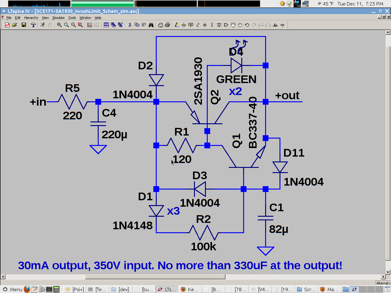

Can I use this schematic for HV 150-350VDC only with caps appropriate rated voltage capacitor? I want to use before the Salas Shunt Regulator HV2.

Yes, you can use it before the HV2. Tell me what your input ripple is and the current draw, since I will need to change the circuit a bit. If you increase R2 (website schematic) to 10k, you can use 82u instead of 820u. You may even be able to use 100k and 8.2u; it depends on loading.

If you have 30mA load current and 470uF capacitance after the rectifier you should have .5V ripple. Input ripple for the Kmultiplier needs to be lower than 1.8V. For 1.8V ripple you need at least 140uF, if the Kmultiplier were right after the rectifier. Tell me if your supply is not beefier than this.
So if I understand correctly 240VAC->340VDC. 30mA*220R=6.6V. So I have 13.4V to work with.
Merlin, what do you think about this? The 220R/220u RC is from your supply. It took some determination to make it safe from overvoltage and inrush current, but I like how it turned out.
Don't put more than 330uF between the Kmultiplier and the HV2. Capacitance after the HV2 is okay because it will be limited to 30mA inrush.

I'm in the same situation but I can't get 2SA1930 / 2SC5171; Q2 and Q3. Could I use Q2 BC560C and Q3 BC550C instead (for applications under 50mA) and still get good psrr and stability ? I'll still use Q4 BC327-25 and Q5 BC337-25 as your page recommends.

If you use smaller outputs you need to mind inrush. At 50mA TO92 outputs may work but may blow up when trying to fill a 470uF output cap. This was my problem with the HV Kmultiplier. A TO92 output would work great for this but would be destroyed the first time it was turned on.
The BC327/337 are more suited as outputs than the BC5x0C, I would use them instead.
