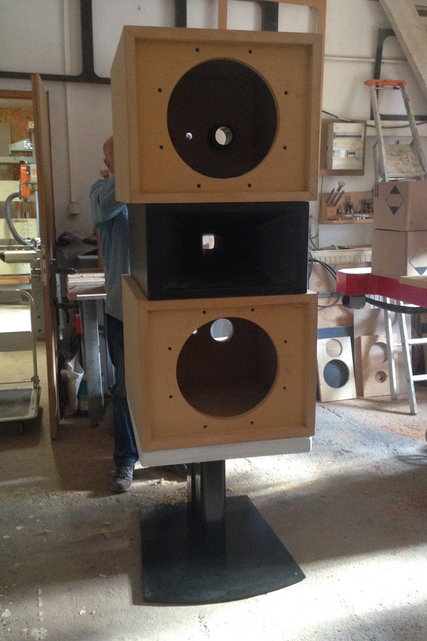

This looks impressive though.

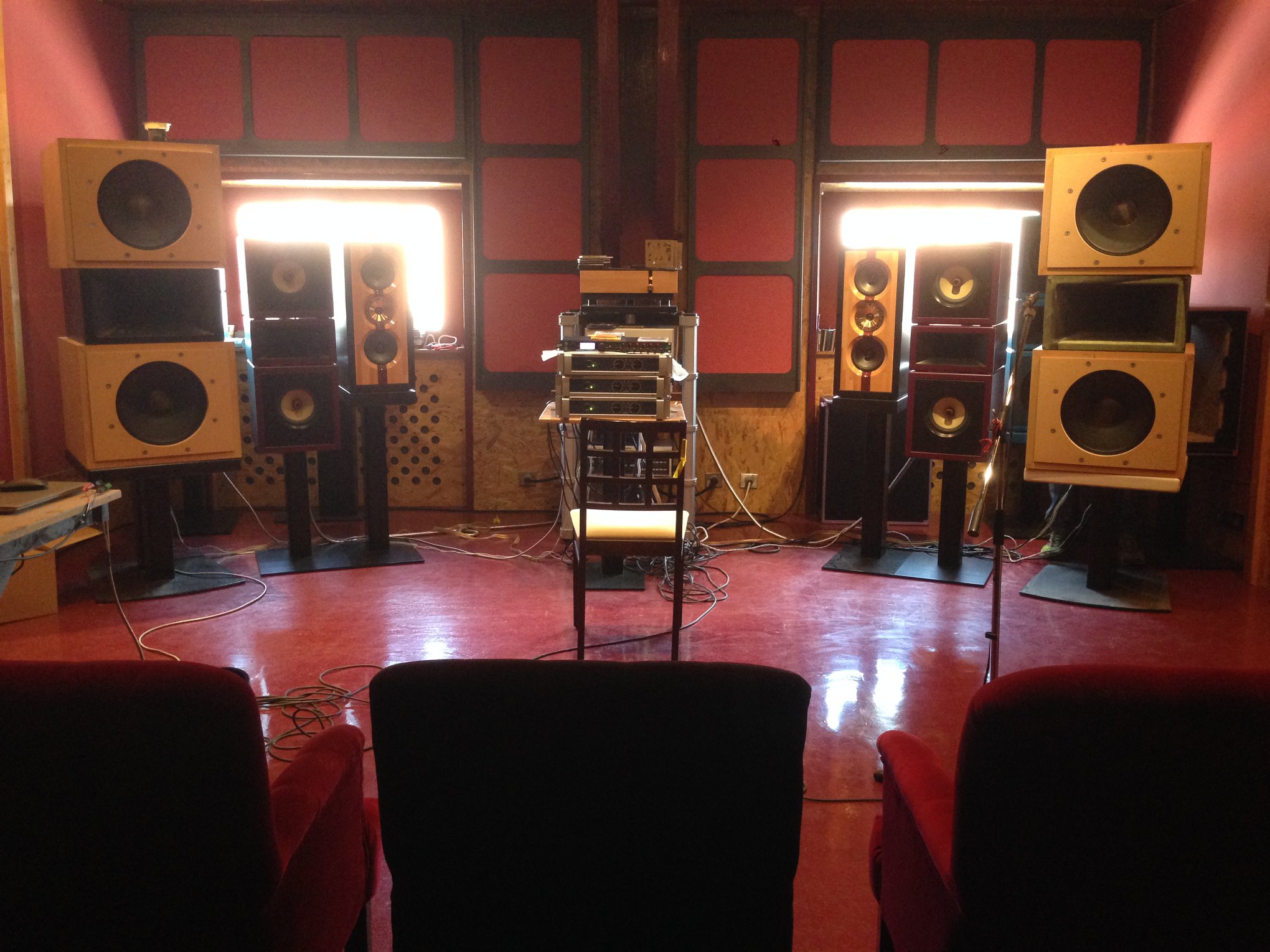

Ah so that was who was buying all the Yamaha P series amps 😉 (2nd hand prices are very elevated these days for a P7000s to the point I considered selling my rack).

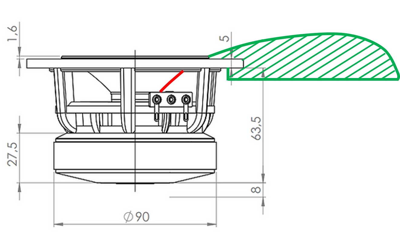

The inverted surround Is for *not helping* the formation of spurious waves (diffraction at edges). This helps in case the woofer Is used in the midrange territory where the wavelenghts are of the same size' of the 'normal' surround, so from 0.5 to 1 cm, make the math...
Sure, but what I had in mind was to make an additional waveguide which extends from the woofer cone to the rounded edge of the front baffle. The edge of the coax cone protrudes a bit from the surround so there is enough space for a 3D printed structure. The attached picture shows the coax cone in red and the waveguide/baffle in green.
Rough idea would be to combine the coaxial driver with a woofer like wo24p as a standmount monitor and cross them at around 300Hz or so. The goal would be to control directity and minimize diffraction (and get more experience in CAD, CNC, and 3D printing).
