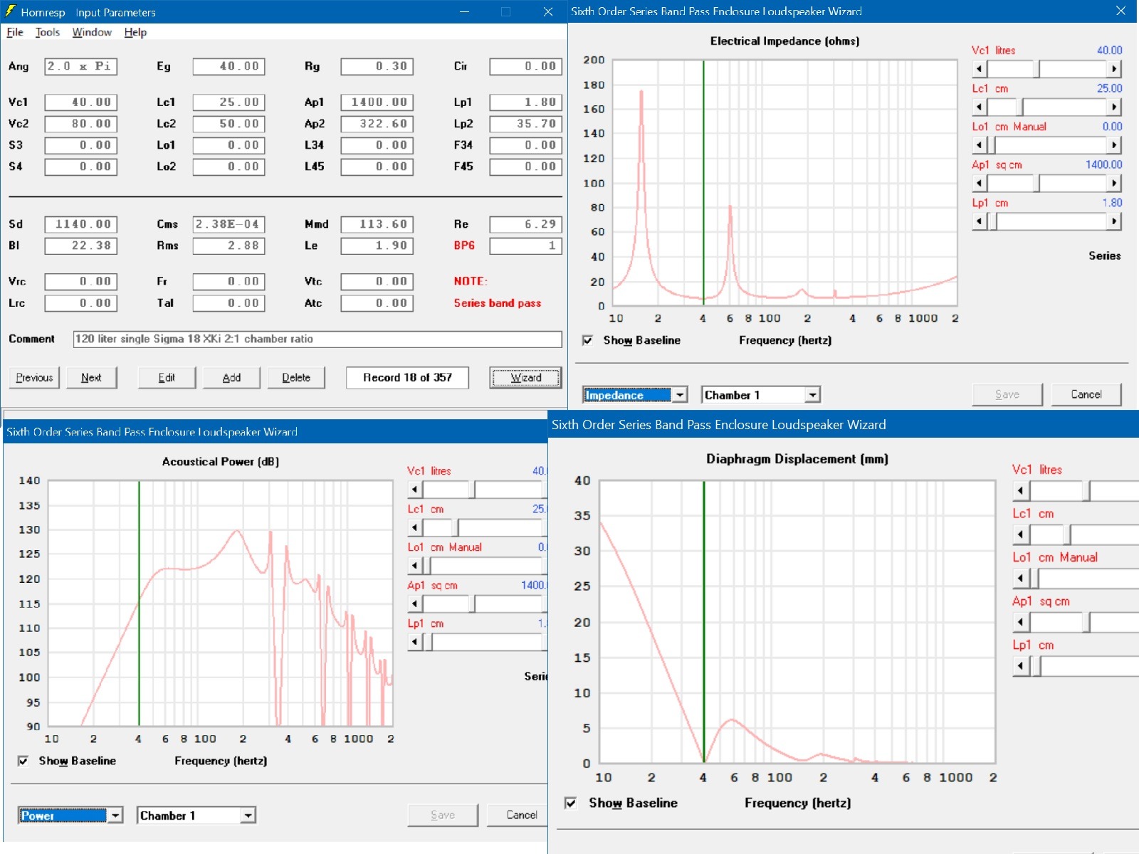

One could dispense with the upper part of the front chamber and make an 18 inch driver version of my "Kube12" cabinet - an XKi
With a 2:1 chamber split that's 80 liters foir the rear chamber and 40 liters for the front chamber. I don't know if it wold come clowe to a bandpass sim - but maybe pretty close:

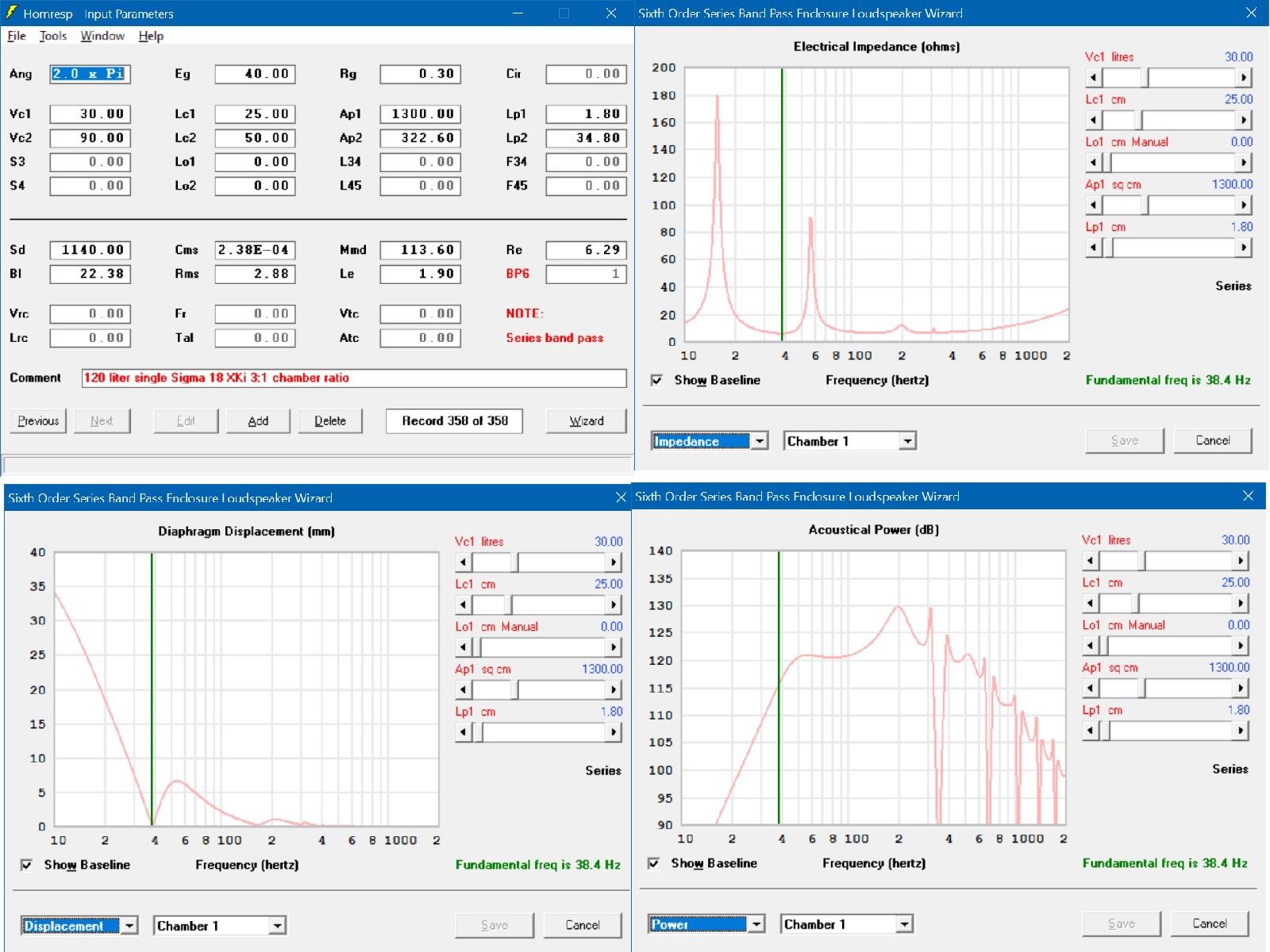

you could make a 120 liter 18" XKi with 3:1 chamber ratio -remember to add driver displacement and bracing to the rear chamber volume for the build.
As mentioned before a 1.2 scaled 115BK Acoustic Control cabinet would make a compact "k18" of K15 bulk with very little vent compression at high levels.

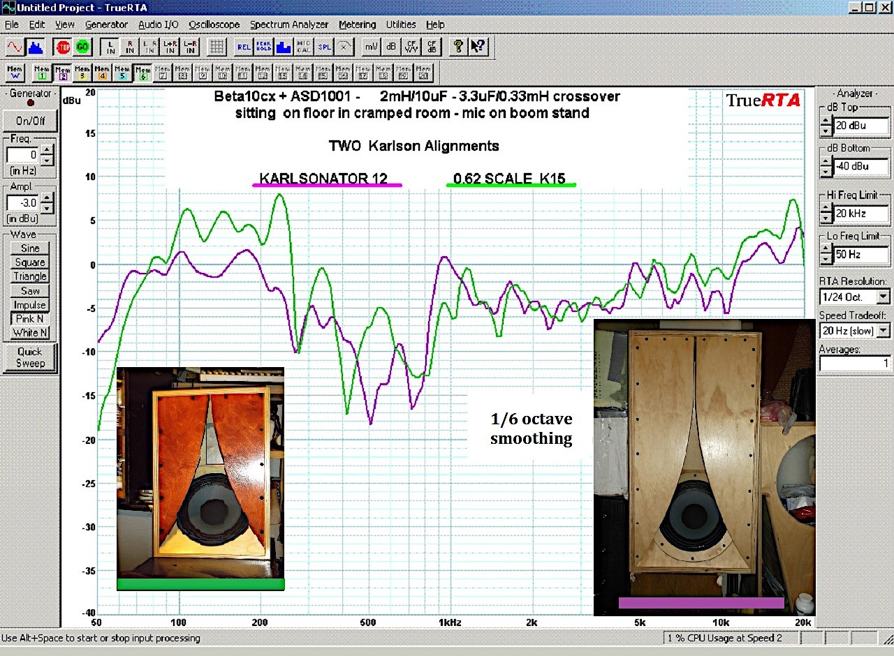

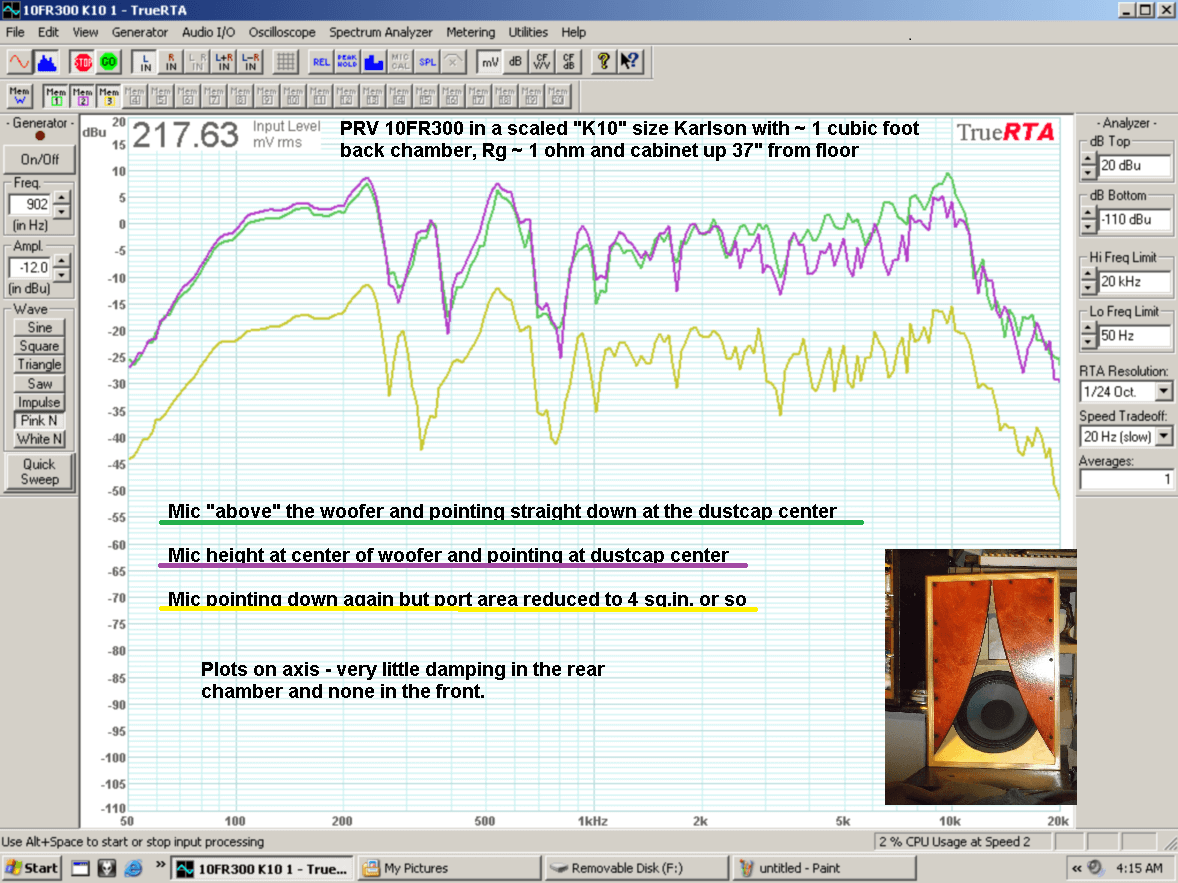

here's a 10 inch Beta 10cx in a 0.62 size K15 vs the same speaker in a much larger Karlsonator -the little box was stronger in one area.
Your Fane 10" might work out ok
Also - here's a higher qts PRV 10 in the 0.62 scale K15. K15 = the original Karlson cabinet from 1952.

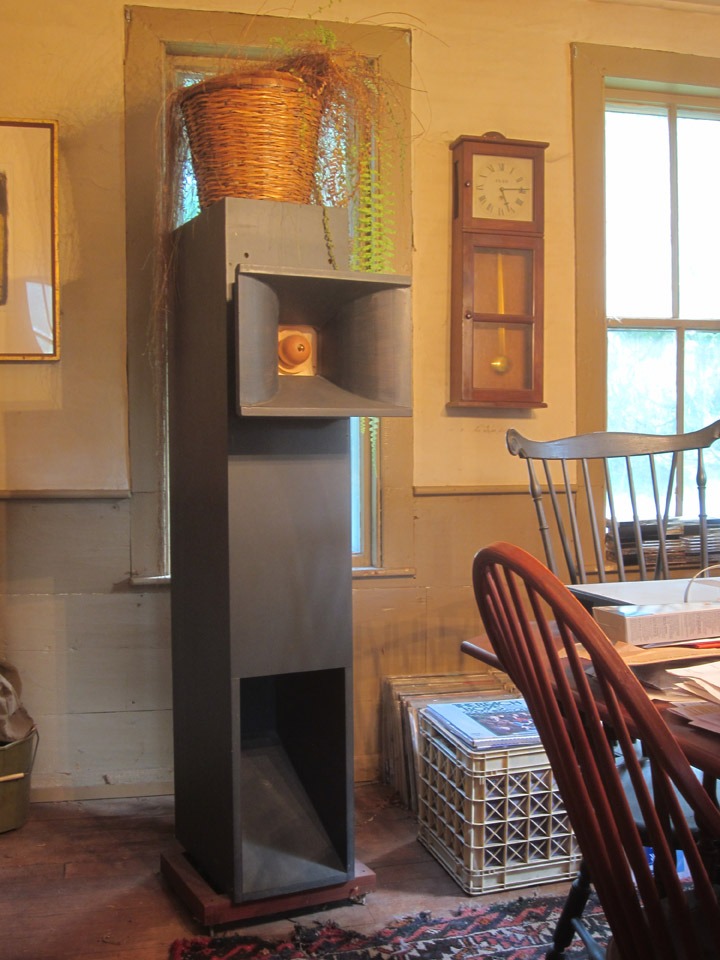

My current interest in the Karlsons is to correct problems with my implimentation of Lowther PM2As in Front-Firing Fidelios, see attached, which have an objectionable resonance for both male and female voice in the frequency range of 200-400 Hz.
I have some pairs of Altec LF drive units...515-8G, 416-8C, 416-8A or B, can't remember...that I'd like to try in Karlson cabinets, to run them with 500 Hz crossovers. to try to eliminate the resonance problem, allowing the woofs to run up to ~500Hz. So, not to use them as sub-woofers.

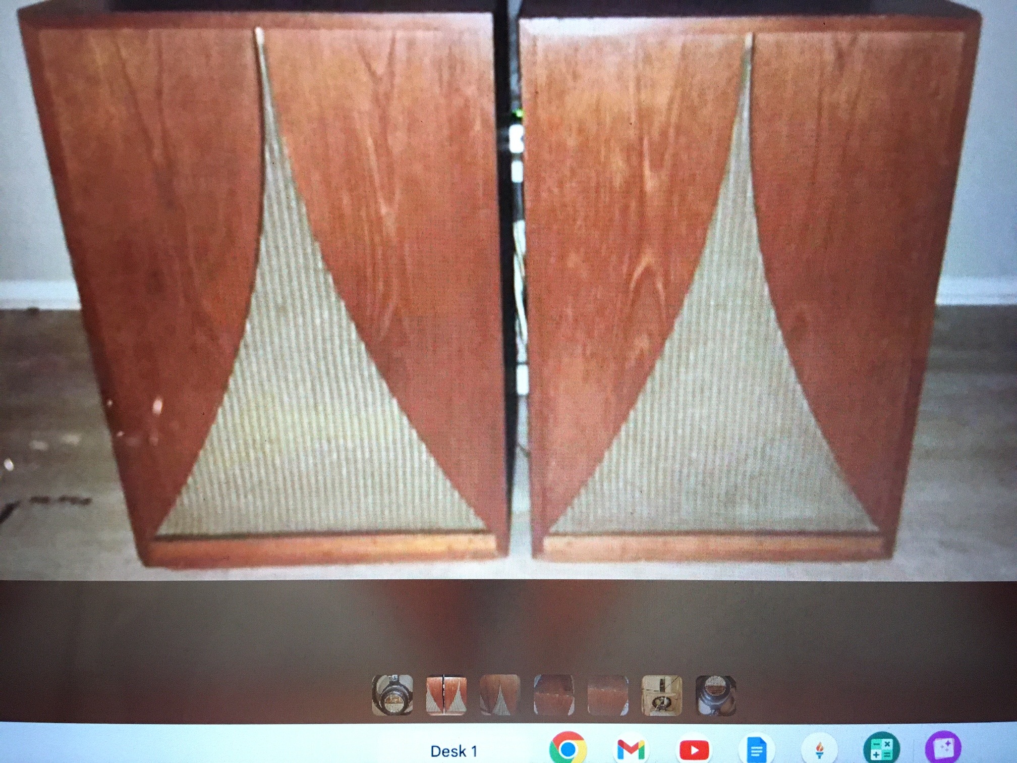

And so, I check ebay from time to time to see if any Karlsons come up. And a day or two ago I found a pair of Karlson X15s, not K15s, so the smaller enclosure introduced later on. Reading this thread, the X15 was smaller and had a curved, 3 section upper divider, but the ebay listing shows the same upper configuration as the K15, vertical with a 45 degree slant forward element at the top. The ebay listing is at:
https://www.ebay.com/sch/i.html?_fr...m570.l1313&_nkw=Karlson+X15+cabinets&_sacat=0
It seems very different from what I find in this thread as the description of the X15.

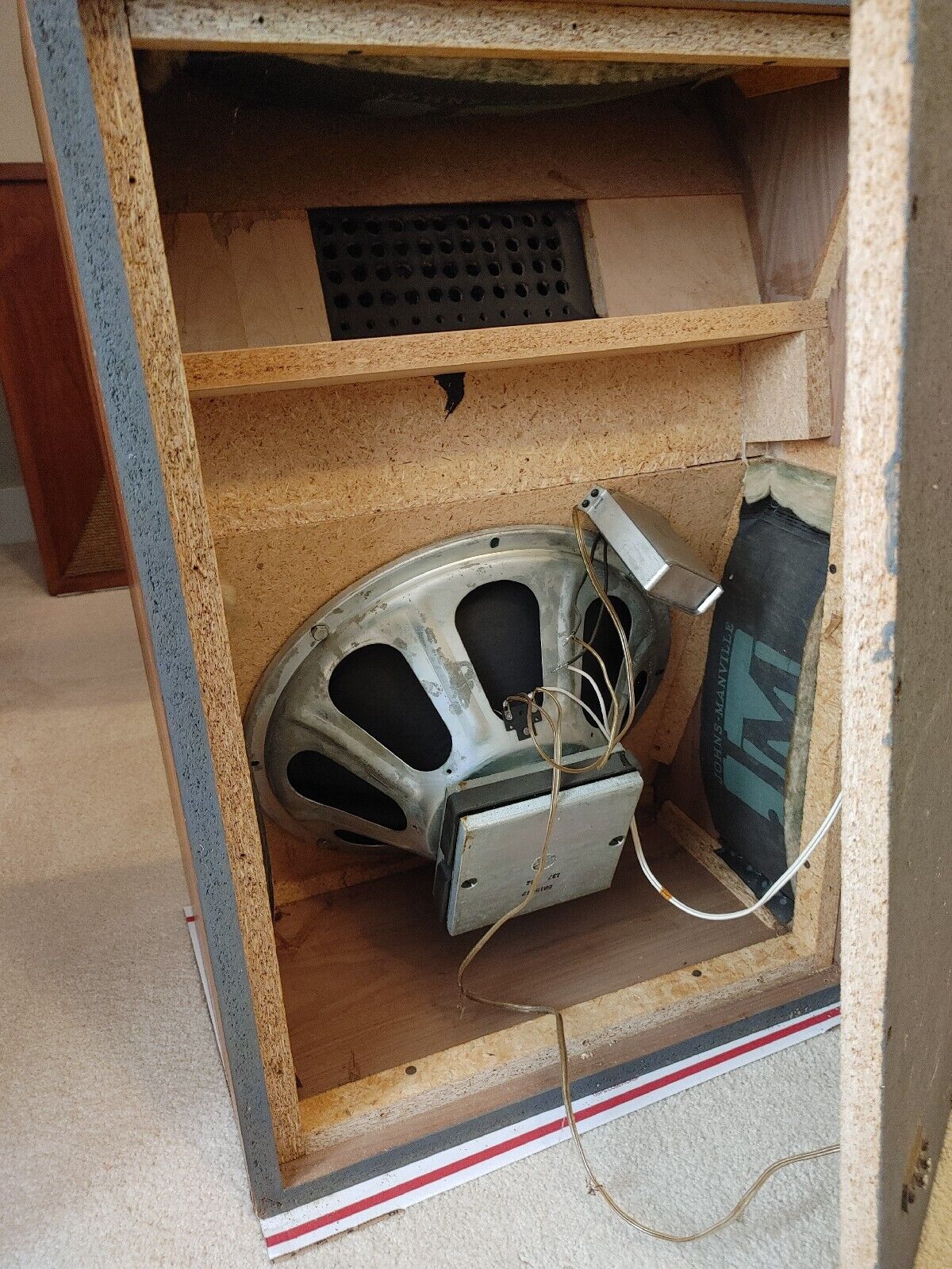

That's the K15, introduced formally at the HiFi Fair fall 1952. The seller is ignorant. X15 was announced in the October 1965 AUDIO Annual Directory and has nominal dimensions of 28" tall 20" wide (mine are more like 19.375") and a depth of ~15 inches. They are one cubic foot more in external bulk than a K12 and could make an interesting system with a subwoofer.
K15's often sell for less than 10th of that asking price. I'm about to get rid of a rough pair so my kid can take over my house. I might give those away.
An X15 would probably start rolling off below 75Hz or so.
Reactions: moray james
Look like factory particleboard K15 to me. X15 was nominally ~28"H x 19.375"W x 15"D with a three panel quarter ellipse approximation reflector (per Fig.6. of patent 3540544)

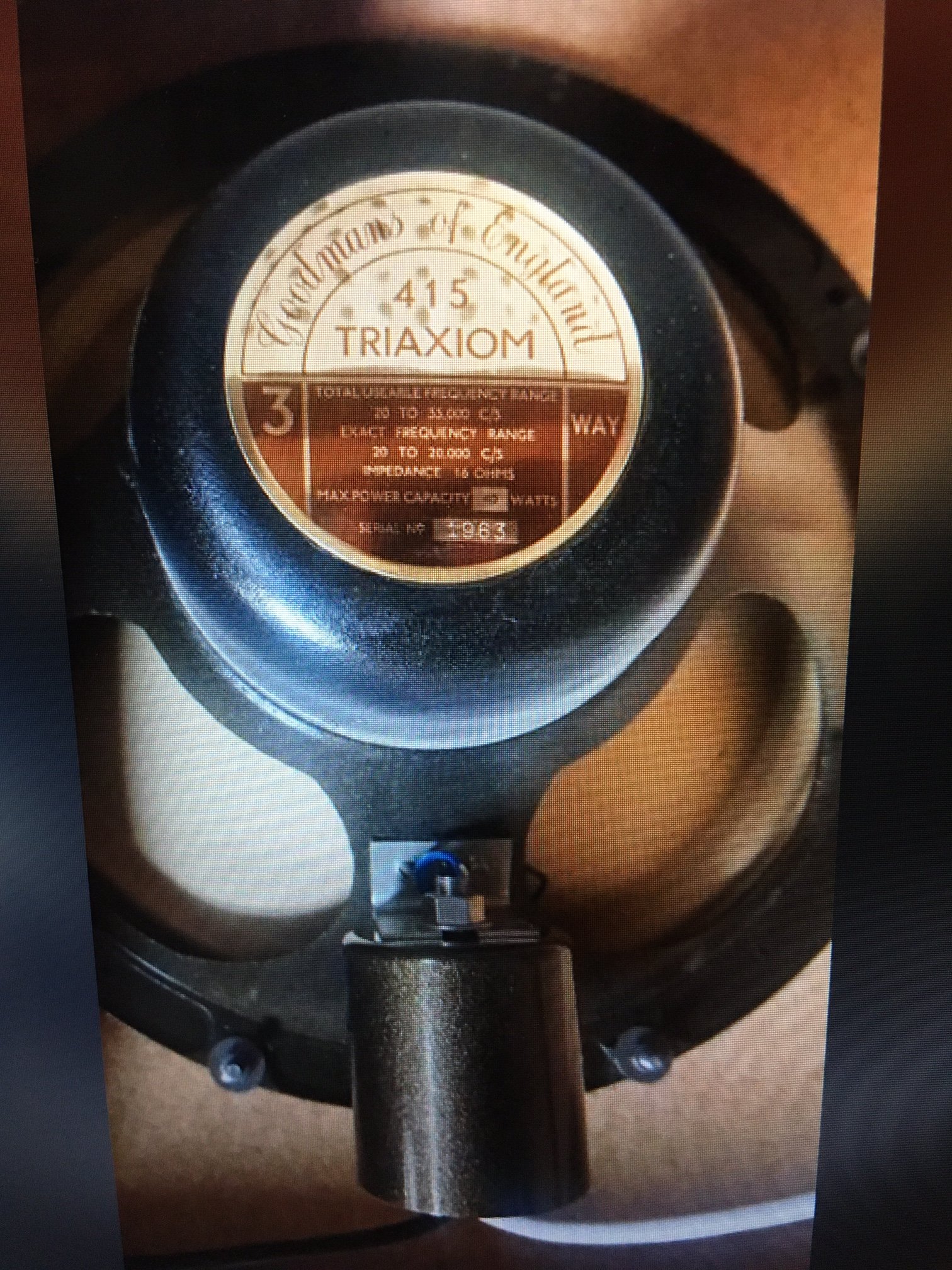

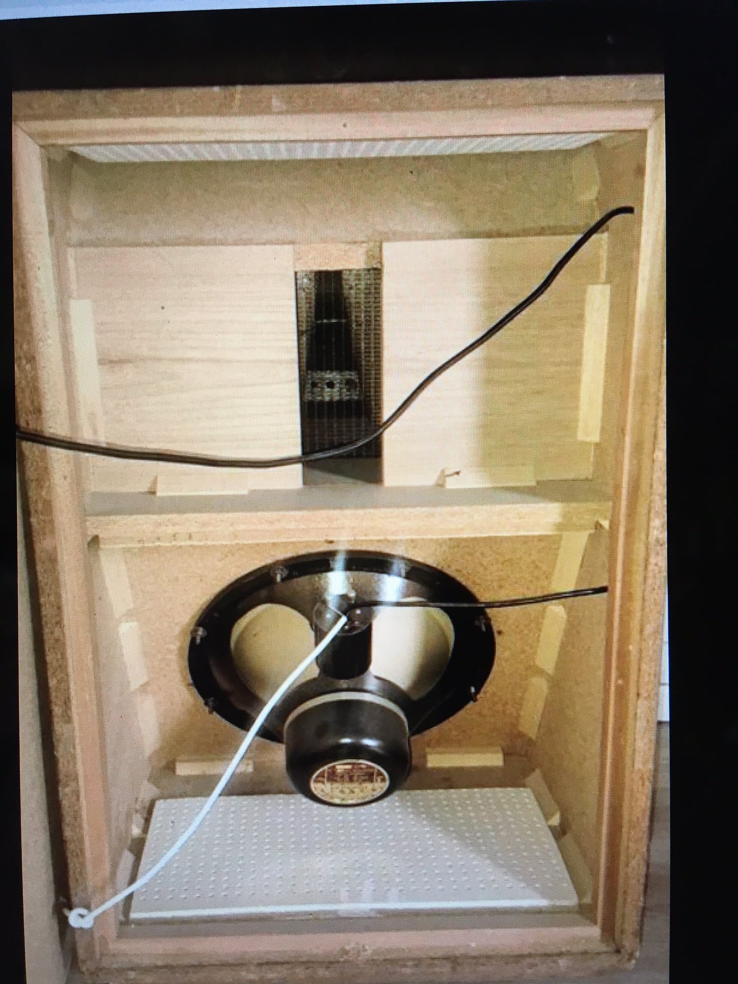

freddi , thank you for the response and knowledge on this , I think what attracted me most about this pair is the 28 lbs. each " goodmans of England 415 Triaxiom drivers " in them............ not much out there on these but what I did find compared them to Altec 604's and some say better . ....... the speakers in the picture are not the ones for sale but the same as you can see in my original post in the ones I'm looking at .
Vintage Triaxiom 415 Goodmans of England Speakers Great ...
