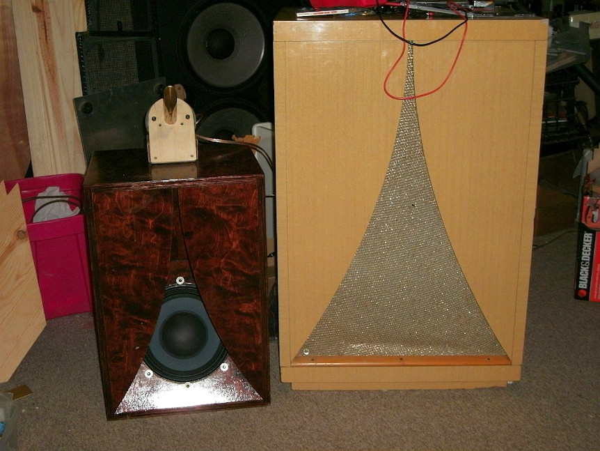

Have you seen any grill cloth, especially something "sparkly" for sale recently ? - its seems almost impossible to find silver or gold of that type. My blonde K15 have the silver - that's the Fisher Doctor's K15 with gold cloth and mahogany "Karlsonite" (Formica) - and my vote for the most beautiful speaker in the world 😀. and don't understand why its not in a museum as example of the best of the atomic age.
I'm most interested these days in finding the perfect "K10" - meaning somewhat smaller than K12 yet the punch of X15. An "X10" could be nice. Eminence's Delta10A has the kind of motor needed - there's one in that K10 next to my K15. XRK971's "XKi" might be the ticket if there's not too much peaking in the 200-300Hz region. A smoothing stub can be used in such cases.
My blond K15's Formica is faded - is there a safe way to get it looking better ? - It looks just like the one at the 1952 show.
BTW, speaking of Formica type laminates, just having the laminate on one side of so-so grade 3/4" plywood, really stiffens panels - it would be good to use on K wings.

did someone say grill cloth...Mellotone Acoustic Fabrics Canada - Largest inventory and selection in Canada.
Thanks Turk 182
would this "spandex boucle" stuff be acoustically transparent enough ? would it look good as a speaker cloth ?
GOLD METALLIC STRETCH SPANDEX BOUCLE FABRIC (45 in.) Sold By The Yard | eBay

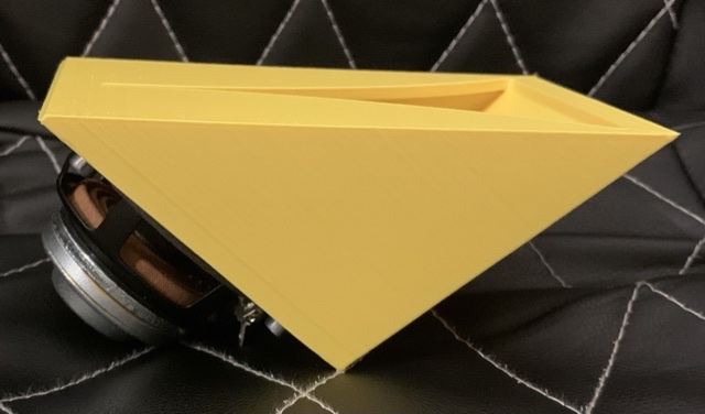

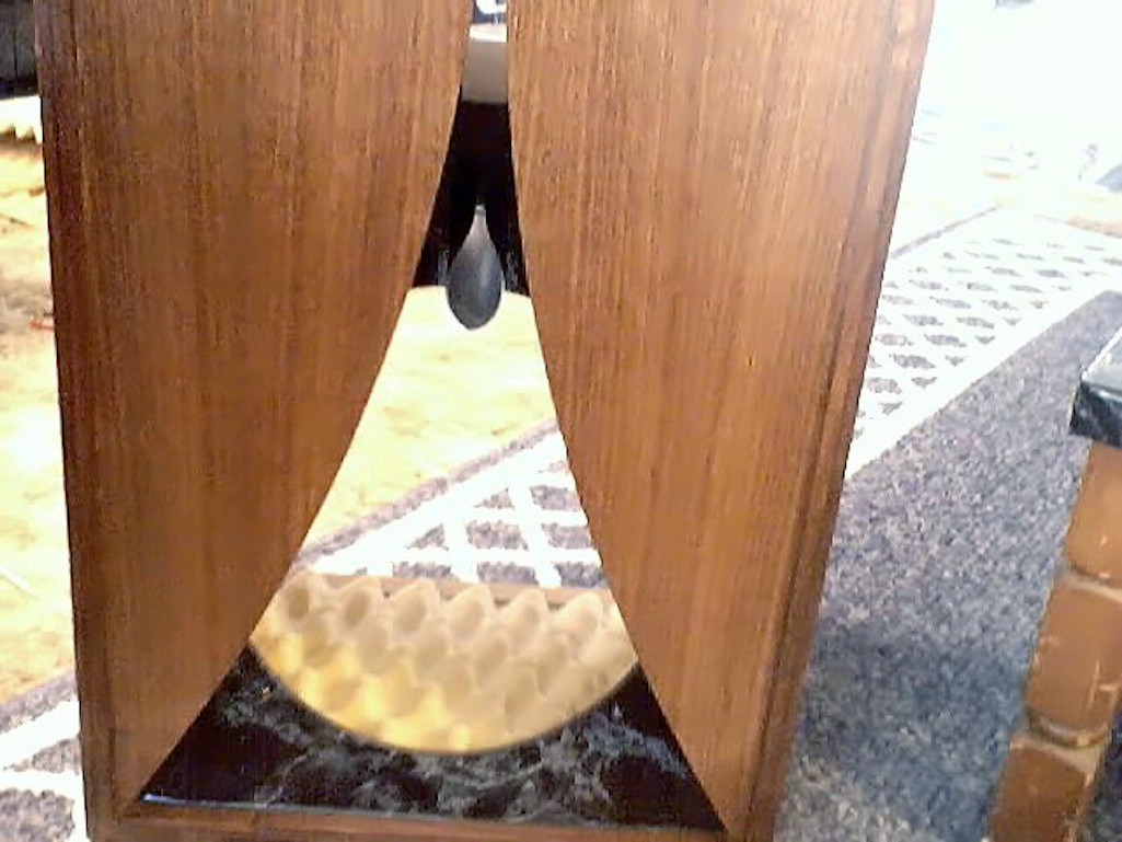

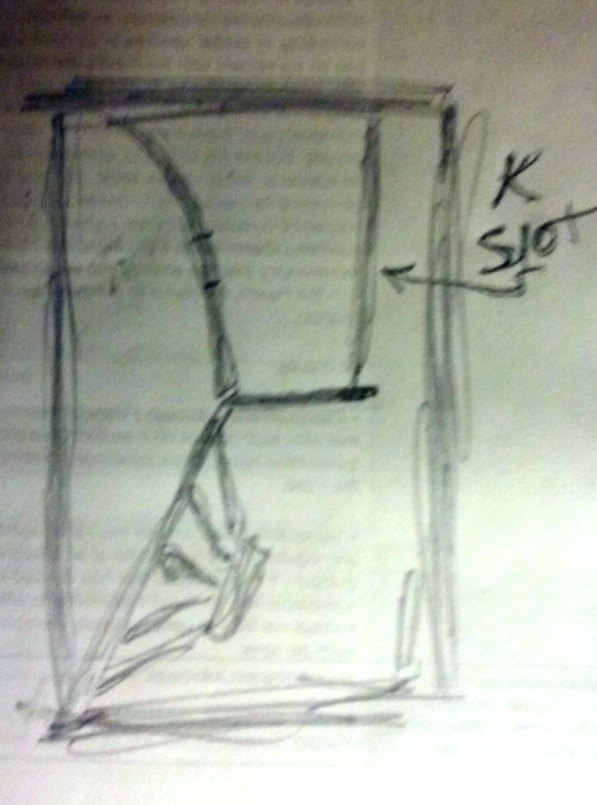

hey pelanj - maybe you could make a curved cardboard "reflector" to put behind the mini-klam to get some.rough idea of how that worked. IF not too tall, it might sit on the front shelf of your K15 clone. Be careful - I've kicked a 5lb driver and K-tube forwards on percussion. (did not hit the cone -ha)
that is interesting, and although not the same, there was a T-line tapped pipe design featured in Klang & Ton some time ago which had a K-slotted internal partition.
maybe XRK971 has some ideas on how to approximate your drawing's actions.

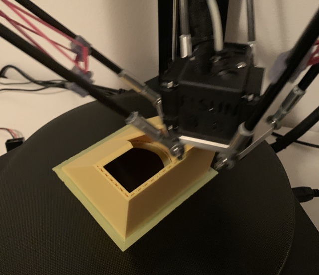

That looks amazingly clean and nice - how thick are the walls ? Do you think some sort of back chamber would be needed to prevent cancellation at lower frequencies?
4 mm walls printed with three perimeters and 30 % infill or so, the back chamber is to be printed, maybe tomorrow. It is just a quick and dirty model, so it will be held by double sided tape only and some tape outside to make it air tight. Inside the slot there are some cosmetic issues, but the structure is very dead and rigid.
its likely much less resonant than 6mm Baltic birch plywood. Regarding a "back chamber", a styrofoam coffee cup is traditional 😀
Yes, but we do not have these around, so printing is easier for me🙂 If this will seem promising, I will make a proper model with roundovers and mounting points. My gut feeling is, that it will be interesting, but maybe not so good in the top octave.
Hi pelanj, that's great work, Post #33, and so fast! 🙂

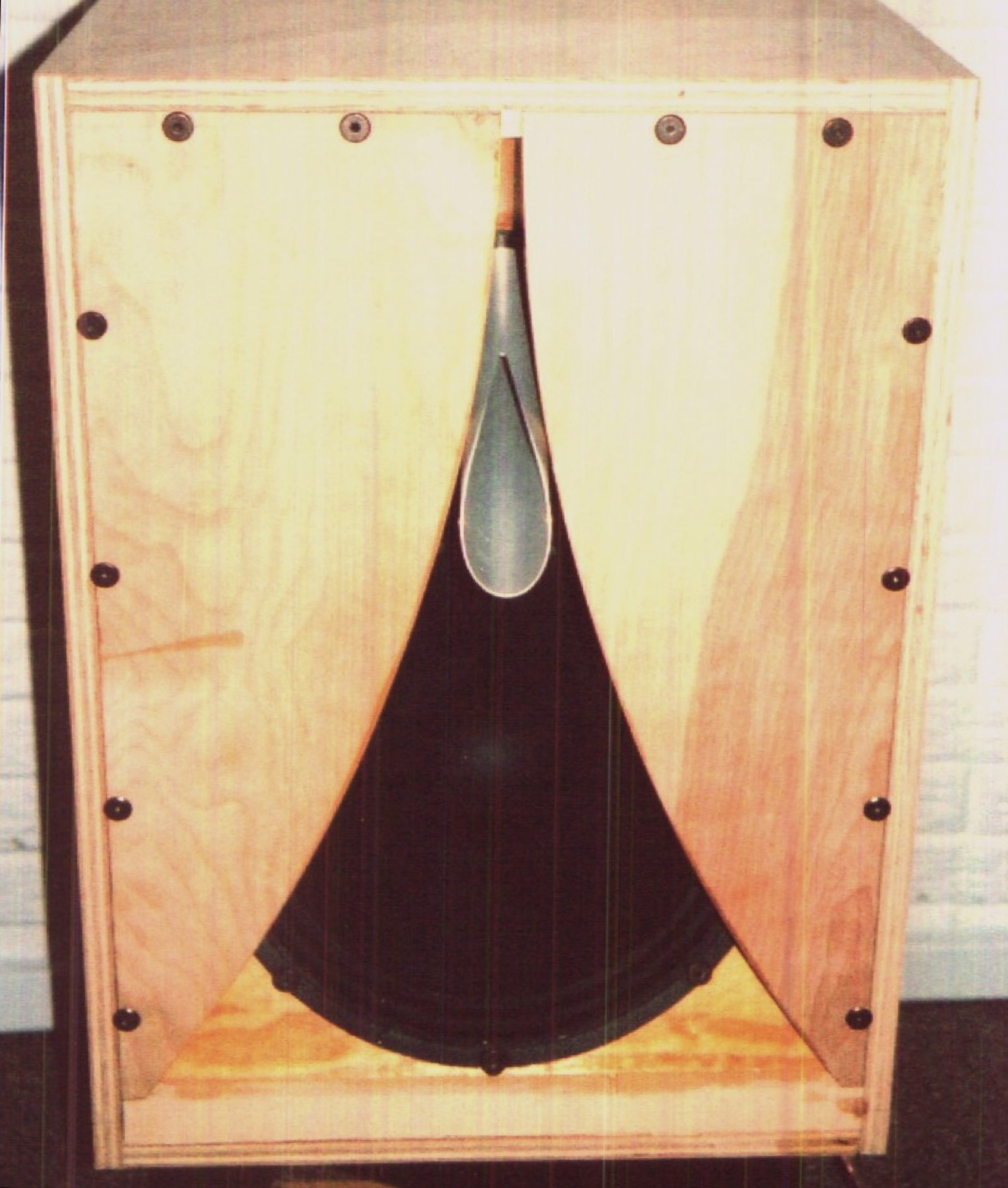

What would y'all think about using a KR5 Rocket, Post #17 in the link, inside the front chamber?
NASA consultant John Karlson, his little KR5 "Rocket" and Rise of the Klam projectors
Hi TB46
maybe use KR5"s general shape in a smaller packate with 6 degree slope walls viewed from the front and 12 degree slant walls viewed from the side ?
an alternative which I know has been explored by Carl Neuser, would be to use a K-tube whose cross section moves towards oval at its end.
See K's open end waveguide patent and also 3540544 below
https://patentimages.storage.googleapis.com/0b/3f/f3/ba462c85c48ff9/US3445852.pdf
https://patentimages.storage.googleapis.com/a2/33/52/7e84065907a786/US3540544.pdf

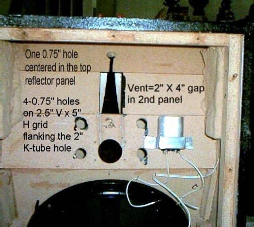

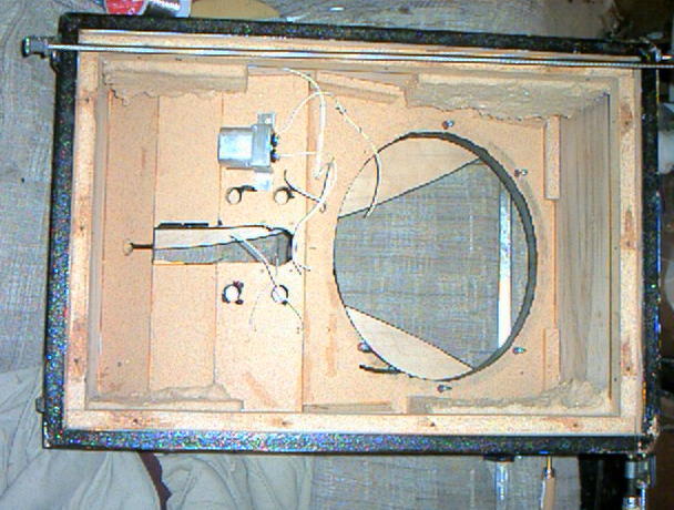

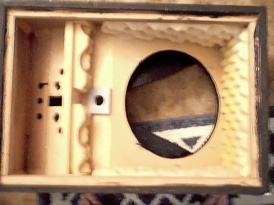

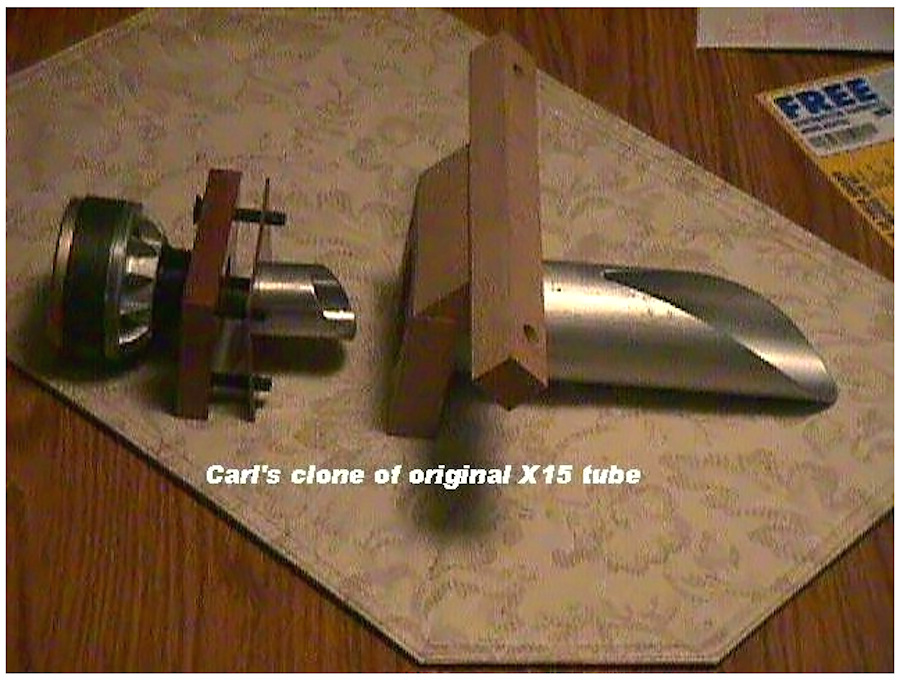

Two different K-tube seen in X15
my X15 were loaded with a 2"OD slotted pipe while those of Klipsch forum member "Johny Holiday" had what appeared to be about a 1.25" diameter slotted pipe whose slot had been adjusted (shortened with a small piece)
I'd imagine the smaller diameter tube would measure much smoother due to less of a transitional jump from a 1 inch compression driver's exit.
This does show Karlson was experimenting with the tweeter design as time went on.
That's Carl Neuser's early attempt at X15 size in two pictures. The one with one wing removed has a 9 inch long version of the 7.125" long by 2"OD K-tube. The picture with the greenish looking tube is an original 7.125" long X15 tube.
I bought the X15 cabinets sans tubes - Carl got the K-tubes and drivers. The seller took a jigsaw and removed the tubes rather than disassembling them properly - so I put the pieces back in the cabinets with epoxy putty.
Carl said a re-make of this X15 size with a fully curved laminated wood reflector was an improvement
BTW, a K-with 5.3" length slot plus enough extra length to go through a port panel, will fit a K8 or K12
and make an "X8" as shown here with one of Carl's K8 or an "X12" with the 2nd or 3rd K12 (not done to my knowledge
but could be very good for those who don't have a first rate coax or FR). That gray tube is one I made to give to Carl,
and based on Transylvania's "THE TUBE". "THE TUBE" had a somewhat smaller exit as its sidewalls were sloped 2 degrees IIRC ?
