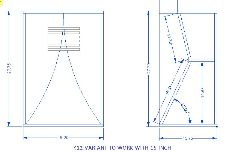

TB46's. sketch of X15 size built like a K12 might play smoother than Karlson's cabinet (?) A K-tube could be added once vents are put towards each side. Remember with ~99dB 15 inch woofers that X15 size will have about the same low end as K12, with a half space rolloff below 80-90Hz. so a subwoofer would help. I like the 1956 Karlson split shelf boards as those provide a good brace for the back and baffle/upper panel boards.

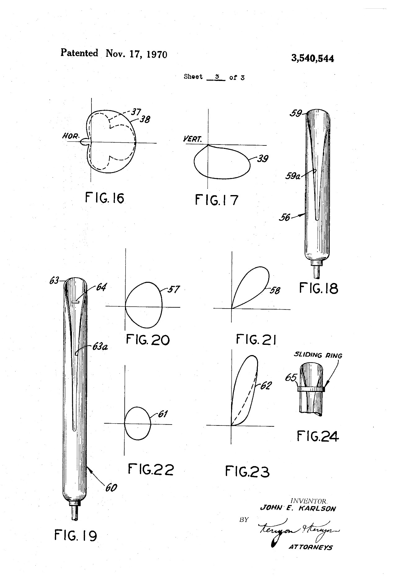

Karlson's patent US3540544 has illustrations for "K-tube" microphones. I'd think the tube resonance would have to be RQ-ed out for that to work (?)
When discussimg John Karlson's work for the 1964 NYC World's Fair, the late Martin Poppe ("The K-coupler") said John had some little Rocket type as Robert Moses intercom mics and that in a way, those were an abstract representation of the "Twin Tower" project.

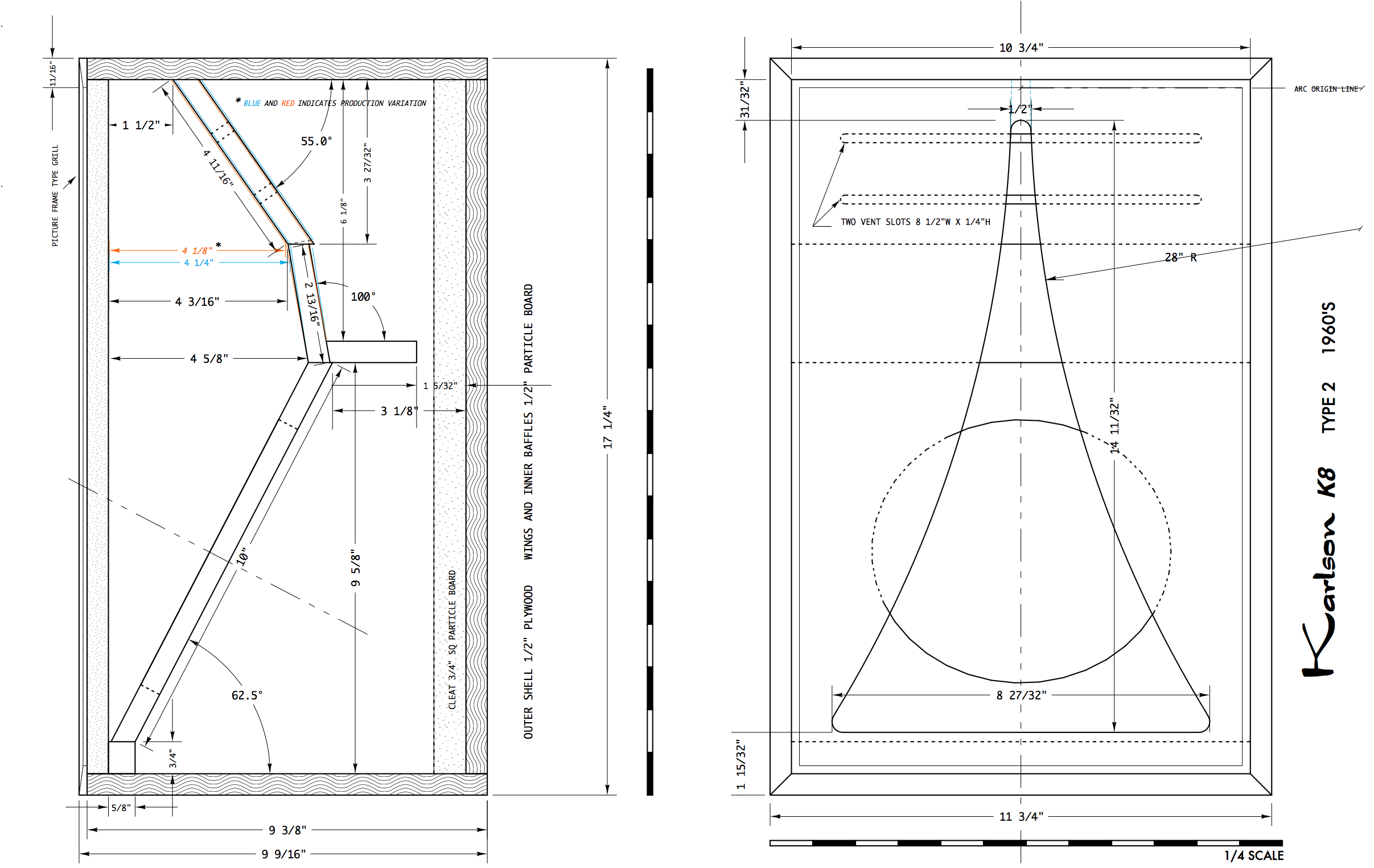

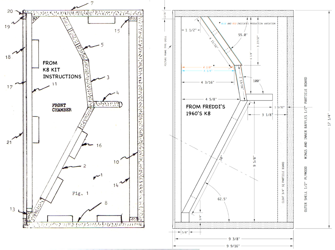

speaking of X15, since Karlson's 1960's K8 has a similar front chamber / aspect, I'd like for fun to have a "K10" based on that K8. Tuning might come in around the high 70's (?)

Karlson's later K8 kit was somewhat different vs my factory assembled K8.
Which do you think would play "smoothest" ? - they could perform somewhat different (???)
Also, going by ray tracing such as Karlson did, which one would do best on
getting bounced waves out through the aperture ?

Interesting, both have the port firing at an angle into the front chamber. I wonder how a tube from lower into upper rear chamber (as in Delsol) would affect performance?
Did John or Wayne ever take any chamber measurements to see how the front affected the rear chambers or just a trial and error of all three chambers coupled together. It's obviously a three chamber design that can't be fully analyzed as chambers in isolation.
I have a K8 stored in the garage that was scaled from the original K12 design. Come warm weather I think I will modify the rear shelf to separate the rear chambers with a tube projecting into the upper chamber. Then I can easily experiment with different tube lengths. I wonder what tube diameter I should use? I may have to use rectangular as I am restricted to whatever as built (?) clearance is.

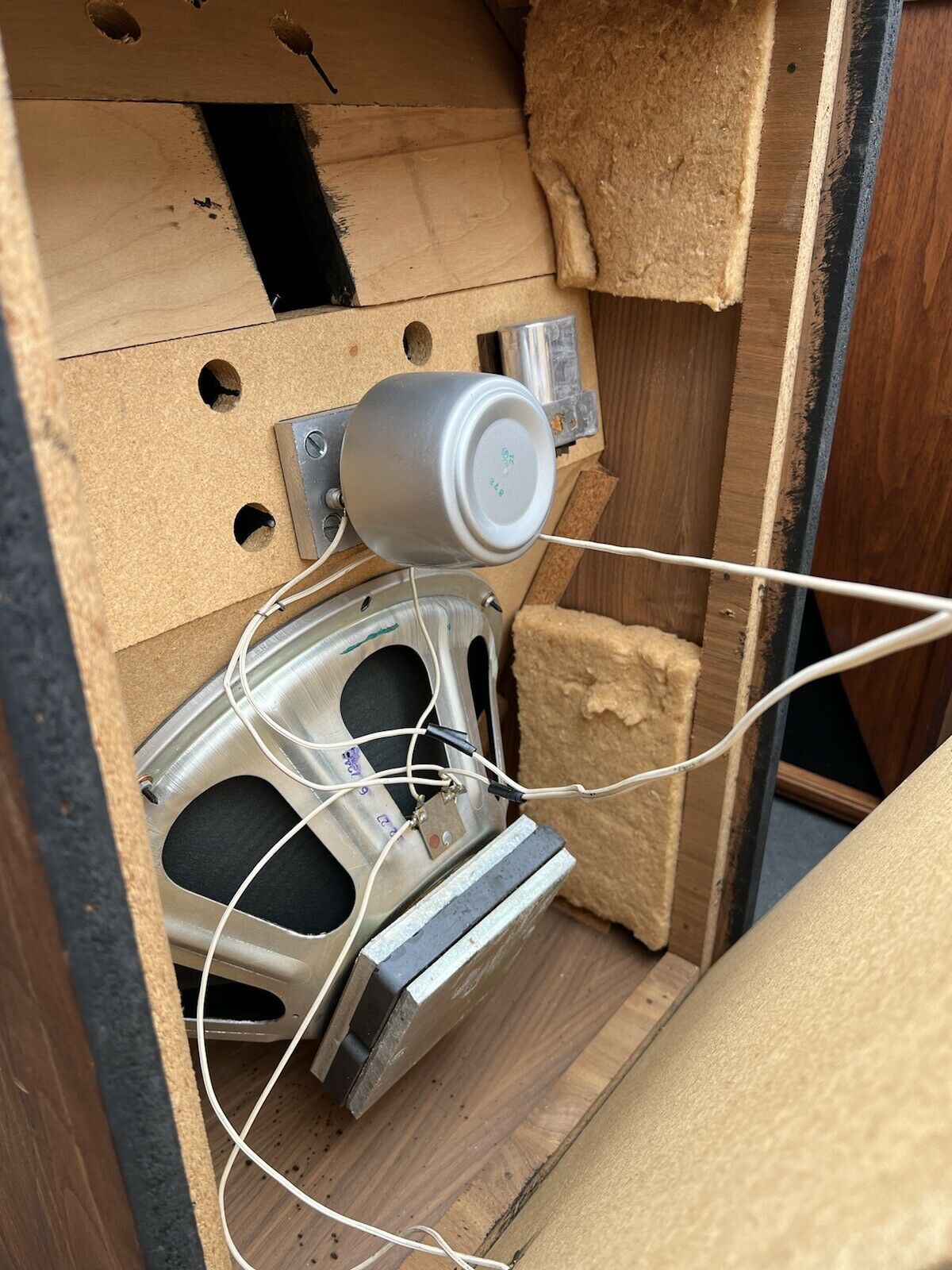

Karlson appeared to use just a cap (4uF IIRC) with my X15 K-tube's compression driver, but that could be brutal in some cases. 2nd or 3rd (and higher) order highpass would be safer as the little tubes have little to no gain on their low end compared to horn.

Poppe said John would listen for problems. Karlson's 1961 letter to Poppe indicates K8 was the precursor of the X15 front chamber profile.

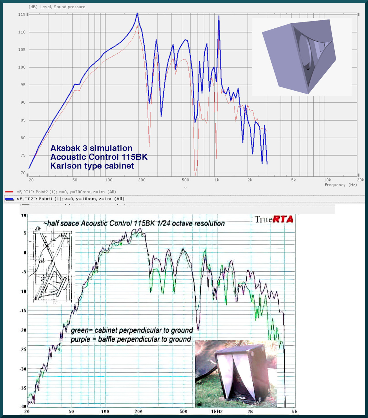

Akabak3, with an experienced user , being adjusted for real world speaker cabinet materials, should allow analysis of front chamber shape and aperture variations with a fixed rear chamber. (or two as many choked K have).
It took some international nudging from the US - to Czech Republic to Greece to get the little taste of what Akabak3 might do with the difficult Karlson arrangement.

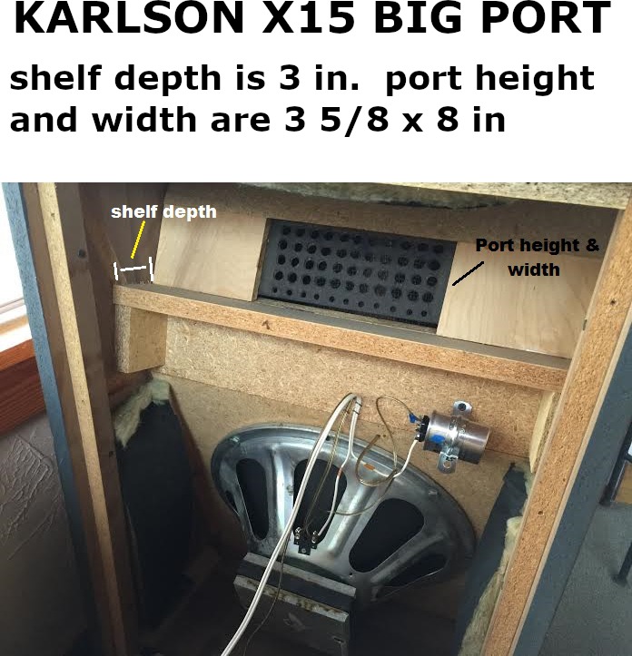

Karlson;s X15 system was introduced late 1965 - a time when stereosound via lp was getting to be the norm. At 28" x 19.25" x ~14" X15 was around 57% the bulk of K15 (K15 wasdeveloped in the summer of 1951) and as a consequence, had a LF rolloff about a half octave higher. X15's bulk was only 1 cubic foot more than K1 and could be an excellent choice. in a system with a subwoofer. X15 being a 2-way factory loaded system had Karlson's open end waveguide slotted-pipe tweeter and hat wored (and still works quite well.
One feature of all Karlson enclosures is "controlled ring time" with the intent of providing greater realism and enhancement of "weak transients"
There was a time in the early 1980's where at least four companies were producing an X15 size K-coupler.. Acoustic Control's 115BK measure very smooth even without any damping material and could be a substitute for midbass horn altough needs more
power input.
The earliest X15 used a wood mini-klam with 3 inch cone tweeter- sometime later tha was replaced with the slotted pipe. waveguide. It used a bass guitar CTS 15" woofer.
I think it could be built with a simple upper panel like a K12 and sound pretty good - but DIY member Suntiger likes to use curved reflectors.
