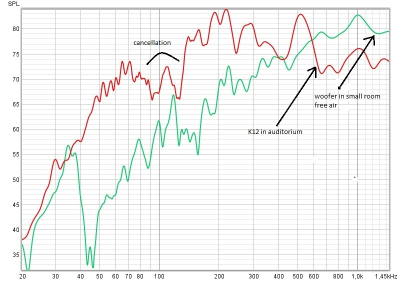

hello everyone, can you help me understand something?.

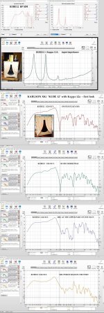

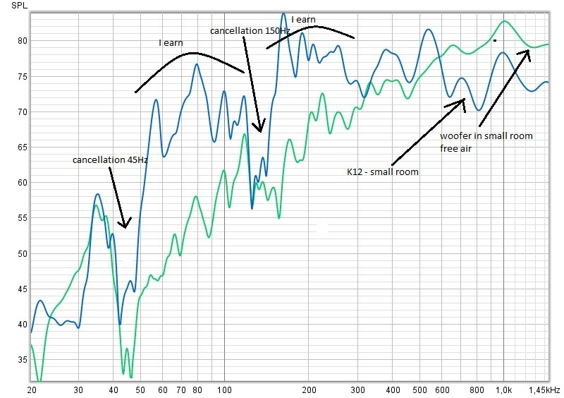

I made some measurements of a K12 prototype (woofer only).
for comparison I measured the 12" woofer in free air with no enclosure inside a small room and then I measured K12 , also in the same small room.
as you can see from the first graph there are 2 important cancellations, one at 45Hz and the other at 150Hz.
subsequently I made a measurement of K12 in a large 700-seat auditorium and the second graph came out.
as a result I deduced that the cancellation of 45Hz was due to the small room but the one around 150Hz remained, I can't figure out what caused the latter. perhaps from the posterior chamber or perhaps from the anterior chamber. I thought of applying a diode on wire R which goes from the sound card to the amplifier and then making two measurements, one for the direct radiation and another for the rear radiation which crosses the reflex ports and enters the front one. I'm afraid the speaker won't work well this way though.
Do you know any tricks to find out the cause of this problem?.

possibly - K12 depending on whether a tight lowpass gap is used needs 18mm plywood for the back panel. 12mm plywood in my Kube12 has some flex but no suckout. The inner vent and vent's position can make dips. What does your K12 look like? - got any pictures ?
my Kube 12 has dips- with one around 380Hz - it sounds really good with a cheap 2.1 amplifier and Pianolydia's "K3.5 / 3FE25 mini speakers

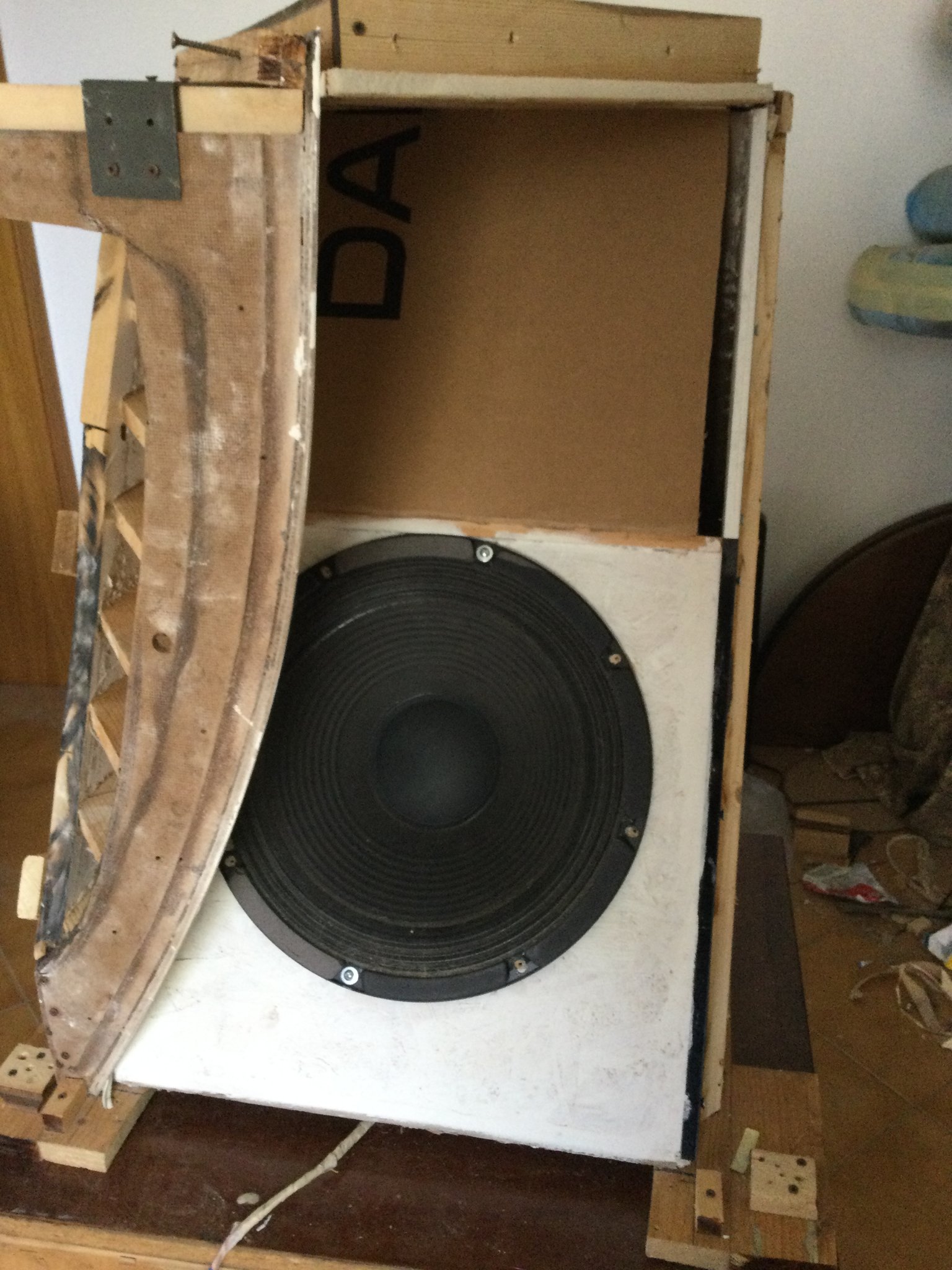

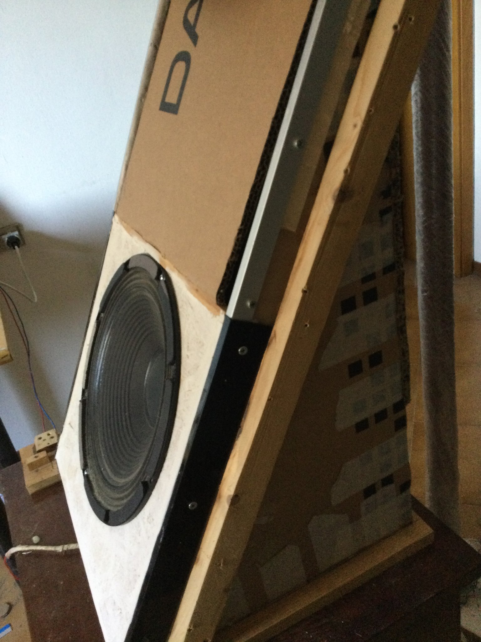

but certainly freddi.

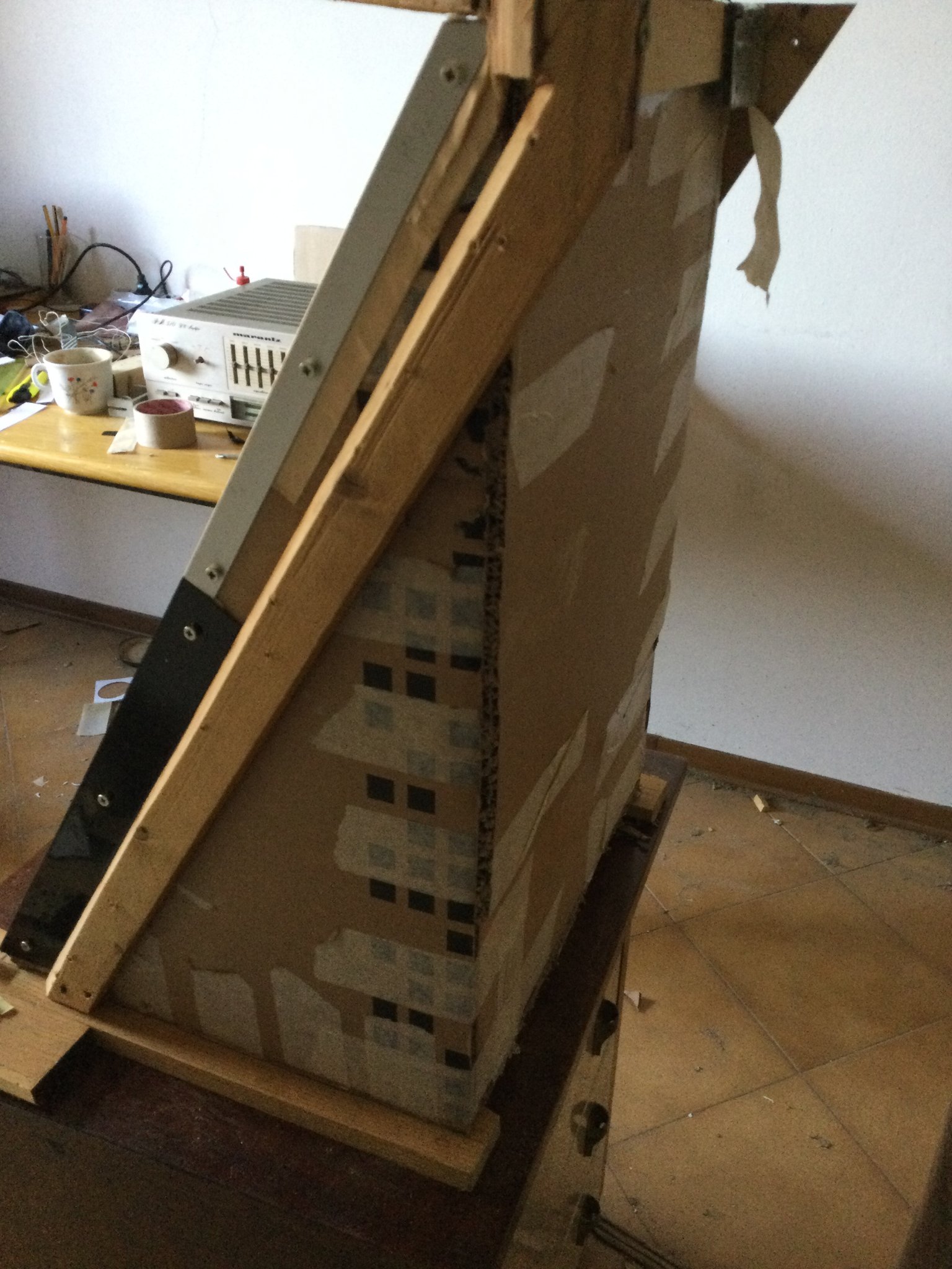

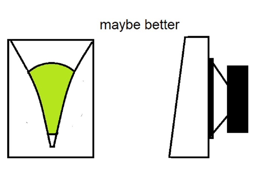

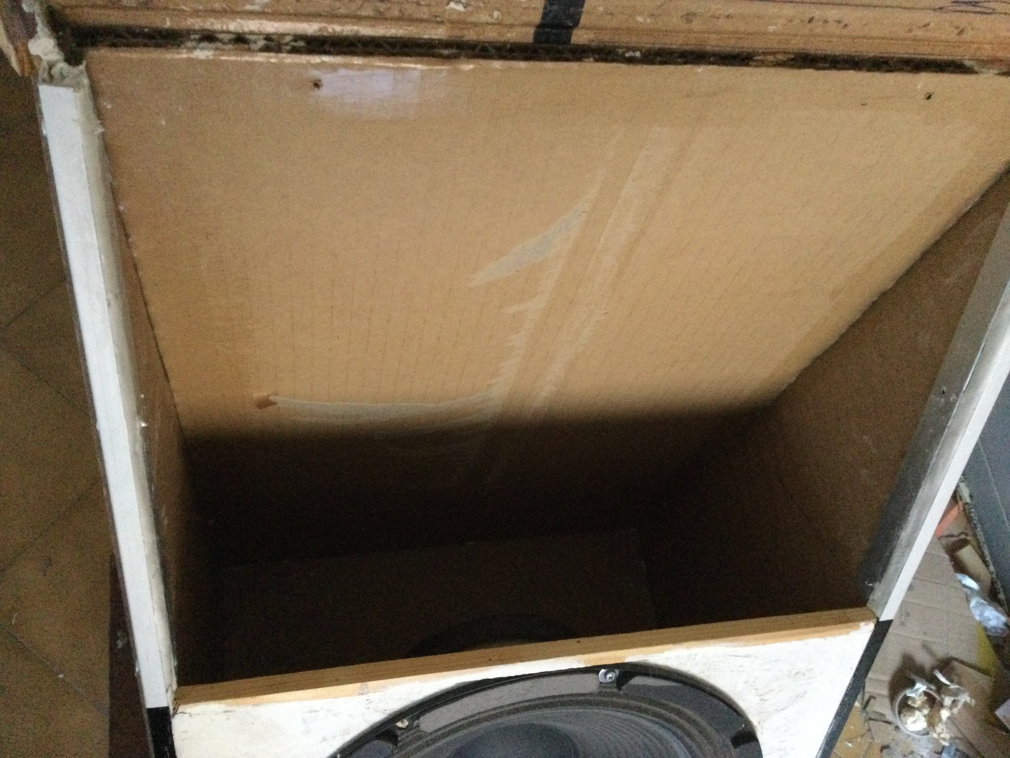

I tried to make it modular as much as possible in order to do many tests and experiment.
as you can see from img_1 , the rear chamber has a triangular shape and is made of 1cm thick corrugated cardboard , while the front chamber is made of wood .
the surface that houses the woofer is made up of 2 segments, one fixed in wood (below) and the other removable in cardboard (above).
however as you can see from the photo img_2 both segments lie on the same plane. it is not made like a classic K12 in which the upper half has a certain angle of inclination with respect to the panel below which houses the woofer.

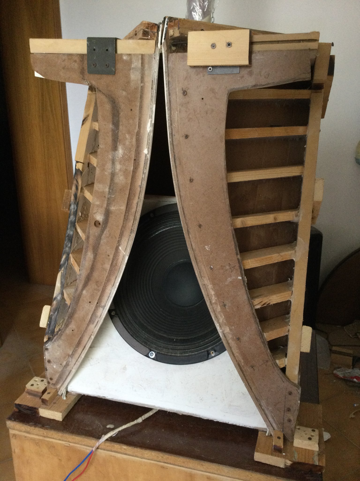

here there is no classic reinforcement shelf that divides the lower segment from the upper one (img_ 3 ), perhaps it is also for this reason that there is a hole in the graph around 150Hz .
reading on the official karlson site I read that the reflex ports work below 130Hz.
http://home.planet.nl/~ulfman/artic/kkoppler/kkopl_en.html (fig.2)
perhaps the hole occurs for this reason, but if it were so there should be no gain above this frequency, which is present and is shown in the graphs that I have already posted (but my piece of furniture is 60cm tall so maybe it's not even this is the reason, who knows).
I've used REW to see what my room's modes are but I've noticed that at 150Hz there are no particularly powerful cancels.
these are the measurements of my room: length 4.45m width 3m height 2.7m.
when I listen to this K12, on the first floor, even at low volume and at a certain frequency, the floor vibrates.

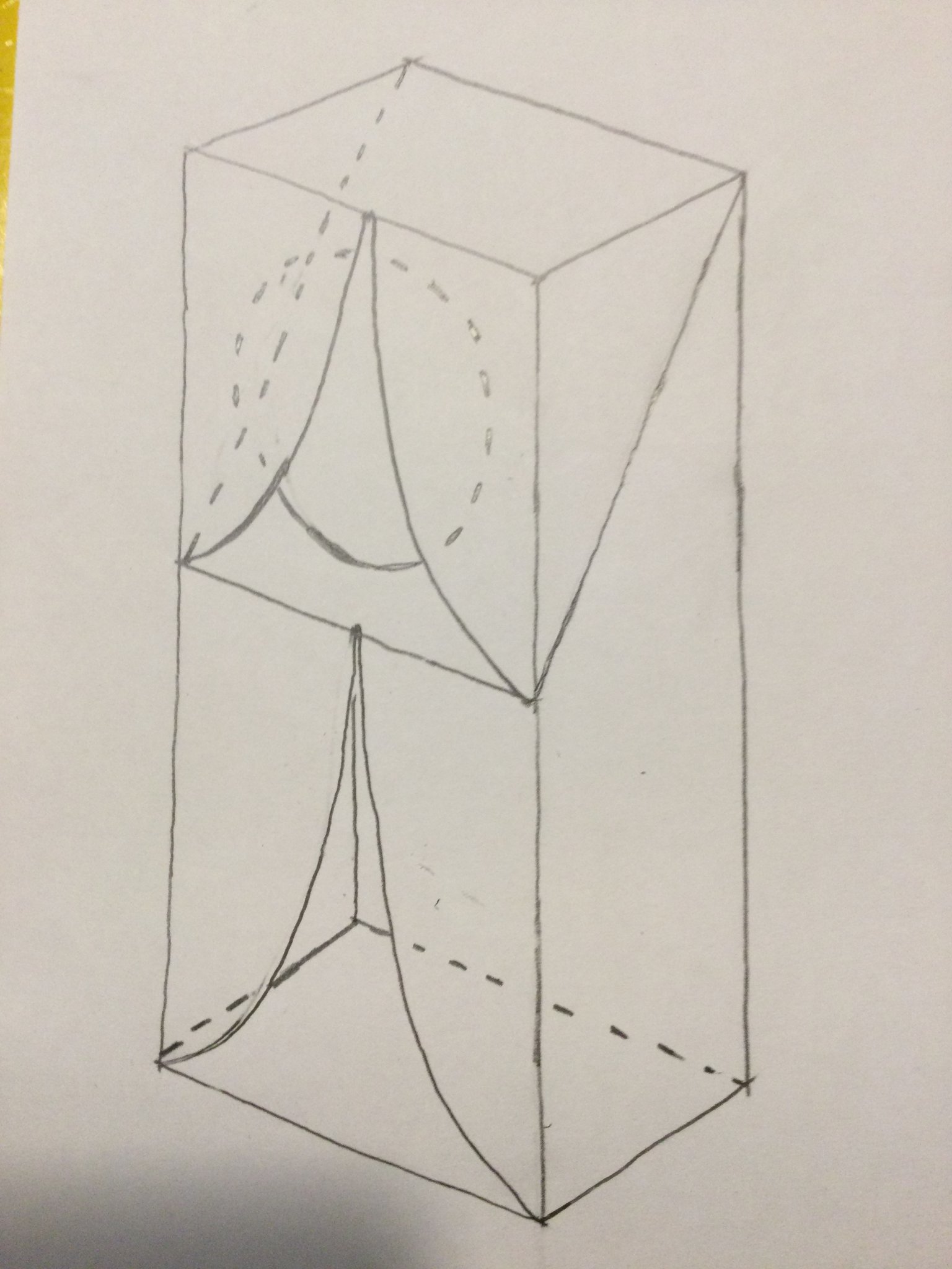

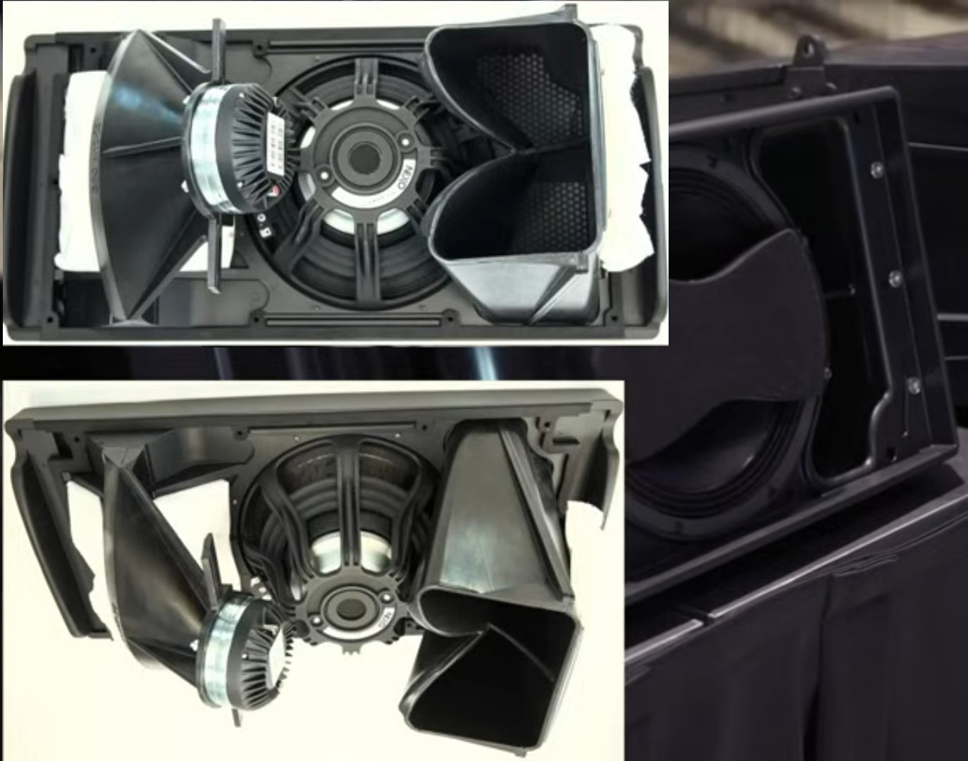

this is the right design. the first one had an error.
the anterior chamber is the classic one K instead the rear one is larger but above all longer. can it be considered a tube tuned to a quarter wave according to you?.
bye thank you .
That duct just looks like sensible non-parallel walls and a way to "tap" at one location and terminate at another. The lump in the corner reminds me of Roy's mumps in his horns. I don't know what we can make of it (bec so much is going on), but I liked the link and I don't know how you keep finding this stuff, Fred! 🙂

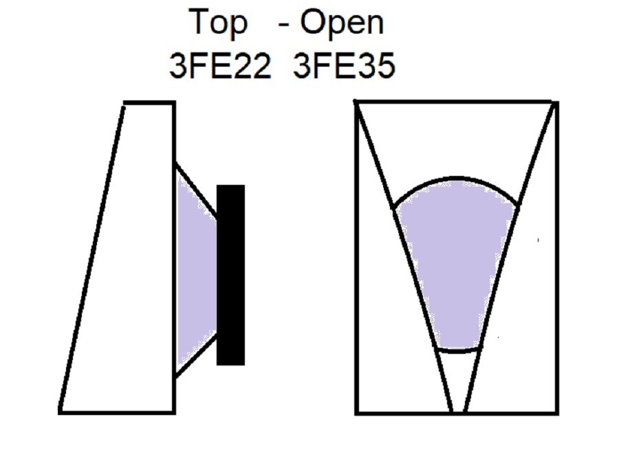

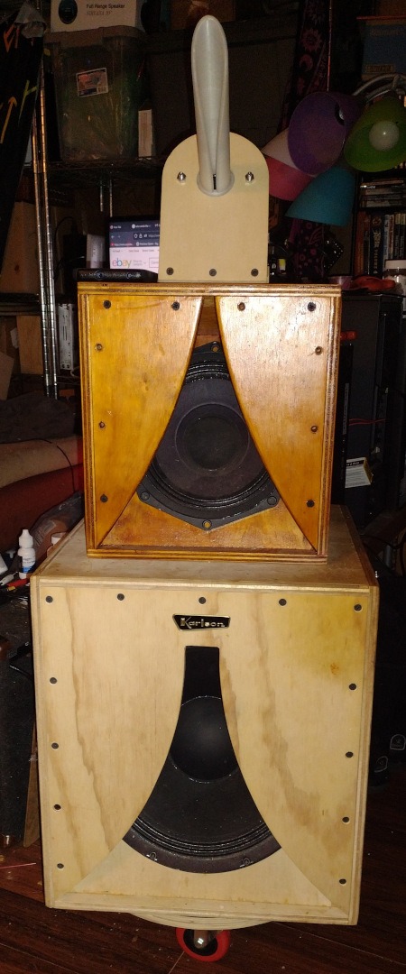

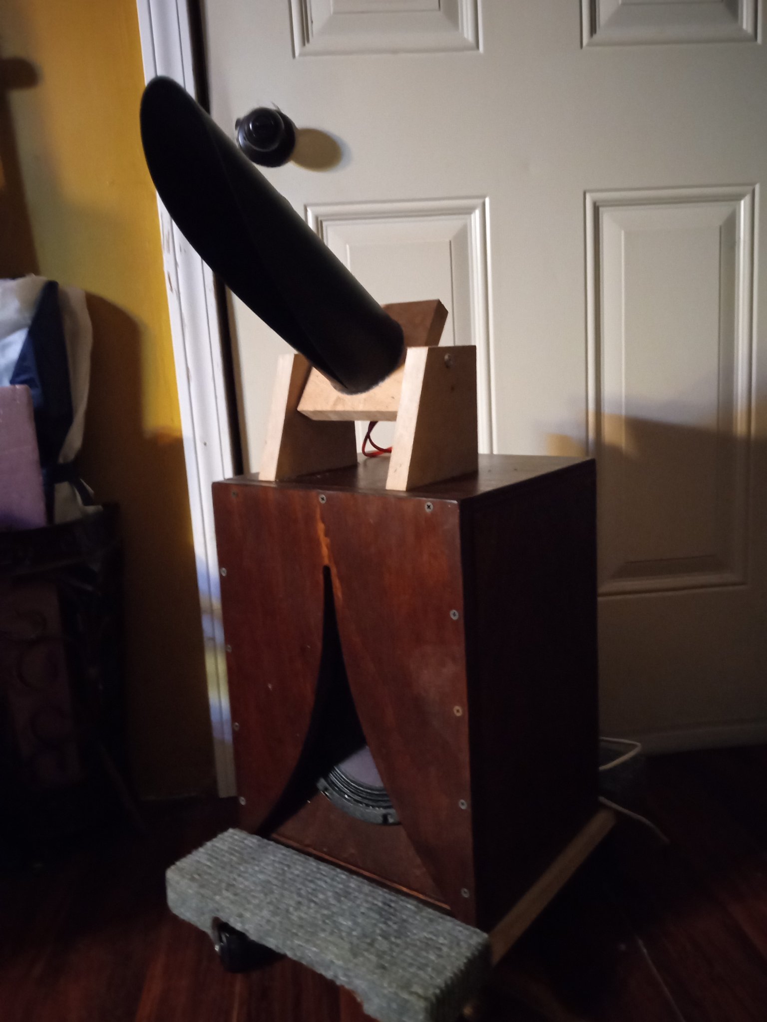

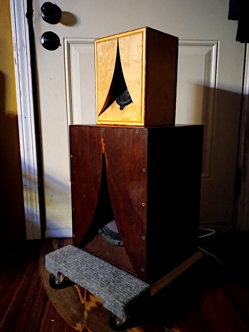

I'd like a 3D printed K for 3FE35 - as small as possible for a tweeter module.
Here's some K-tweeter setups I can do showing two on top of an XKi 8 with Eminence Beta 8A: The big tube is by Suntiger and driven by a 3FE35 as is the K3.5.
The 3-way is Eminence Kappa12a - B&C PL21 and a Transylvania Power Company "The Tube"

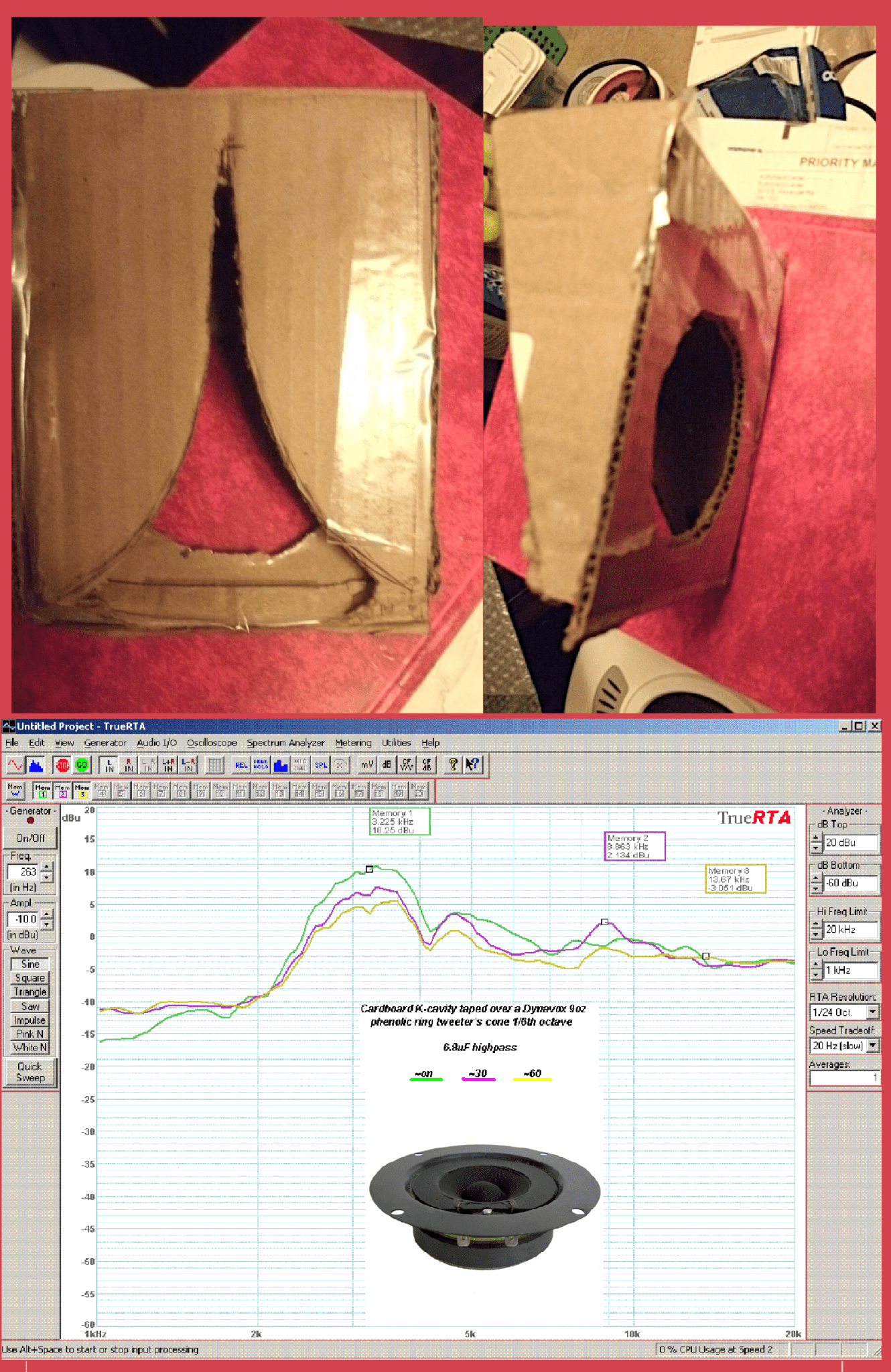

I'm pretty well stuck w/o tools - maybe someone might try K-cone tweeter as so.
I ran a Lavoce 3" in a cardboard lens with
some "shading" of the cone by the aperture - no
measurements and probably not 120 degree horizontal dispersion, but was very "holographic".
6mm plywood might be good then experiment with cardboard or foamcore til meaurements or/and subjective results are good. You need a rising on-axis response driver imo.
A similar cardboard lens and Dynavox copy of the old CTS "phenolic ring tweeter" gave 120 degree dispersion.

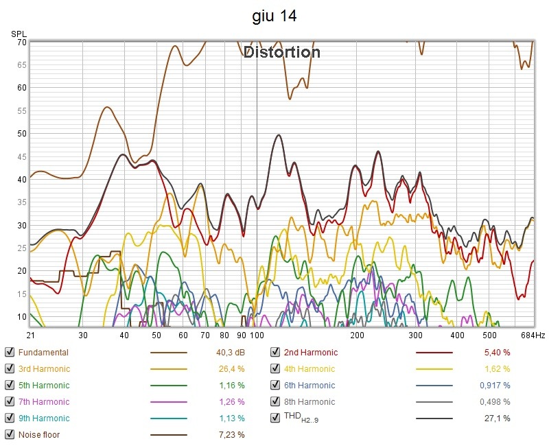

HI .

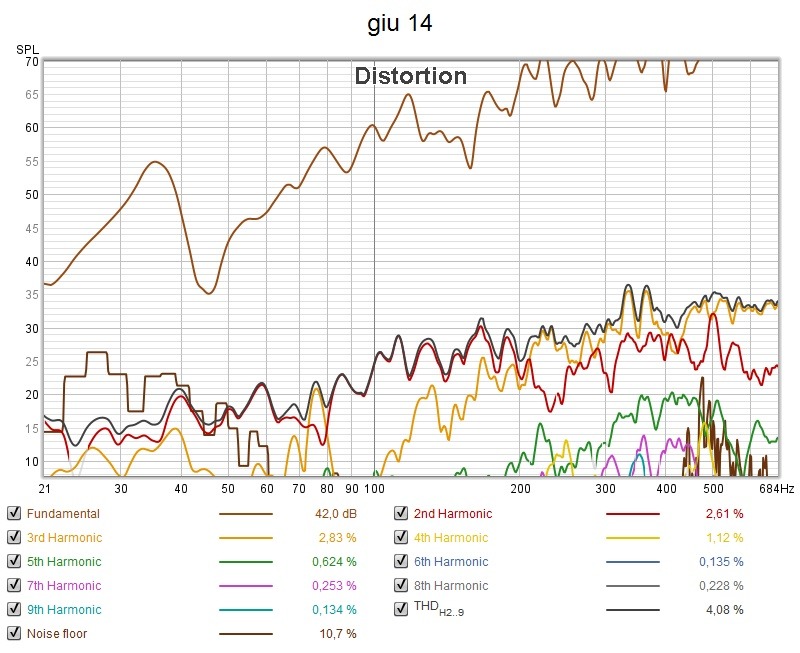

I expected that the driver inserted in my Karlson K12 cabinet would reduce harmonic distortion but what I see in the graphs is the opposite.
What do you think I did wrong?

One thing you need to do is high pass the Karlson at 65hz to avoid overexcursion of the driver below the point that the box begins to unload. I have a Karlson K15 and when I tried to run the box without any high pass at 60 hz, the sound turned to mush. That might not happen if the driver has high x-max, but I use EV 15L drivers which only have 3 mm xmax, so prone to distorting when trying to reproduce lower frequencies. I use a subwoofer below the Karson.
