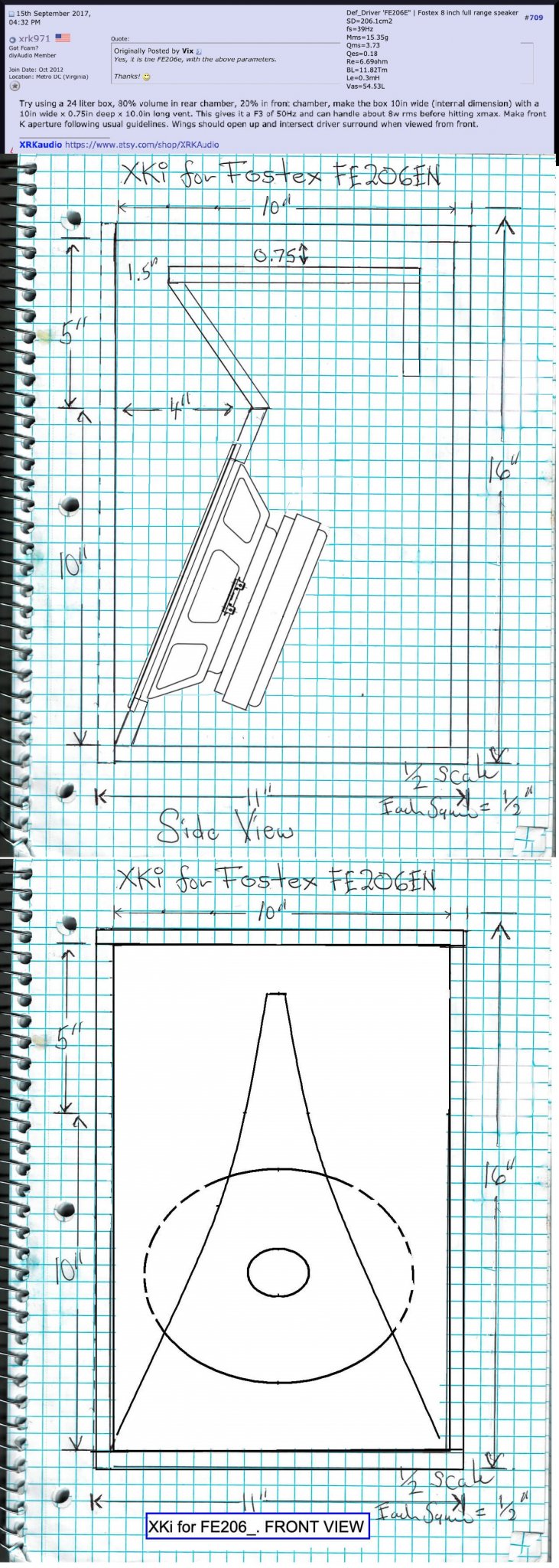

- much appreciated - - do you think cardboard would suffice for the baffle? I bet there's cheap drivers which would work work such as some from Electro Maven's -bay store.Freddi
I have an intuitive vision of a small Karlson slotted baffle in a U frame as an open baffle sitting on the K-15. That way you get the frequency balancing and dispersion benefits without the added cabinet resonance. I would try just setting the driver back an inch or two and not slant it back.
I just kind of see these designs and then build prototypes. Remarkably they usually work, tweaking notwithstanding.
Cardboard would be fine to run tests at least. Maybe glue up a couple of layers. I was thinking that a U frame could have an adjustable K-tube mounted across the top.
yeah - a swiveling K-tube would be good. Hey Suntiger - if you have time give me a quote to make the following little K-type cabinet.
Ideally -I'd like 1/2" BB from Menard's but Home Deot plywood would do. I'm guessing the shelf vent spec-ed by XRK971 as 10" in length could be cut 20%. IT would be good to have a removable back for real tuning via frequency response and Z. Also someone might investigate whether a K-slot shelf vent at the top of a K can smooth response (Nexo's patent).
(I have a table saw at my house but due to health and logistic factors - can't get to use it anymore.)
Does the front cavity shape look ok to you? 206__ make good K-drivers - perhaps a blh-hybird would be interesting for someone. I'm happy with small speakers and a sub.

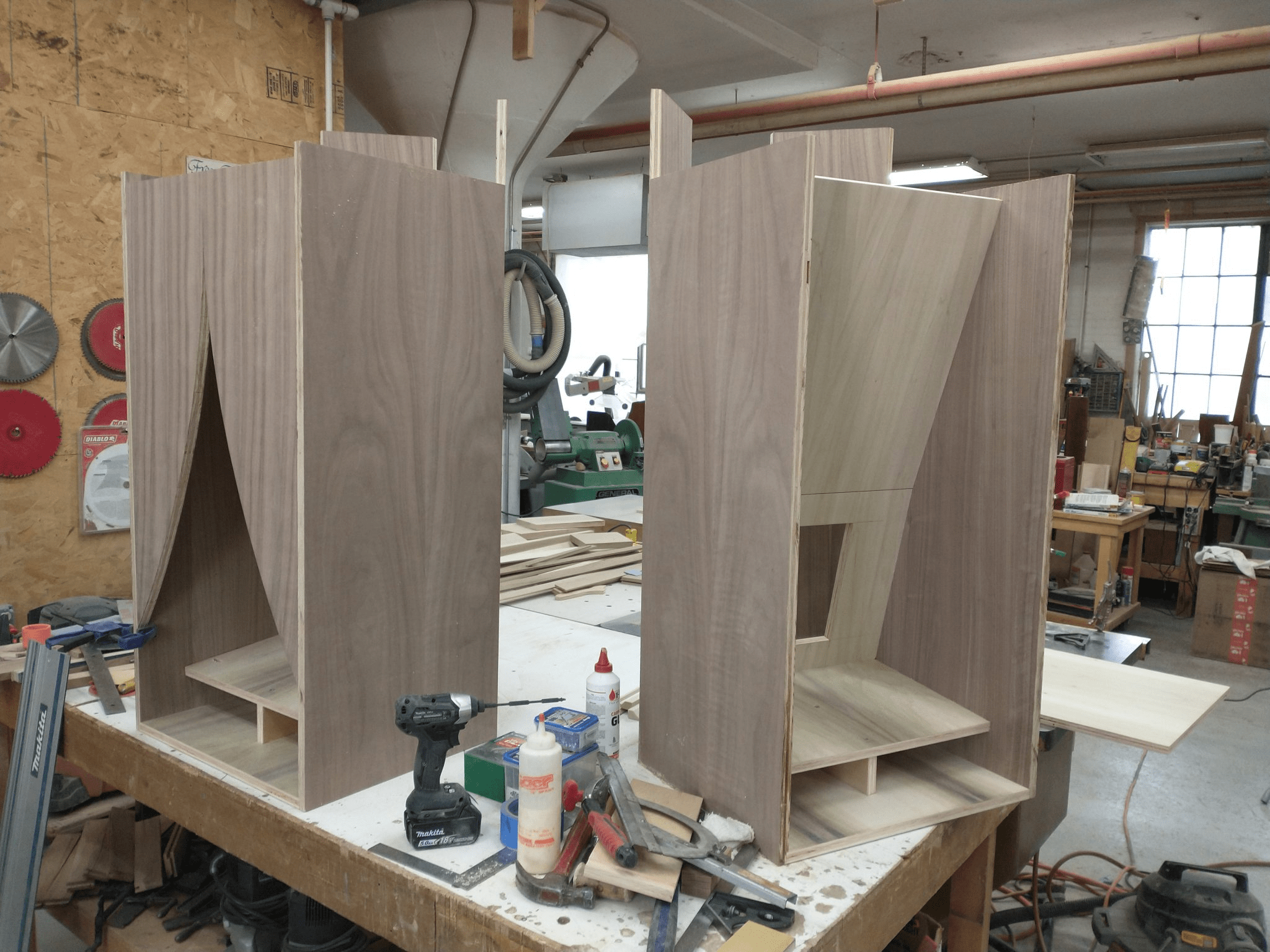

I'd be happy to make them for you, I'm assuming you want a pair. 1/2" Baltic birch seems good. Do you have the 206_? I will figure time and materials. The design looks pretty solid.
I have just one 206 - pair of 1772 but like 206 better for Karlson. Aperture upper gap, etc. can contribute to how a K's sound-field is heard - but most of the time does not show in measurements.

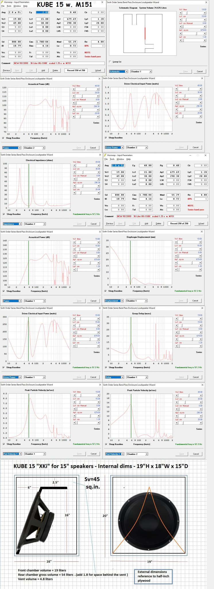

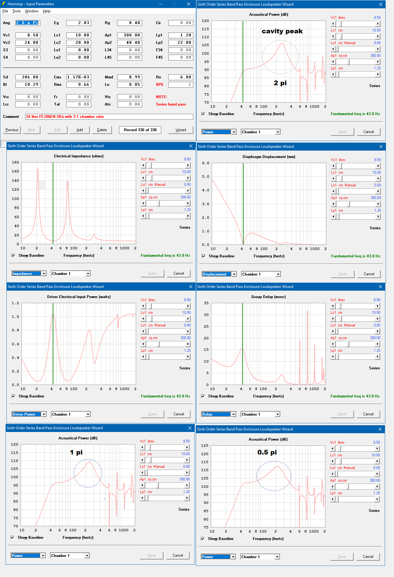

one problem with sim - how to estimate how strong the cavity peak might be? Does a slot vent at the top of a Karlson type mitigate some of the peak? I know a cavity placed directly above that vent "can" and also adds to the effective front chamber volume.

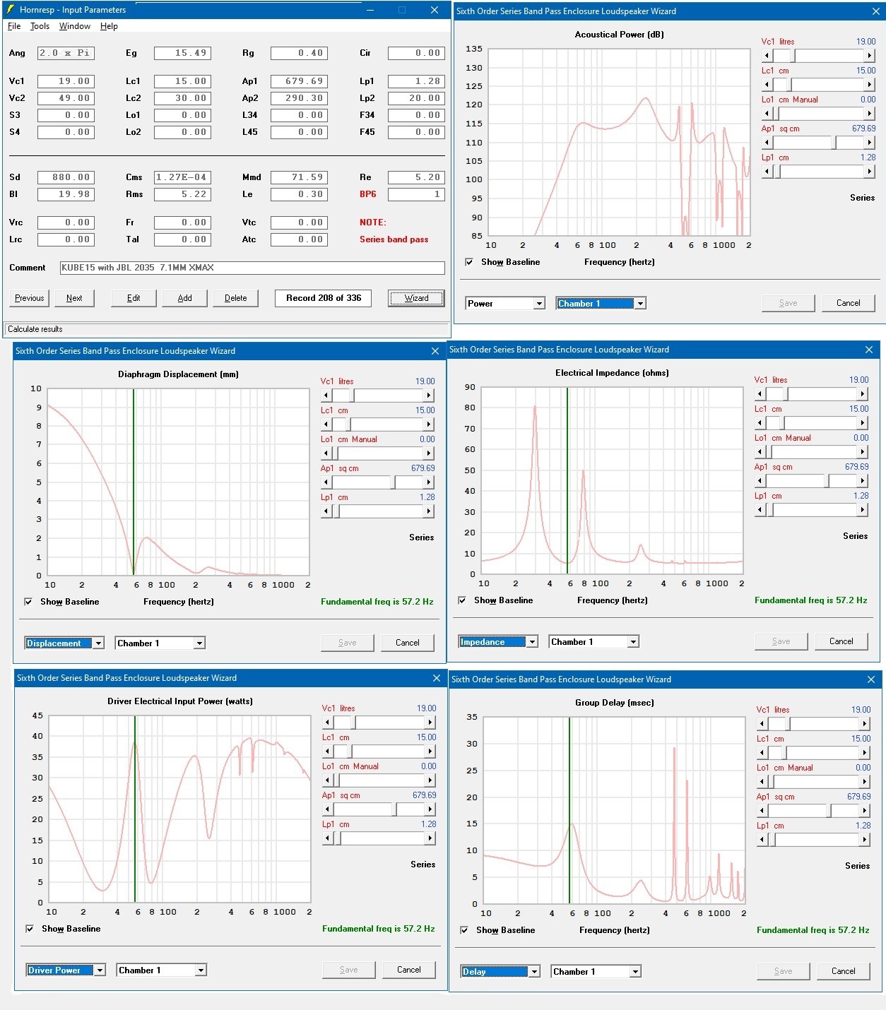

Look at this simplified bandpass sim of the proposed FE206EN XKi

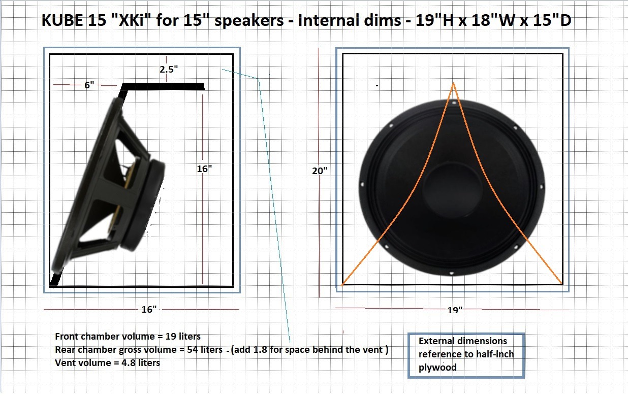

FWIW a somewhat cubical 15" K-type might be fun for a midbass module - or bass guitar box. The aperture and back panels 3/4" plywood, all other panels 1/2" plywood.
20 inch height would be good. I don't know if the height could be reduced enough to use Menard's Baltic birch 1/2" or not. (maybe)

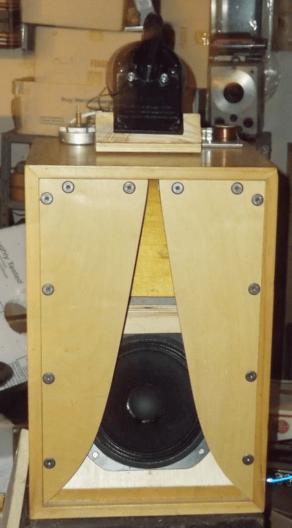

another question for Suntiger - is the rectangular opening on your K15- Jensen Imperial hybrid for ease of access to the rear of the speaker?
Might one employ your BLH - K hybrid successfully in smaller enclosures? - Moray James used 1/4 wave rear tunnels with Fostex and other small fullrange speakers. (I have only used the bandpass arrangement.)
How does the angled baffle merge with the horn below ? Is the front chamber about the same "volume" as that of K15?

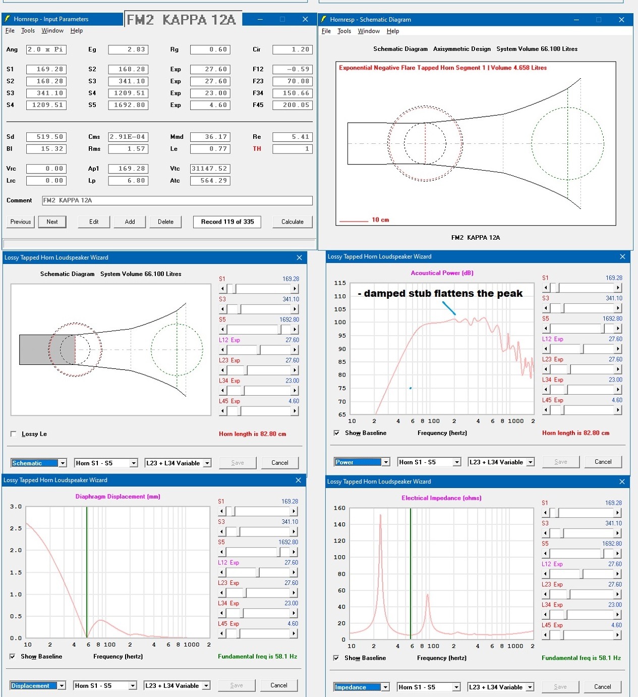

Particularly with the smaller (K-12) enclosure I have had the best results with loosely stuffing the rear cavity and using five 1/8" horizontal slots as vents above the woofer. I had no shelf.Hi Suntiger

Yes, the opening is for access. The pictures show the enclosure without the baffle and vertical lower front plate. They enclose the front of the compression chamber, see video. The design might respond in a smaller version but I haven't tried it. A good full range with extended low end would certainly help.another question for Suntiger - is the rectangular opening on your K15- Jensen Imperial hybrid for ease of access to the rear of the speaker?

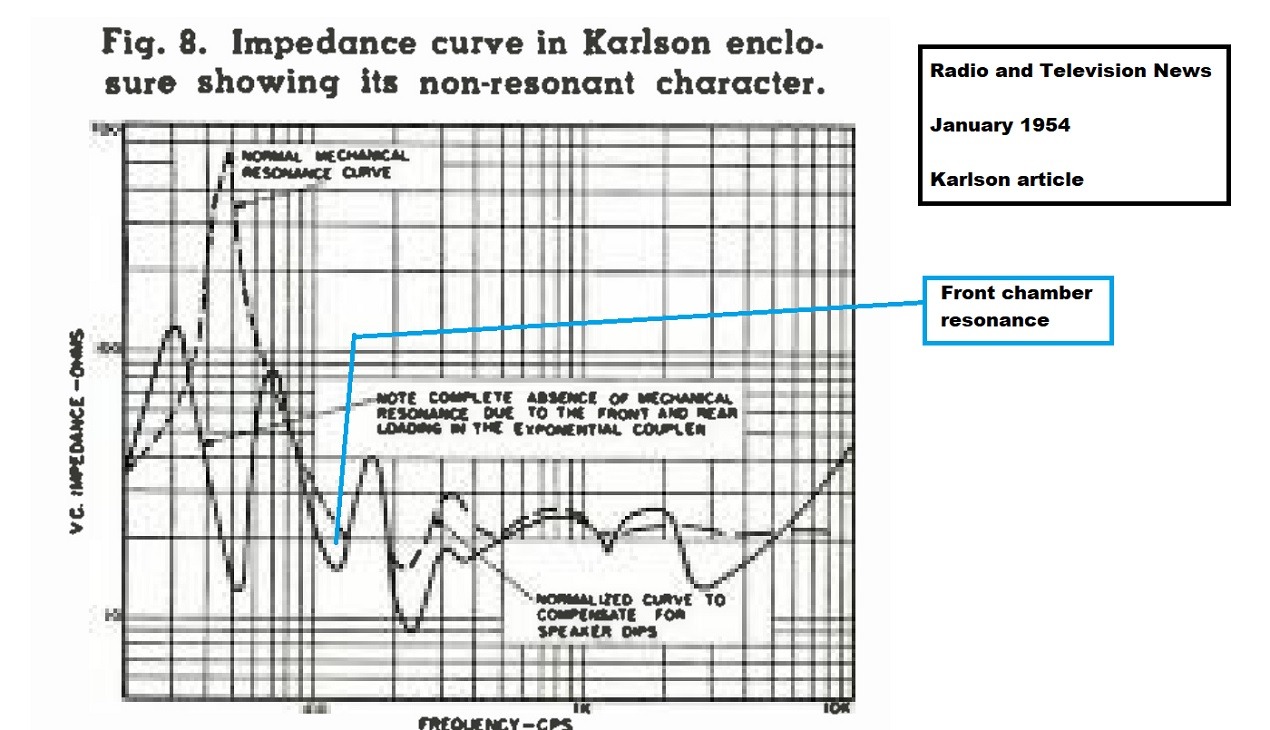

would you have an impedance plot of your K15-Imperial cabinet? I think K15's front chamber tunes ~110-120Hz.. (? see attached )
