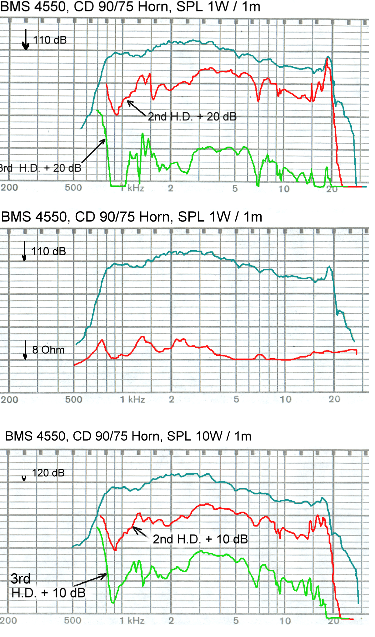

one of my tubes in a bedroom - not the best highpass filter - the other horn/driver was a Speakerlab wide-angle version of an EV T35 - there's no offset in the graph so that K-tube was ~10dB louder
input impedance of Transylvania Power's "The Tube" with a DE250 - the other Z is a homemade 1"ID pvc K-tube 5.3" long with a 2.5" extension. Both IG and myself have seen that little extension create a narrow notch
IG's tube with 3 different drivers - not sure of the perspective - looks like he may have had the tube tilted 30 degrees from horizontal
Blue = BMS 4550 - Green = P-Audio BMD440 - Red = Selenium D220Ti

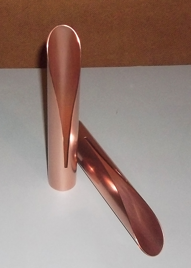

Its loud enough to keep up with a JBL 4638 2-15" 2035H reflex and 20dB louder than 2.5" Peerless type cone tweeter - I had a graph - but images$$t has lost maybe 20% of my uploads = not good for a paid service - the tubes sound very natural - open - smooth - require no EQ in the highpass filter - their high vertical pattern makes them a natural to mesh with Karlson midbass -couplers
one of my 4638 back behind these two K's - - - IG made the beautiful brass K-tube perched upon a K10 size couipler loaded w. Delta 10A

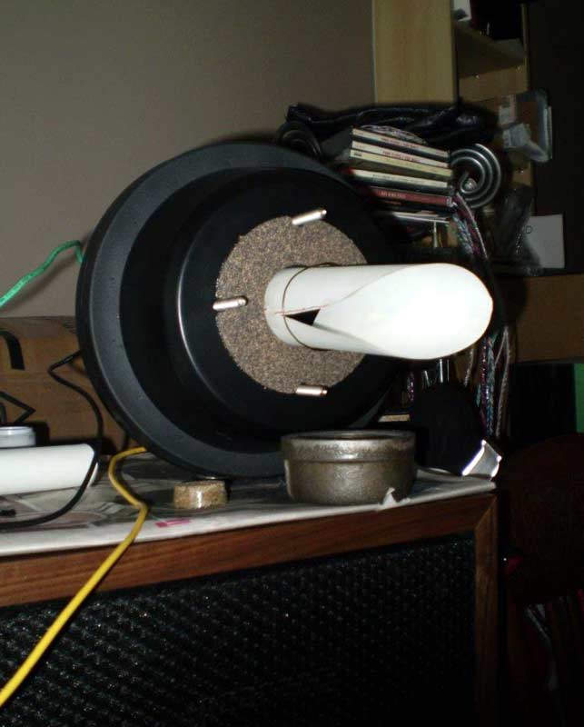

Sorry for the novice question, but what's the best way to cut the exponential shape? I'm just trying with paper for now.
I have the Pyle PDS521, and so far I'm not sure what I'm meant to be listening for There's an increase in sensitivity around 2kHz, but other than that I don't hear much difference compared to the driver when it's unloaded.
The shape I cut may have been a damaging factor there.
Ok. Also from what I've been reading, I need to make the diameter of the tube smaller, as it's 1.375 inches at the moment (I just wrapped the paper around the compression driver's thread).
I also cut the shape into the tube by flattening it, and then cutting the curve with scissors. Is that the correct way to do it?
How is it done with a PVC pipe? I have a bandsaw that I could cut the profile, but I've seen that people use Dremel tools to do the same thing. I suppose what I'm trying to understand is how the exponential aperture 'maps' onto the face of a pipe.

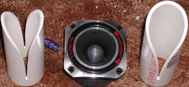

Thanks walters. How did you map the exponential curve onto the pipe? Is the curve just printed out on a piece of paper and then wrapped around it, or while the pipe is being cut, does the cutter follow the exponential path? I'd imaging the different approaches give a slightly different aperture shape.
I do have that paper stencil somewhere, I did it by eye. but it is packed away and I cant find it.
ig on this forum has a couple originals from Transylvania co. I think the stencil was by snkby. I do not know what happened to the fullrange driver forum. it probably went the way of karlson loudspeaker discussion. im sure some members will be here soon to help.

I made a printable K-Tube template for UK 28mm OD pipe (common for UK/EU copper and polymer plumbing pipe). Thought it might be useful for some forum members so I've attached the PDF below.
I'm part-way through a 3-way TL enclosure build which has them piercing the front baffle. I like the sound, but further work is needed on the crossover. Please note, the stub is shorter in the pictured tubes than the template as they're being mounted in a rebated bezel.
k-tube ID...
K-Tube ID should be identical to the exit ID of your driver or else you are going to get all manner of reflections. This is by the way the same truth for horns though it is often ignored by companies who well know better. I prefer the double cutaway tube I position it at seated ear height parallel to the floor solid sections of the tube in the horizontal plain (facing to the left and to the right). I prefer my K-tubes to any of my horns.
