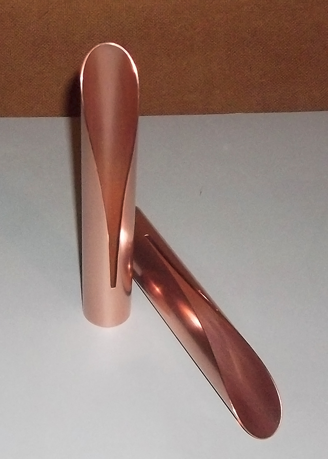

an "X10" might be a fun project with internal tube - certainly one on top will work. Some Karlsonator could accommodate an internal tube and would require a bolt-on driver attached "in" the stub. That copper tube by Halon looks beautiful - polish and clear coat.

Carl Neuser (big time K-experimenter) has used maple veneer layers to make K-tubes.
one of Carl's K- testbox
