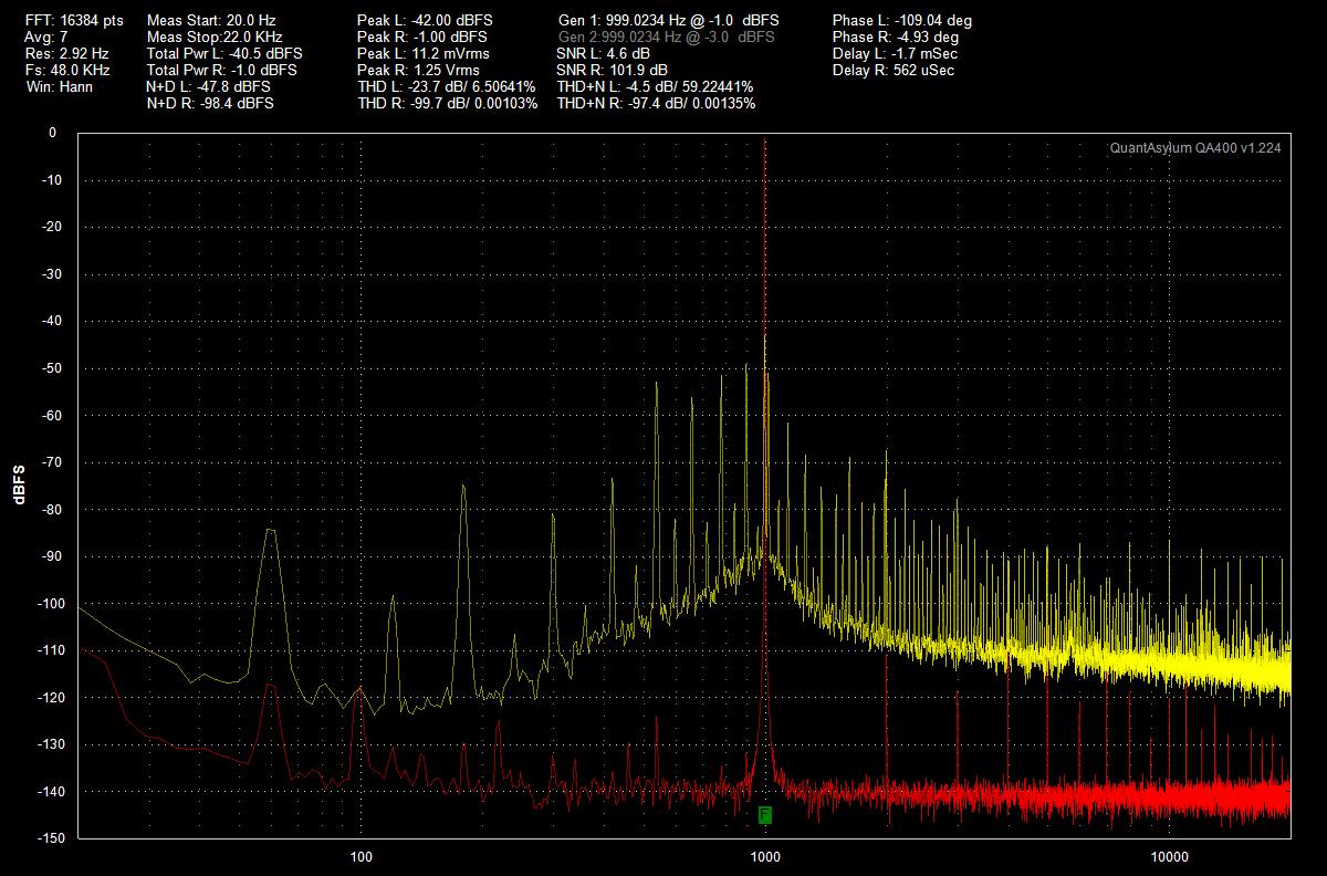

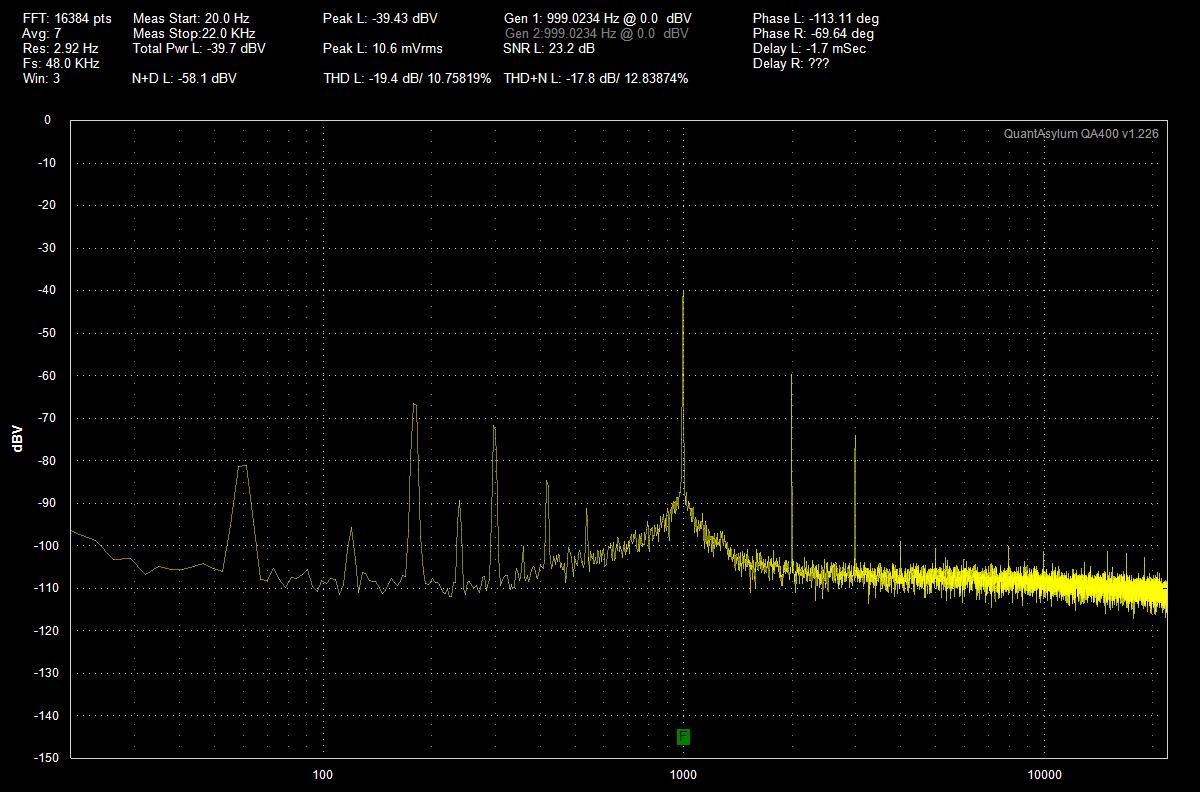

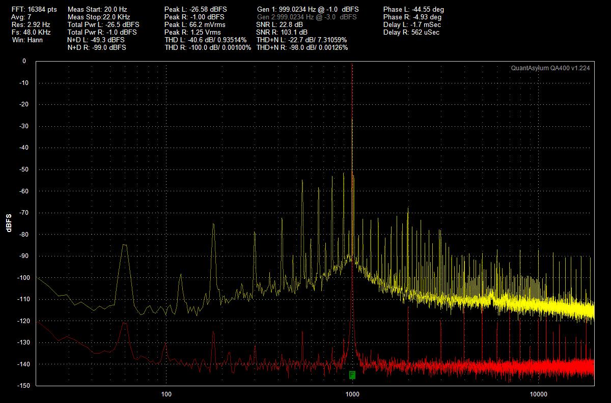

I ran a check on the 333a tonight with the QA400 oscillator connected to it. I attached the picture of the residual output to the QA400 from the 333a. The left channel is of course the residual and the right channel is showing the QA400 in loopback.
Nasty yes?
Nasty yes?
By any chance, do most of those spectral lines fall at odd multiples of the power line frequency?
Dale
Dale
Dale
Dale,
Just a quick glance at it looks like yes they do fall on the odd power line multiples.
I ran through the wein bridge balance procedure again which brought the fundamental down a good bit now after tuning. Picture attached.

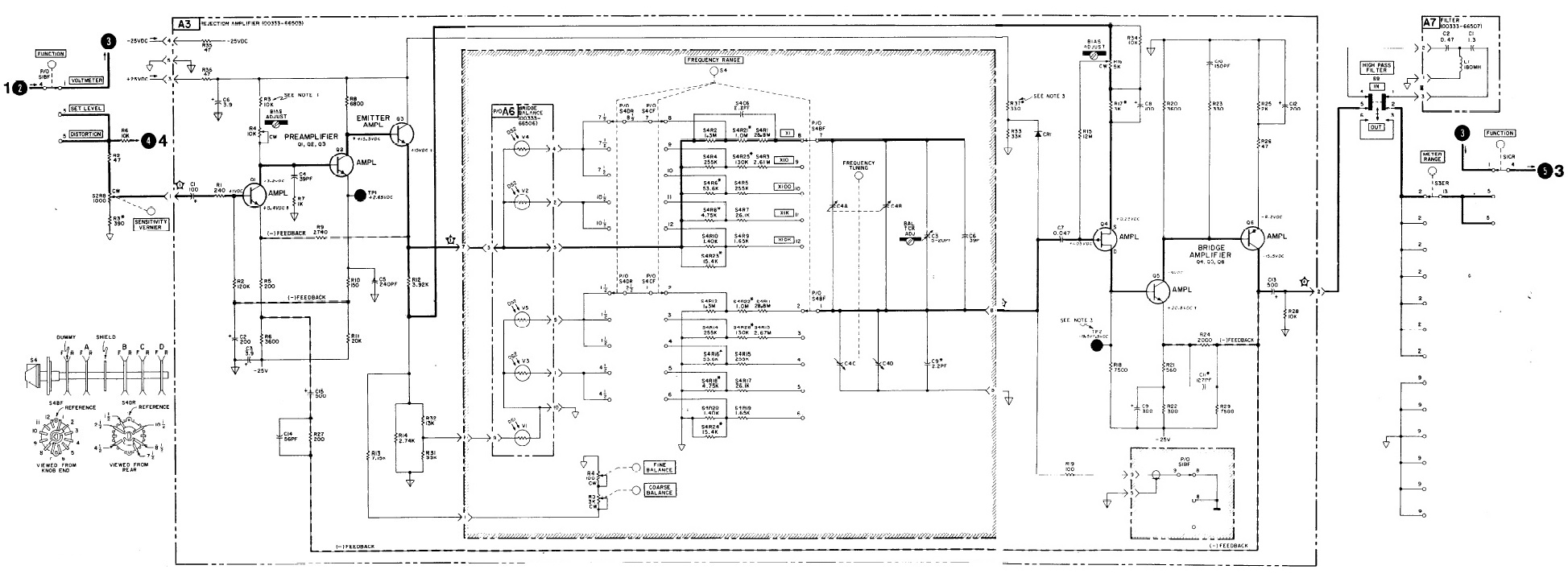

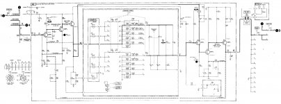

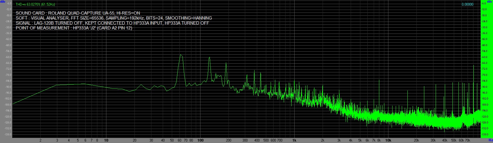

I made some mesurements with my HP333A. From what I can see, this unit is untouch, all parts are original.
The residual signal that I measured is from the point identified as 'J2'.
Refer to : HP333A DIAGRAM.pdf.

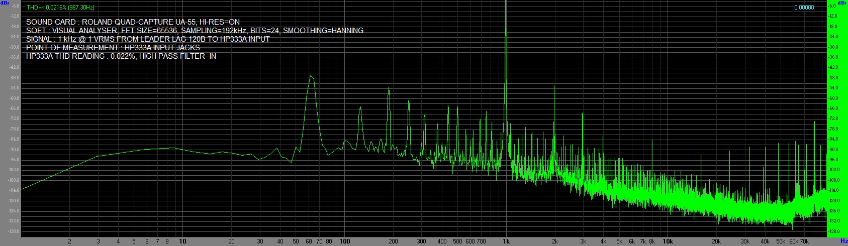

MEASUREMENT #1

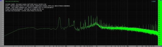

I submitted the HP333A to a 1 kHz sinus and took a FFT from the HP333A input. See FFT HP333A INPUT.jpg for more details.

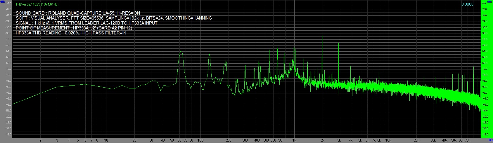

MEASUREMENT #2
I took the FFT of the residual signal at J2.
For a better visual comparison, I just moved the probe without adjusting anything else. I haven't resized the FFT. I haven't modified the sound card gain, etc.
From my point of vue, the fondamental frequency is 'gone'. The shape of the frequency content is similar to the one from measurement #1. It is a little bit cleaner in term of the number of frequency spikes.
Note the presence of the harmonics 2,3,and 4. They are recognisable in both measurement #1 and #2.
(FFT HP333A J2.jpg)

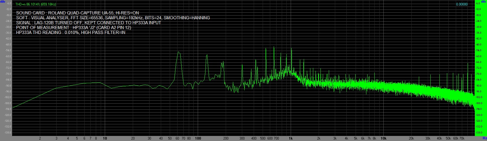

MEASUREMENT #3
I turned off the generator to look at the residual signal at J2. 2nd, 3rd and 4th harmonics are gone. The HP333A is reading 0.01% THD with no signal applied.
(FFT HP333A J2 NO SIGNAL.jpg)
MEASUREMENT #4
I turned off the HP333A. I took the FFT keeping the probe at J2 without adjusting or changing anything else.
(FFT HP333A OFF.jpg)
MY CONCLUSION
Taking a FFT of the residual signal at J2 with a sound card provides some information.
We can visualise the nulling performance..
I will do the same test with the HP334A to see how it compares.
Due to the limitations of the sound card, I will continue making measurements with an oscilloscope.

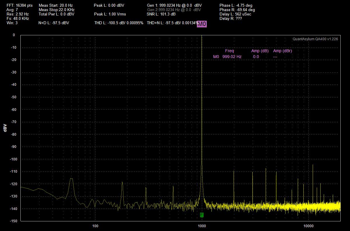

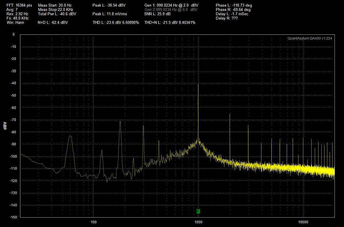

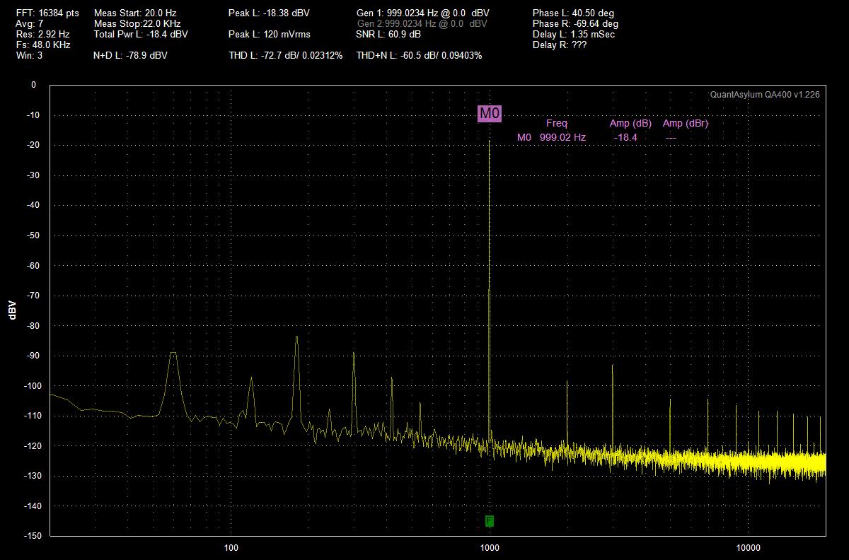

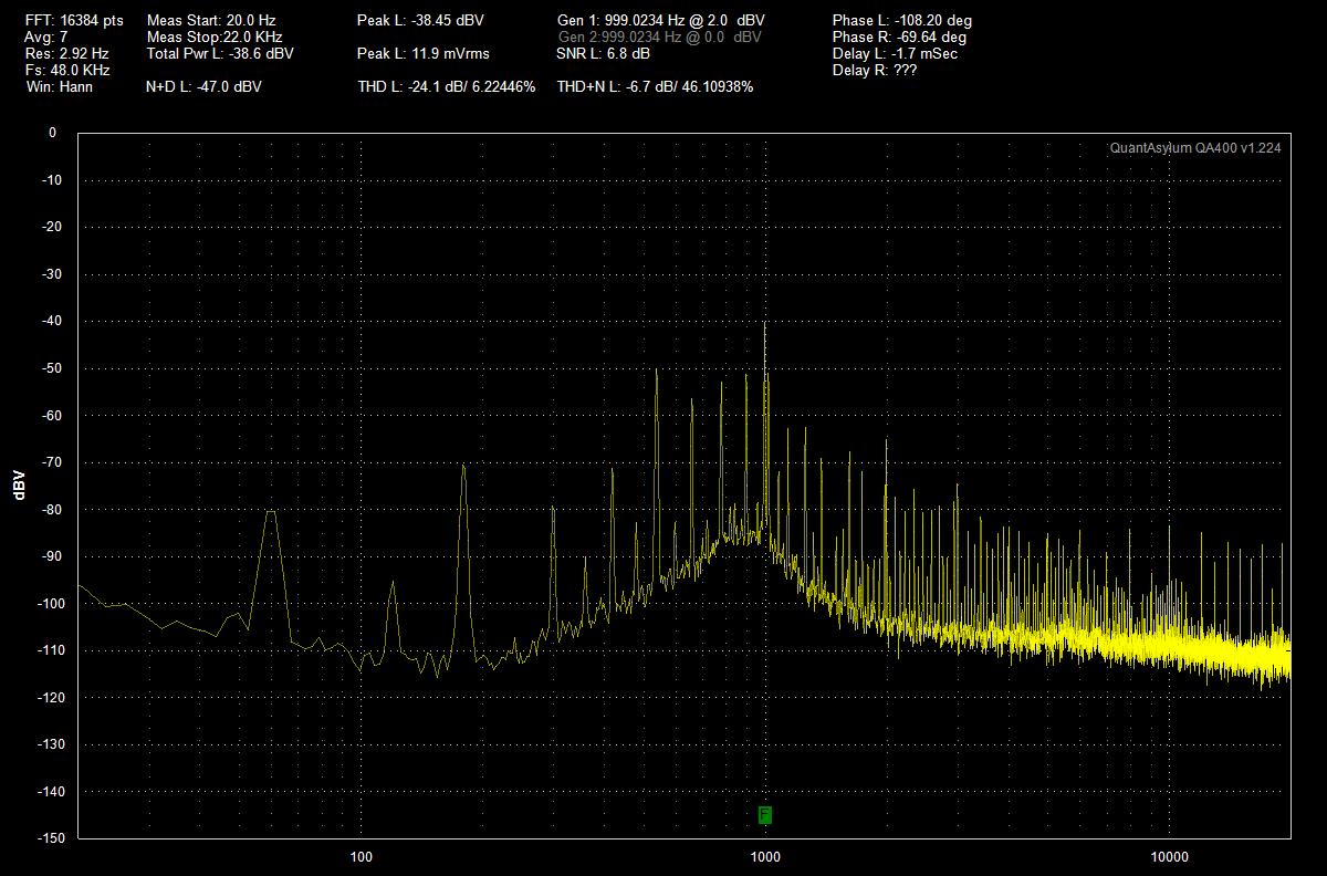

DASUTTON, Thanks for posting your results. I had some time tonight and ran a couple of the same spectrum scans on mine.
The first is the QA400's output measured at the 333a input terminals.
The second is the output at J2 with no nulling.
The third is the nulled output.
I do not think that my spectrums are that far off from yours. My 333a nulling is not as good as yours which appears to be around -50db where mine is around -44db.
Where my 333a is vastly different is in what the analog front panel meter is reading. Its showing about .5% for both the QA400 and Beckman oscillators.

After a lot of dabbling with this 333a I think I may have pinpointed the issue. I believe the problem was with the A3 pcb. As I said before the voltmeter function works great and the auto tuning works good as well. I noticed that when doing distortion measurements there was some spurious noise where the needle would jump up slightly every 15 - 20 secs or so, like a leaky transistor. I went through and replaced all of the caps on the A3 pcb which had no effect.
I then replaced Q1 (a 2N3904) on the A3 pcb. It is the input transistor for the preamplifier, there was no change in the measured noise level. I pulled Q2 and checked the hFE = 110 then Q3 hFE = 12. That hFE for Q3 seemed extremely low. Q5 on the bridge amplifier is the same PN as Q3 so I pulled it and the hFE = 60 for Q5.
So based on the extremely low hFE it looks like Q3 on the preamplifier is going bad. That transistor is a Motorola custom PN 4-354-536. Anyone got any ideas on a possible replacement?
I included the schematic of the A3 pcb.

I received the 334A that I bought off of auction. Checked it out and everything looks good, the meter is broken loose from the panel but other than that it works great. I opened it up and the wein bridge lamps are both working. The rotary switches look like brand new, no gunk on them and almost no visible wear/tracks in the wafers. So I connect my QA400 and put a 1V rms, 1 khz signal into it, the RMS meter measures spot on. Check the distortion and guess what. .55% distortion shown on the 334A.
Now I'm really baffled. 🙁
One thing I noticed is that even when I turn off the QA400 generator I still have > .5% distortion shown on the 334A even with no signal generated from the QA400. Even closing the QA400 software will not alleviate the .5% distortion reading. This distortion remains until I finally pull the USB plug to the QA400. Once I pull the USB plug to the QA400 the distortion completely drops in fact I can range the 334A down to the lowest distortion setting and I only show .07% distortion.
Connecting my function generator and sending the same 1V rms/1 kHz signal to the 334A nets me a .45% distortion reading, this is lower than the QA400 (.55%) and I know that cannot be. I know the QA400 is working properly as loopback still shows a very low .001% on the QA400 and I used the QA400 to check a preamplifier yesterday and it measured just about exactly as rated in the manufacturer specs.
So what am I doing wrong here? I'm failing to take something into account of this I'm sure. I'm using a standard 3' BNC cable to a BNC to banana adaptor to connect the QA400 to the 334A.
The good news is that the 334A does appear to be operating much better overall than the 333A that I bought locally. The output spectrum of the 334A is much cleaner than the best spectrum I was able to get out of the 333A. I attached the spectrum as measured by my QA400.
