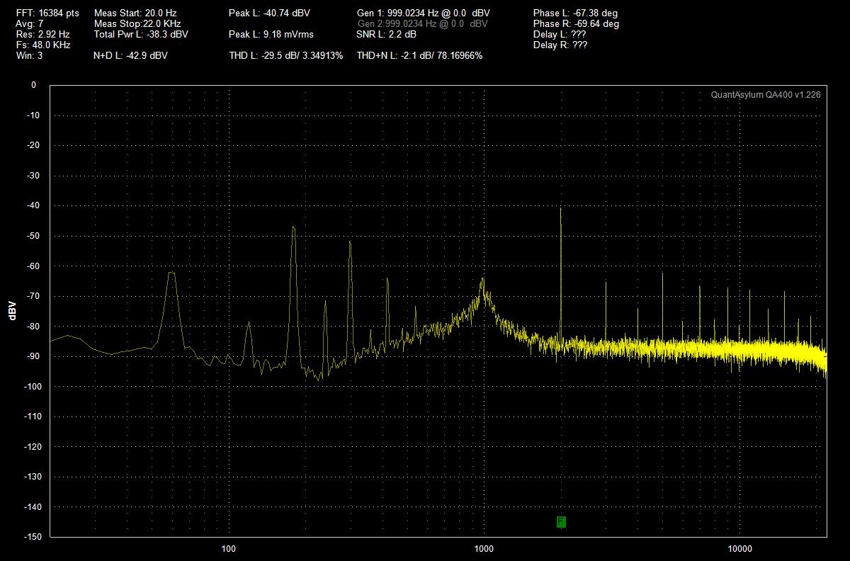

I ran some more tests tonight and figured out that the problem lies with the QA400.
I bought a Denon DA-300USB DAC a few months back and I decided to pull it out of my system and use it coupled with True RTA from my laptop as my oscillator. The specs on it are quite good with .0018% THD. I don't know why I didn't think of using it before. Anyway, connecting the Denon DA-300USB to my laptop and feeding a 1khz / 1V rms sine wave to the 334A netted .0135% THD+N. Disabling the sine wave drops the 334A distortion reading to .008% THD+N. This 334A displays .007% - .008% distortion with no signal across the 1 - 20 kHz range, not too bad!
I included a QA400 spectrum from the 334A output with the range set for -60db or .1%. As you can see the second harmonic is the highest and even its down about -100db.
I'm assuming that there is probably very high frequency noise present from the QA400 and due to the fact the 333A/334A have such a high frequency measurement capability (600khz) they are measuring this noise. I still plan to try and get verification on this from QA.

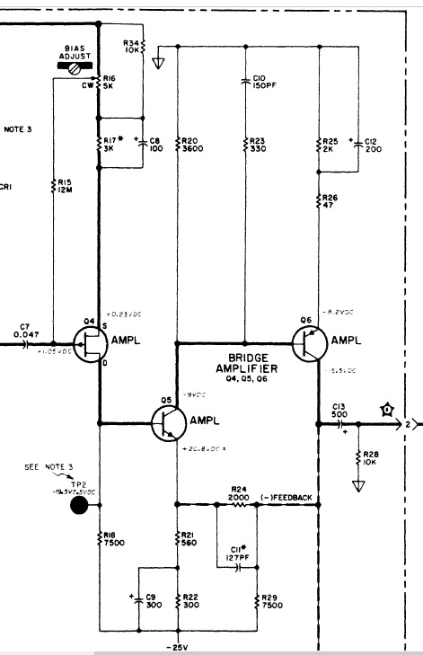

I was able to get the 333A functional again, this is the one that was giving me problems. As I stated before I had found a transistor with extremely low hFE (Q3) on the A3 pcb. I ended up replacing this transistor and Q5 (both were the same part #) on the A3 pcb with 2n3903's.
In checking the new 334A that I just received I found the bias point TP2 on A3 to have a much higher level than the manual recommends. It was set for 22V. TP1 on A3 was set properly at 2.65V. That 334A is working very well so I didn't adjust the bias points. However that got me wondering if the 19.5V I was setting the same point (TP2 on A3) in my 333A was too low. I went back into the 333A and began adjusting the TP2 bias point up from 19.5 and at around 20.5V the fundamental nulling began working again. I ended up setting TP2 at about 21V.
Now the 333A when measuring my Denon DAC shows about .012% THD+N where the 334A measures about .0135% THD+N. When the sine wave is disabled the 333A drops to .007% THD+N where the 334A drops to .008%. The needle is wavering a bit by approximately .001% THD on the 333A where my 334A is stable even at this low level. But the good news is that the 333A is completely usable now and matches up nicely with the stock 334A. So it ended up taking one working analyzer to assist me in getting the first one working again.
I guess the lesson here is if you substitute parts into an original circuit then the original bias points may no longer work! :D
It is possible that replacing a transistor has nothing to do with this fix.
Check the schematic for the A3 card. There is a note beside the test point TP2.
The original bias adjustment was set to obtain -19.5V at TP2.
But from change No. 14 it is specified at -20.2 .
I have included the conditions specified by HP prior to make any voltage and waveform measurements. May be something to think about. But also, what is the value of the reference voltages provided on the schematic if the bias level is changed. All the transistors around are direct coupled.
This small portion of circuit composed of Q4, Q5 and Q6, is ac coupled with the rest. Somehow the bias adjustment seems to affect the AC gain of the circuit.
I would need to simulate the circuit to get a better understanding.
From your experimentation and your results, this setting has a direct influence on the distortion measurement.
You are also able to get the needle down below 0.01% THD with your HP333A and HP334A. This is something that I can’t reproduce. I can’t get the needle(s) below around 0.015%.
I will simulate this part of the circuit with LTSPICE to see what is the impact of the bias change.

DASutton,
I overlooked the HP note you referenced in regards to later production units.
I had the inclination to reinstall the low hFE transistor back into the 333's A3 pcb the other day, but its working so well I thought I'd leave well enough alone. ;)
I was happily surprised to see the baseline distortion of these being so low. I was just hoping to be < .02%. FWIW the only thing I did to the 334A is adjust the - 25V down a touch, it was at -25.5V. That and wipe all of the switch contacts down with a contact cleaner dipped q-tip.
Oh and the meters mechanical zero was adjusted on both units back to actual zero they were both a good 1/8" below zero when powered off, so that is not skewing the results I'm seeing.

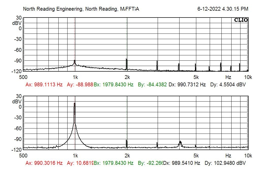

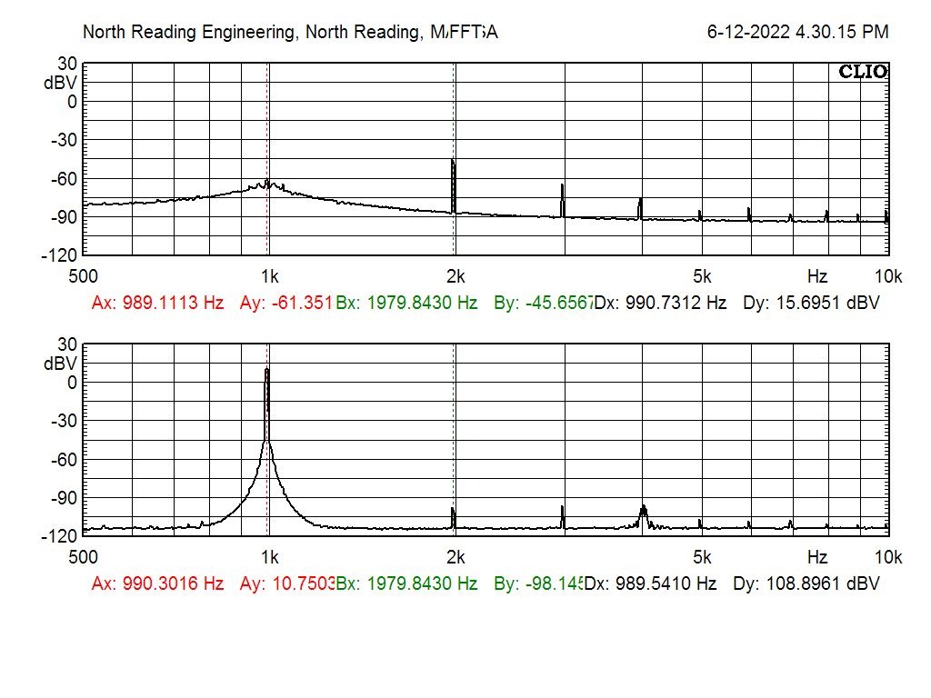

On the unit I worked, many of the components were removed, it was a donor which I set about to get operating. mechanically and cosmetically good condition. I replaced the wet Tantalums with encapsulated solid type, Vishay and Kemet. They're lower cost with excellent performance. Many transistors were pulled including the germaniums. I have an inventory of HP PNs including some of the specials used on this unit including factory matched. I have a second set of boards for the unit which allowed for some experimentation. One A5 board had all caps replaced and all LTPs matched to quite high precision (repeated runs, fixed temperature). On the other I just replaced the missing components. The result test showed about -3.5dBV of additional rejection on the completely reworked board.
The attached shows 1kHz input at +10.75dBV with rejection to -61.35dBV for -72.1dBV rejection of the fundamental or about .025% THD+N which the meter displayed accurately. The signal is an ultra-pure, 5VRMS sinewave sourced from a Krohn-Hite 6900B distortion analyzer with current calibration. The loop back of the Krohn-Hite shows about -30dBV additional rejection to .001%.
