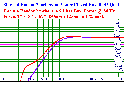

The port tunes the 9 liter box to 34 Hz. The size of the port does not matter, as long as it tunes the box to 34 Hz.
Since the Bandors, (understandably, considering their 2" size), have a high Fs, the graph should not surprise us. When Fb gets very low, the box output, impedance curve, etc. begins to resemble a closed box. Here, there is some difference in the outputs, but it is minor. F3 for the closed box is 80 Hz, for the vented box is 70 Hz.
The vented box does NOT show any effects the Quarter Wave action of the Port, (Line), which might well be there. Win ISD, (free version), does not chart or deal with Quarter Wave action.

Can't help but notice that in the System IV's, the pipe resonance is about the same distance above Fb as it was in the Focal Dalines-about half an octave.
The Focal Dalines had a Line with a cross section about 1.7 times the cone area of the driver. The System IV's had a cross section about equal, according to Steve.
The Focal Daline has huge "dip" if you model it like a reflex and ignore any output increase from the Line. The System IV's seem to have a decent curve if you model it like reflex. That might be a big difference.
The Focal Daline might need a Line with a big cross section relative to the driver Sd in order to provide the extra "oomph" in the "dip" region around 40-250 Hz or so.
The System IV's have no such "dip" region. Perhaps that is why they can get away with a Line with a cross section that is comparatively smaller, (relative to the driver), than the Focal Dalines.
Just speculating here, folks.

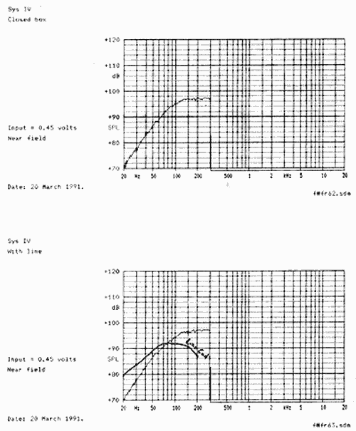

System IV measurements
I've managed to find some near-field measurement graphs of the System IV, which I've attached below.
The first graph is a near-field measurement of the System IV enclosure as a closed box.
The second graph is a near-field measurement of the System IV enclosure with the line open. The near-field measurement of the output from the line end has been added to this graph (although not summed because of the phase differences).
The reasons that there are discrepencies between these actual measurements and kelticwizard's calculations are:
1. I mistakenly stated the volume of the top chamber as 9 litres. In fact it was nearer 10 litres.
2. The driver specifications were for the latest Bandor 8 ohm drivers. There have been some changes and the specifications of the drivers used on the System IVs were slightly different.
As a result, it can be seen that the Qtc is somewhat lower than the 0.83 quoted by kelticwizard although perhaps not as low as the 0.6 that I had assumed.
Sorry for any confusion caused. I'm afraid that the 13 year gap has somewhat blunted my memory.

Steve:
The differences you mentioned probably do not amount to that much.
Checking Bandor's site, I see that you gave me the specs for the Type - 50AFSW/8. That is okay-I can work with that.
I have a different program to run these on. It is freeware, written by F4ier, a member here. It is Subwoofer Simulator, and it models many more curves. It is exact enough of a program, for instance, that it calculated the Bl prduct of the Bandor as being something less than 3, based on it's SPL.
