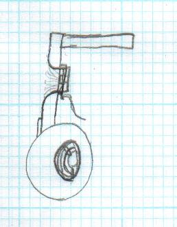

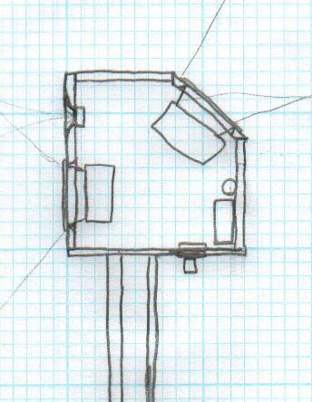

Okay, after having mulled it over for a while in my head, I think I have the proper balance of concepts here. This is what I've come up with:

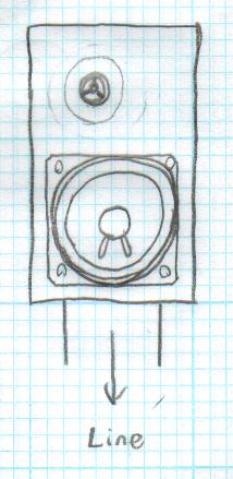

I don't know if to classify this as a one-way speaker or a two-way speaker, and you'll see why. The cabinet has a pentagonal shape. (I know of one other project using cheap 4" drivers that had a pentagonal cabinet, but I think mine's much less misguided than that particular one.) In the front, there is a vertical baffle, with drivers mounted on a horizontal axis. There will be one of the 4" NSBs, along with a mylar semi-dome tweeter element from Parts Express's Onkyo buyout, rear-mounted into a waveguide of sorts which looks sort of like a tiny round horn but much too short to achieve any meaningful loading. The NSB in the front (acting as a woofer) will cross over to the tweeter (more of a supertweeter)at about 10,000 Hz with a first-order high-pass on the tweeter and a first-order low-pass on the woofer. The sides of the enclosure will be vertical, and the top and bottom of the enclosure will be horizontal. In the back, the rear baffle will be vertical except for that the very top portion will be slanted back at 45 degrees. There I will mount another NSB (angled up and to the rear at a 45-degree angle in the way of the BD-Pipes). The rear NSB will be allowed to run through its full range of output (75 to 15,000 Hz.) I predict that this design decision will add some nice bipolar ambient effects, and make the speakers "look" bigger to one's ear than they actually are. The enclosure itself will be small, with the line built into the floor stand. I am hoping to be able to get a line such that its opening into the enclosure is about 3"x2". I have not yet determined the length of the line, and am still looking for information on how to determine this, or if a line with such small dimensions is even attainable. I am not sure whether to classify this as a one-way or two-way speaker because it has one set of drivers in a two-way configuration, and a second NSB driver running through its full range.
7V Steve: So, to get the required enclosure volume, I should model a ported enclosure, with a port that tunes the enclosure to a certain frequency, but instead of the reflex port I should substitute the line, correct? And perhaps the line should be the length of a quarter of the wavelength of what would otherwise be the enclosure's tuning frequency. Also correct?
The thing I am trying most to avoid here is having to build multiple test enclosures, if it may be avoided at all.

Any chance of a quickie sketch in MSPaint or some equivalent? I am having a hard time following your description.
Okay, but watch out for that crossover. Generally, it is recommended that the centers of the speakers being crossed over be one wavelength or less of the crossover frequency.
1 Hz = 13,500 inches. Therefore, the wavelength of 10,000 Hz is 1.35 inches, meaning that you will not be able to be anywhere near one wavelength at the crossover frequency. Adding to the difficulty are the first order crossovers, which have substantial output from both speakers through three or four octaves. Major lobing concerns.
Perhaps, instead of having the 4" and tweeter abutting each other, the answer is to move the tweeter so it is 2, 3 or 4 wavelengths away from the woofer. I don't know. You might want to start a separate thread just for this crossover problem-it appears complex.

Here is a view from the front. The tweeter is mounted behind the baffle, and I will use a router to round over the hole to make it like a waveguide. Note how the line is integrated into the speaker's stand.
