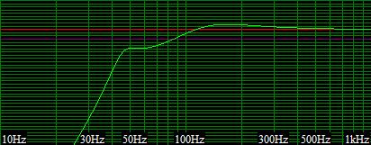

I modelled the Daline box as if it was purely a reflex box. Win ISD does not model Transmission Lines, so the Quarter Wave action of the port is not accounted for in this chart below.
What we see is a reflex box with a driver with a Qts that is far too low. The sloping dip shows that.
I can assure you , Focal would not put out a kit that gives a response that looks like that. So the quarter wave action of the port is an important factor here.
The quarter wave of a tube 64" long is the length of one wavelength, (13,500 in) divided by 64", and then divided by 4. This gives us 53 Hz. So the quarter wave action of the tube is 53 Hz.
As you can see, 53 Hz is located somewhere in the middle of that response dip. It must give the response a boost at that point, though we don't have the software to calculate it.

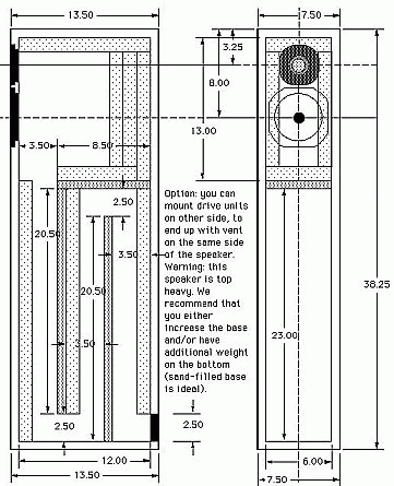

Here are the plans. There is a site with the plans in Metric, but those dimensions are imprecise and a little off. These drawings are clear. Metric types can convert inches to mm merely by multiplying by 25, so it is simple.
Oh, yes, you see the shaded pieces in the enclosure? That is not wood or MDF-that is just damping material. they call it Black Hole 5-I am not familiar with it. Apparently, this Daline is not stuffed with polyfill-just lined with heavy damping material.
http://216.239.37.104/translate_c?h...rch?q=daline&start=20&hl=en&lr=&ie=UTF-8&sa=N
And here is the drawing:

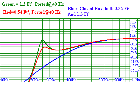

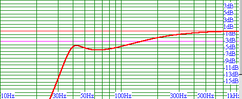

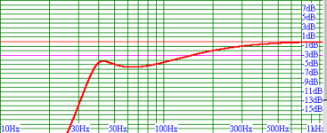

The Daline makes use of two phenomena-the relationship between the volume of air in a box and the port that is put there. This is a simple bass reflex. This, Win ISD, free version, models.
The Daline also makes use of another phenomenon: The pipe resonance of an extra long port. This, WinISD, free version, does not model.
So I calculated the volume of the top chamber-it was 0.54 ft³.
I calculated the height, width and length of the port, or Line: it was 3.5" x 6" x 64".
So I modelled the Focal 412DBL, the speaker that is in the Focal Daline Kit 044, and put in 0.54 ft³ for box volume, 3.5" x 6" for port dimensions, and kept changing the desired Hz value until I hit 64" length. That desired Hz value was 40 Hz. (Normally, WinISD takes the box volume, port area, and desired Fb and tells you how long the tube must be).
Since WinISD has no provision to measure pipe resonances, I knew that the curve produced would look different from the actual output. It is therefore useful for predicting how important Line output is in this enclsosure. As you can see, the Daline, as least as practiced by Focal, most certainly is not just a fancy name for a simple reflex box. The pipe resonance action must be substantial, for Focal would never sell a kit with a response curve so bad.
The volume of the speaker chamber, (top chamber), is 0.54 Ft³. The length of the Line is 3.5" x 6" x 64". The volume of the Line, which I decided to calculate, is 0.7777 Ft³.
Focal claims an F3 down point for the kit 044 of F3=40 Hz.
Just for the heck of it, I decided to model four curves. The reflex with the top chamber volume, (o.54 Ft³), tuned to 40 Hz. Port was negligible in size. That curve is in red.
The reflex with a box volume of both top chamber and Line together, (1.3Ft³). Fb=40 Hz. Port was negligible in size. That is the green curve.
I found that the closed box curve for both the chamber volume, (0.54Ft³), and total internal volume, (1.3Ft³) were identical. So I just ran one curve in blue for both.
These will give you an idea of just how much the pipe organ resonances help and how the Daline stacks up against the ported and reflex box in the "F3 per cubic inch" sweepstakes. It turns out that it stacks up quite well, assuming the Line output due to Quarter wave output smooths out that curve.
If there are any more questions, please let me know.
