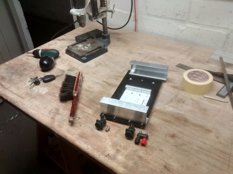

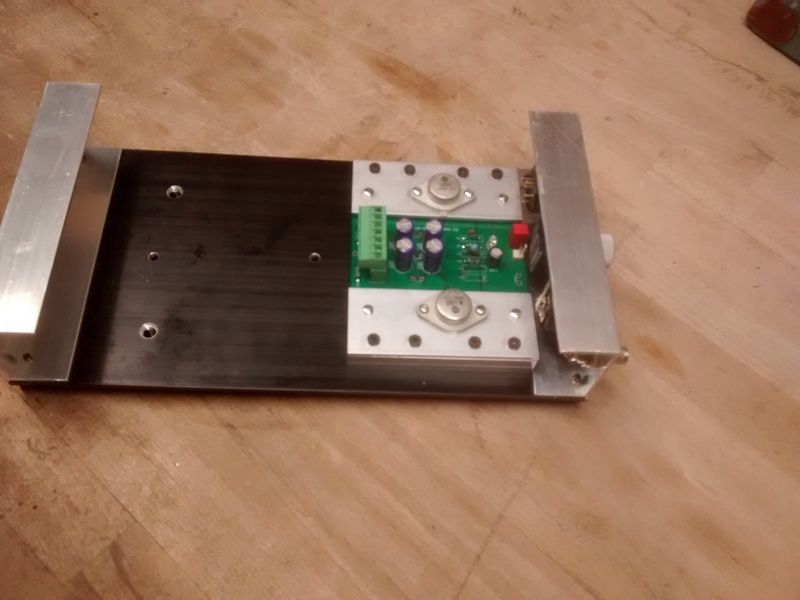

Now there is some work in progress....

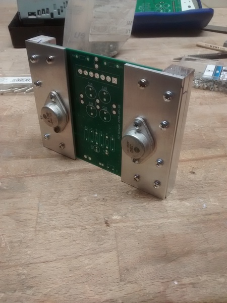

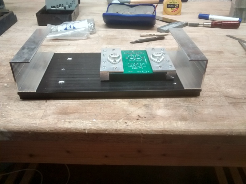

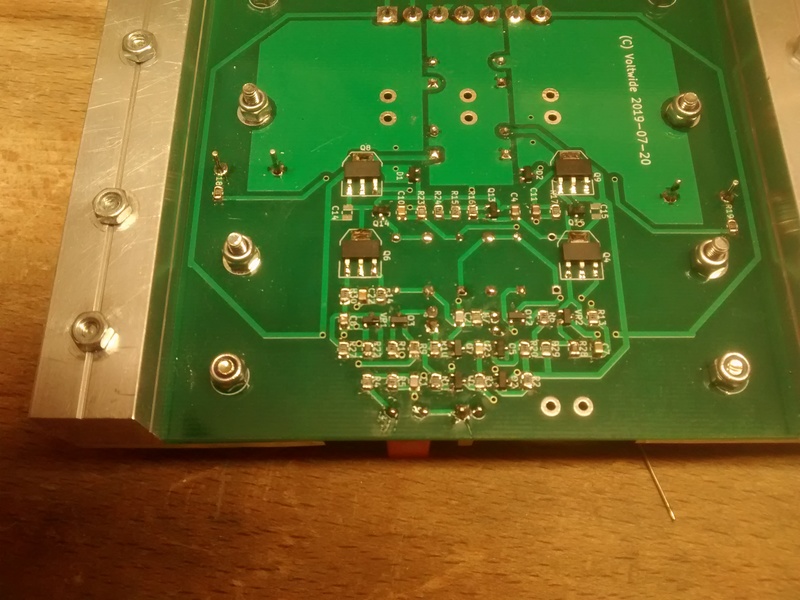

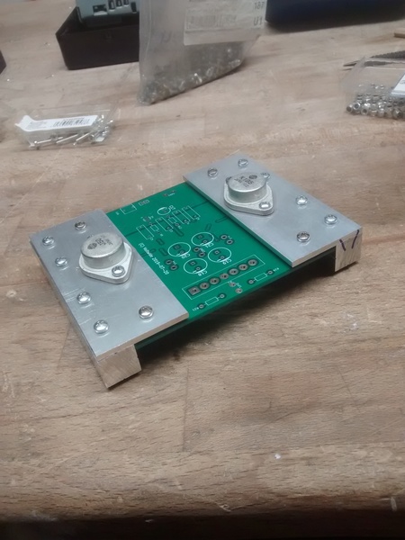

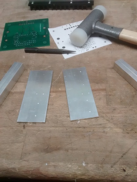

Good luck with your design voltwide, nice to see pics of your work, I can see how much more assy is required for a TO-3 metal can vs a TO-264 as I have used.

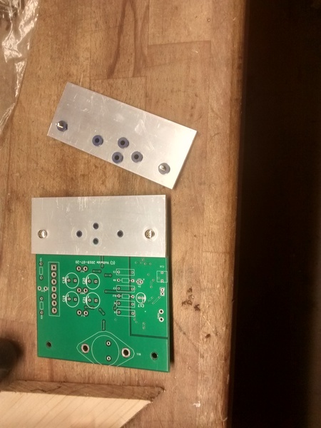

I found I could use my pcb as a drill template and get very good results.
I line up pcb with heatsink then clamp pcb to heat sink.
I then drill one of the transistor mounting bolt holes.
I put a bolt through the hole and tighten it down.
I then drill opposite end of heatsink and bolt that down.
You can now drill out rest of the holes through the pcb (with care.)
I have done quite a few this way and never had a problem.
I found for the connecting wire holes a hand held drill was better to stop the drill biting in the wrong place. I put the drill through the pcb hole and start it up slowly.
They are a pain and much harder than single hole transistors but nothing wrong with a bit of nostalgia !
The case is not really obsolete but certainly not used as much as the past with the newer plastic. TO-3 are more reliable as they are hermetically sealed, so no or little moisture absorption to contaminate in the pressure cooker test.

I do not take the pcb as a stencil but a 1:1 printout from my laser printer, which is sufficiently accurate. With paper stencil I punch-mark and then drill. This is less convenient but I avoid any ugly damage of the pcb.I found I could use my pcb as a drill template and get very good results.
If you go gently the hole aligns the drill into it.
Also, using an electric hand drill with the drill down the hole before you start stops the pcb hole being widened out.

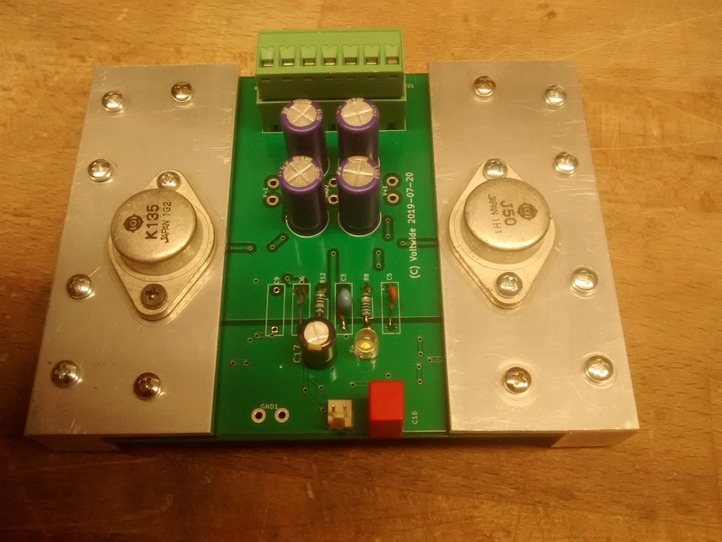

Some remarks to the actual pcb layout. Being 2-sided big copper filled areas are possible. So I divided the amp into 2 zones: the input zone with LTP ending at the input of the VAS. All nets of this area carry little voltage levels, so they are screened by a copper fill connected to analog GND.
The second zone is the power, carrying all the nets at the high output level. This includes the VAS output as well. This hole area is screened by a copper plane connected to the output. The idea behind this is to minimize the parasitic capacitive loading of the VAS by the well known method of an active screen.
The top view of the pcb shows these two areas, separated by a wide trench acting as "isolation barrier".
And this isolation barrier is bypassed by a minimized bunch of tht resistors and caps.

Maybe OT: Drilling aluminium requires cooling, normally alcohol or water or both. The ingredients of window cleaner are mostly water and alcohol: Spraying some window cleaner into the hole while drilling works remarkably well😉

The design is not really new, just a composition of well known details. This very design started on scratch with extended LTSpice simulations that led to the current pcb layout.

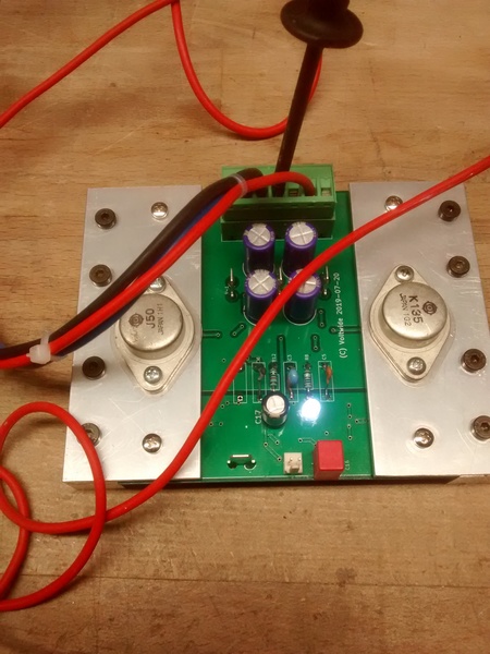

First measurements took place. Feeding with a regulated dual power starting at zero volts proved to be a good idea - both PowerMOSFETs had to be swapped. Grrrh!
But the next pass showed normal behaviour:
The LED is glowing!😎
