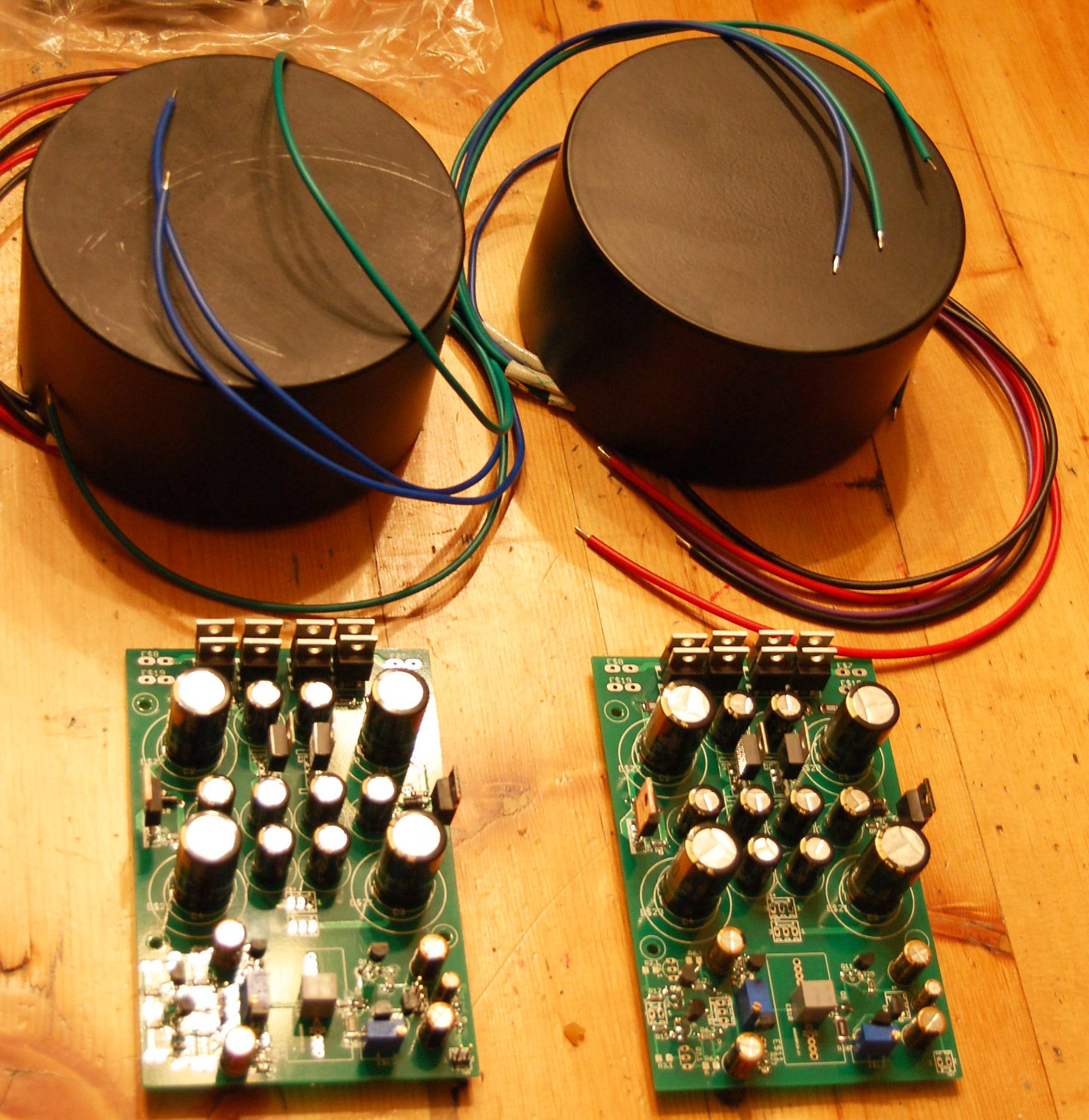

Boards are in. I will build the first set up tonight to confirm proper operation and then begin the shippping process. I hope to ship everything by friday, fingers crossed.
Sorry for delay. Due to ice storm, had no power through Tuesday and just got internet back at the house last night. All is soldered. Will put on wood blank, wire up transformers, and give it a go today. Ill send out board Monday and kits will have to wait as i somehow managed to forget one of the trimmer values and the small diodes on the PSU regs. The parts should be in by Tuesday, so all lkits will ship by Wednesday.

Boards are finished and making music. There are 3 issues specific to board layout:
1. The silkscreen is wrong for the Mur 860 diodes. They need to be reversed.
2. The intput ground pin is routed through the 100k shorting resistor. This means that the two input holes have to be shorted together and the ground from the signal run to the ground point of the psu input spot. Not a big deal bu we will discuss.
3. The 1K power resistor was layed out wrong, attaching before the 15R rail resistor, not after. THis can be easily resolved by simply by soldering it to the cap leg that is nearby. None of the issues above are serious and even significant. The alterations are basically unoticable if you did not know to looke for them. That being said, if you want new boards with these fixes, then I will make more.
There are two operational issues I have found.
First one is FE offset. For me build, I had a difference in rail voltage of about 1V. FOr whatever reason, this leads to an offset of -6V on FE output. This can be trimmed out by placing a 3K resistor across the 1K 2W resistor on the positive rail. I am investigating whether we can trim the rail difference on the PSU board, leaving the FE components unaffected, as this would be my preferred option. I am consulting Juma's opinion on this. Any other are welcome.
The second is the buffer offset. With the current BF862, I can only get offset to 200mV. This is a fairly easy fix and is resolved by being peculiar about Jfet Idss choice or by lowering the the current setting resistor on the bottom current source.
Once again, I am investigating both options and will present what I believe to be the easiest solution. If the Idss range of the BF 862's is favorable, it may be of no concern, otherwise it will simply mean a resistor change.
All that aside, I was pleased with the sound. It did not really change much, other than adding gain, and IMO, that is all that I want it to do. I want my poweramps to determine my sound, not my preamp. This preamp fits the bill. I will put it into my nicer system tonight and give it more listening time. FE is opp0105 and amps are M2 clone, J2 clone, and Funny^6. I will also work out possible work arounds for above issues. In truth, the operational issues would be present in any implementation, so they are just part of the circuit.

With help from Juma and Ilquam, I tracked down the problem. The BC550 bipolars on the lower half of the FE was inverted. Switched them out, removed the added resistors, and all is looking good. Offset is about 200mV and this can be trimmed if necessary, but the cap will take care of it before the buffer. In truth, even without the cap, it does not present a problem to the buffer.
The offset on the buffer was the result of the same error on the bc550 as well as BF862's with slightly lower than normal Idss. If their range is consistent, it may mean changing the value of R21 to put the pot in the range to needed to zero offset. I will post pictures of finished boards showing the changes needed and will provide a writeup for all who ordered them. Feel free to ask any questions here, once you start building.

Good news Buzz. Backward orientation of transistors certainly explains the problems you observed. At some point, post photos of your stuffed boards.
