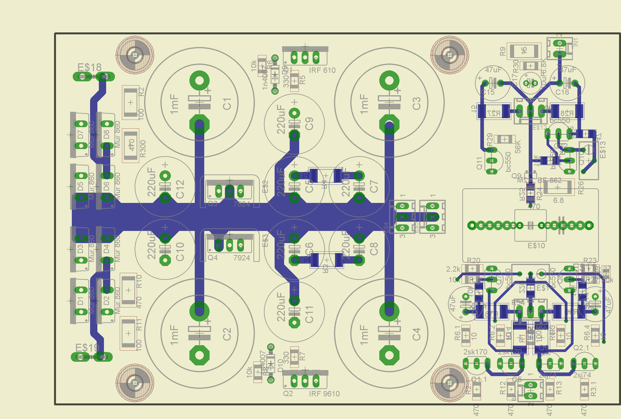

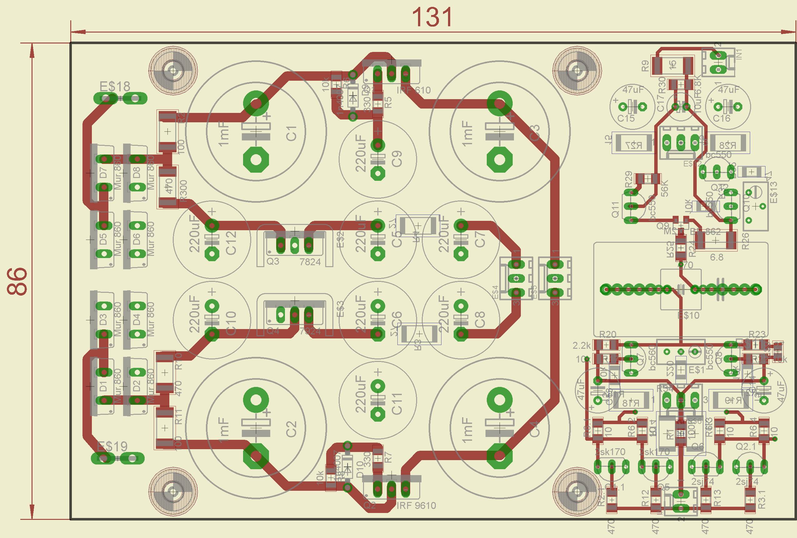

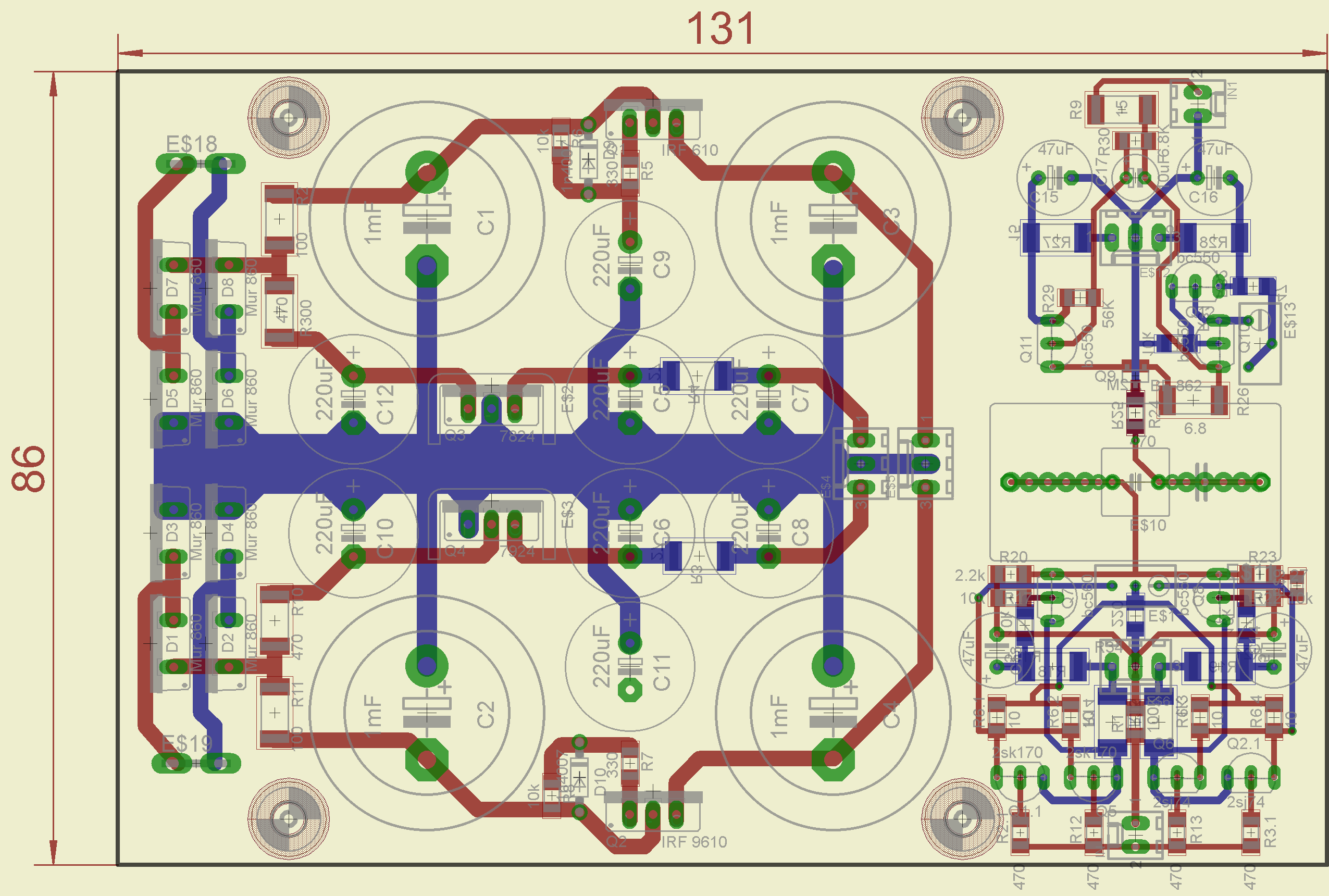

Board files
Her ya go. Give a once over for safety sake.

are the 2 pairs of jfets paralleled in the input there to allow the use of bl range devices? Couldn't we get away with one bl pair?
I have two suggestions:
Arrange input pairs to allow thermal coupling with zip tie arrangement.
Have a breakup line between the psu and line sections, this would allow to break of the psu section and use a single psu for both channels, for transformers with single secondary.
