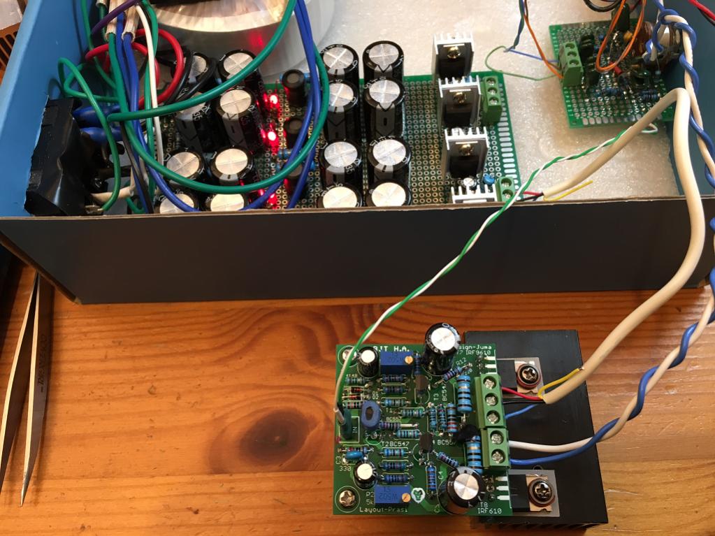

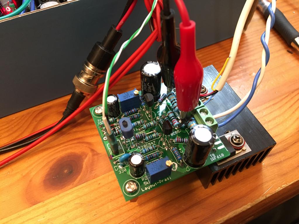

Juma HA First Sound
The first test worked right off the bat but a couple of minor issues that need to be addressed. For a quick test, I used the existing
PSU and volume/cross feed filter from the F5HA. The cross feed probably requires an input buffer between it and the Juma HA. In any event here is what I found.
Yes, it plays music and at the low volume I was able to get - sounds very nice with clear bass and highs, no noise (silent) when source is off.
The low volume may be result of too low of gain or use of cross feed which has a 5.5k output impedance from the cross feed circuit and volume pot.
The amp itself has very stable DC offset with super fine precision adjustability. However, to get 0mV offset, P2 had to be turned to the limit clockwise (I assume this is the full 5k position) if one wanted a lower bias current. The lowest bias current possible is too high at 220mA. Although operable, I would like to be able to run at 100mA if I wanted to. So something is off in the DC aspect of this circuit. Hfe's are matched between NPN and PNP at each stage and Vgs of MOSFETs are reasonable range 3.5 to 3.7v range (not matched). Maybe pot needs to be a 10k or add a 4.7k in series?
The bias starts out at 190mA and increases as it warms up to 220mA. this could mean possible thermal runaway given enough PSU ability. Probably would be less of an issue at 100mA to start with. Perhaps a 5k NTC thermistor in series with a 4k7 to clamp gate voltage of MOSFETs to respective rail could be used as tempco?
So I am hoping, that Juma can chime in with some tips to try to sort out this DC offset/high boas issue.
I did not get a chance to test without the cross feed filter yet. Source is an iPhone 6s - which has plenty of juice to drive the F5HA to loud levels.

Thanks, Prasi. It wouldn't be the first time I got a resistor wrong by 100x 🙂 I will check when I get home. If your sim shows it working then it's either me goofing up a value on a resistor, or the cross feed throwing it off.
The DC offset stability of Hfe matched and thermally tied BJT's is pretty impressive though.
