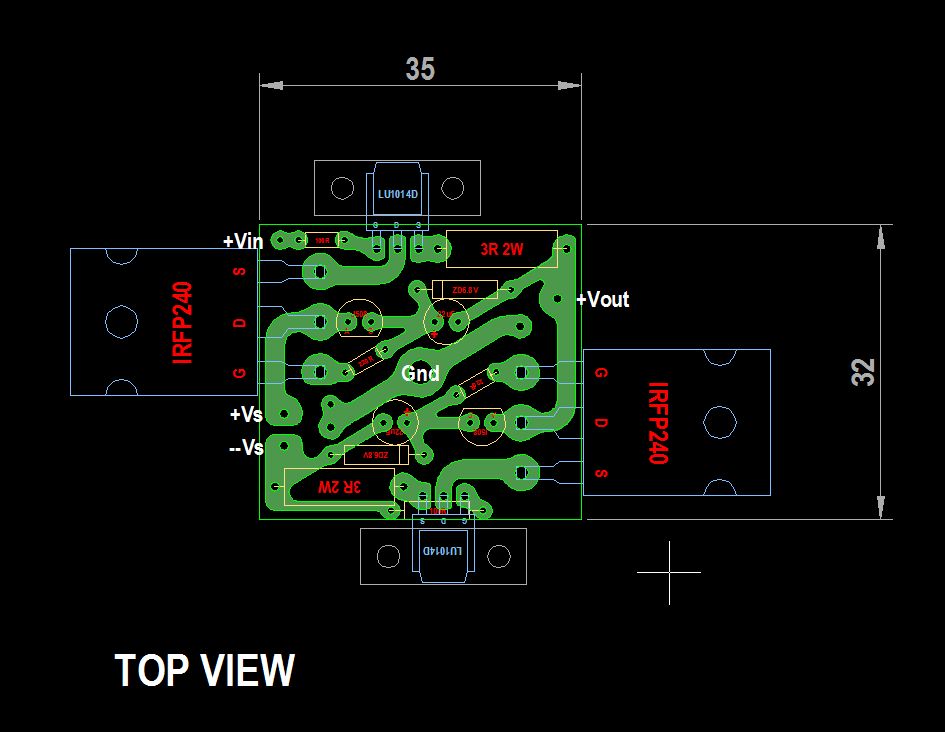

Dear Prasi,
Please design a single board but separate the areas such that they can be sawed off later depending on requirement. Join separate areas with jumpers.
gannaji
gannaji

Nice 4 quadrant design ! Heat will be distributed more evenly this way.
BTW why do many people not cut excess lead wires of power transistors anymore ? I have learned long ago that excess wires are antennas and to keep them as short as possible but that might be outdated info ?!
JP,
I don't cut the leads for a couple reasons. Easy to use as probe points for testing, and let's me pull it out and re-use in another project if needed (as was done here). 🙂
A 10mm antenna stub is in the ten GHz freq range - hardly of concern here in audio.
OK, new to me probably because I never reuse parts and don't do "universal" stuff as you might know by now 😉 I do it the old fashioned way: making a design and revise it where necessary.
Don't underestimate the antenna working of excess lead wires. You might not hear RF but it can have its influence.
I agree that leads need to be kept short, and if longer then twisted pair, coax shielded etc. Most typical class AB amps in SS forum have a 100nF and 10R in series and a 1.2uH and 10R in parallel tied to the output node to keep the amp stable with reactive loads and also suppresses RF output well. I never see those on a Pass class A amp in this forum. I wonder why - would it be detrimental for class A operation or is it just purists trying to keep the audio path free of all filters?

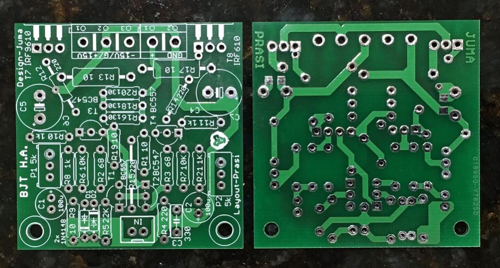

Using Hfe matched BC550C/BC560C's.
PCBs from Seeedstudio:
Built and awaiting testing:
nicely done X🙂, I think everything fits perfect😎...
what resistor combo are you using to set gain? R16/18/20 and R15.
just an info to other builders...R14 could be mounted below the board so that its very near to the G of IRF...
reg
Prasi
R16/R18 are 100R and R20 is 220R 0.5w
R15 is 220R per silk
Why mount that resistor underneath? To reduce parasitic distance?
Yes it fits all together perfectly. Nicely done on the layout! I like the 100nF SMT bypass cap pda on bottom. I use them always. It was nice to be able to fit a big fat 2200uF 16v rail smoothing cap on such a small amp.
I would have liked screw terminals on audio input but not a big deal.
yes, to reduce distances.Why mount that resistor underneath? To reduce parasitic distance?
i dont know why you prefer screw terminals for audio i/p😕, ease of cable connection? or you have them in plenty?. i think most people would prefer 2.54mm pitch jst connectors/ pcb headers , especially gold plated ones😉...
Yes, easy in/out from test setup. Most of my amps are like this so easy swapping in and out. For permanent use the plastic snap on header style (white plastic with detents) is good.
just observed from your build, there is a notch/groove to fit termi blocks together by sliding..
Yes, I know - it would be the case if the two blocks were from the same manufacturer! 🙂 But as it turns out, they are not. 😛
