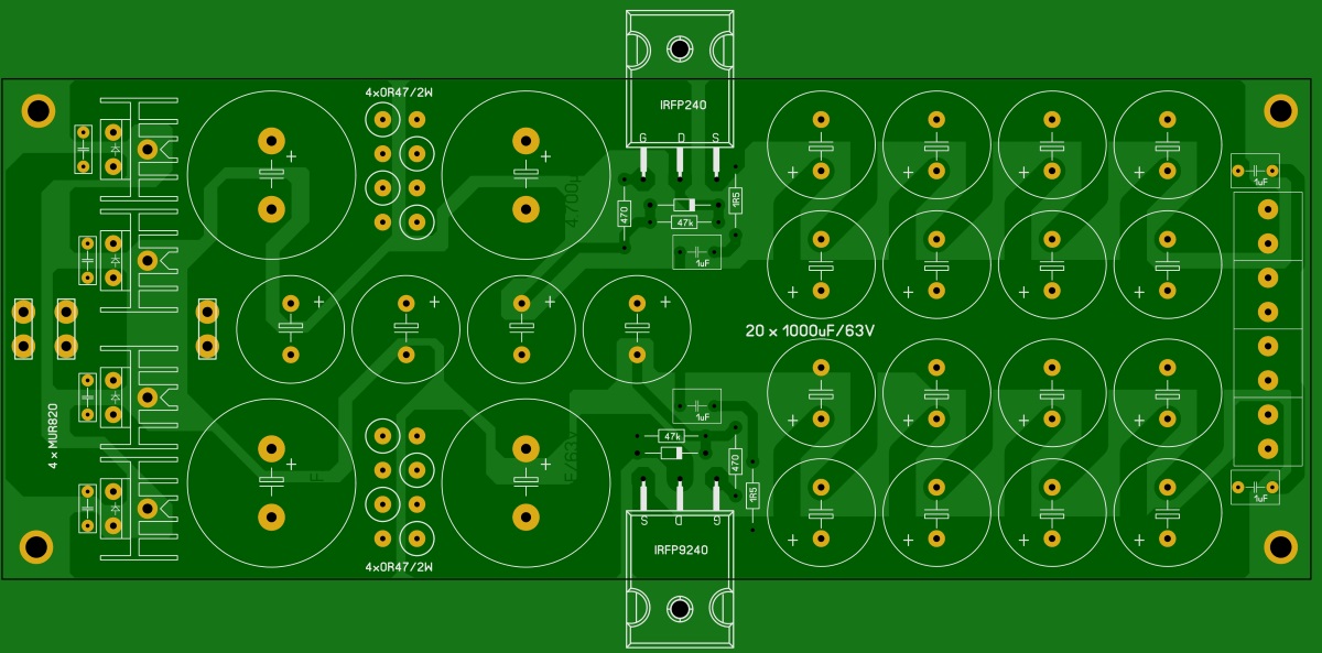

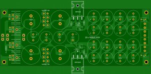

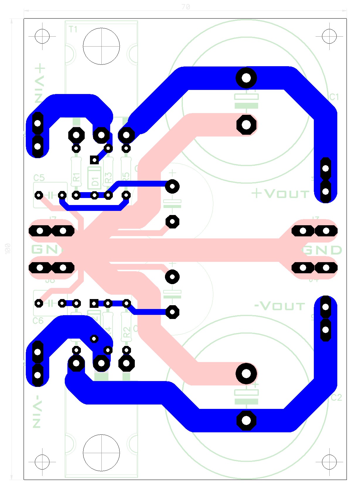

Can you post the two sides separately in pdf or jpeg?Hi X,
Some little exercice......
Marc
Thanks Marc. Any hope of stereo CM with all 4 outputs on a 100mmx100mm or is that too tight?
It dépend on 4700µf size so directly related to its voltage rating. With the 70x100mm version (mono version) i be able to put 35mm diam snap in cap so practicaly over 6800µ if want.
Marc
Oh sorry,my fault🙁
I mean in black & white for home etching.🙂
Hi thimios. I will take a look to provide pdf this weekend.
Marc

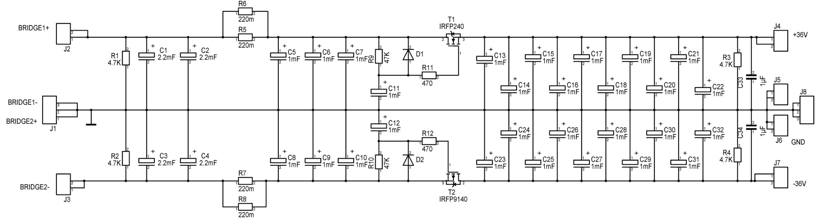

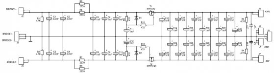

The juma cap multiplier schematic that is in post 95 was what I used on my recent Cubie3 postings. Please look there and a few posts later. In practice I made a few minor changes by using 8.2mF caps for C1-C4, 2.2mF caps for C5-C10 and I changed R3 and R4 to 330 ohms to keep Q1 (T1) and Q2(T2) from ever turning off if the amp was ever in AB mode, as per recommendation from Cirlomanen. Also, I used one PS per channel (dual mono blocs) so it might be slightly overkill. Please note that the IRFP9140 that I pulled from my library had the D and S reversed. In practice, I just soldered the correct wires up, but I will correct the schematic the next time I draw it.
With 1.1A Iq I measured +-36.1VDC on the rails and 0.1mV or less AC on the rails just like xrk971 did. It is less than what my DMM can measure accurately. Like xrk971 says, this circuit is very impressive in measurements and in sound, not to mention its low cost and small size.
Oh sorry,my fault🙁
Is that good for you?
normally the bigger can capacitors have 0.4" pin pitch (10.16mm)I am fine with 25mm dia for 4700uF 63v Nichicon caps (12.5mm spacing radial leads).
you could use lower voltage ( 60v fets) with logic level gate drive to reduce the 4 + volts lost accross each mosfet

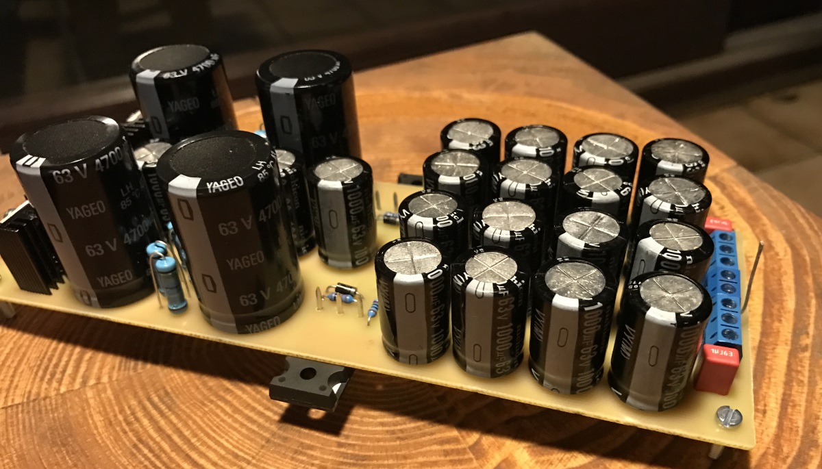

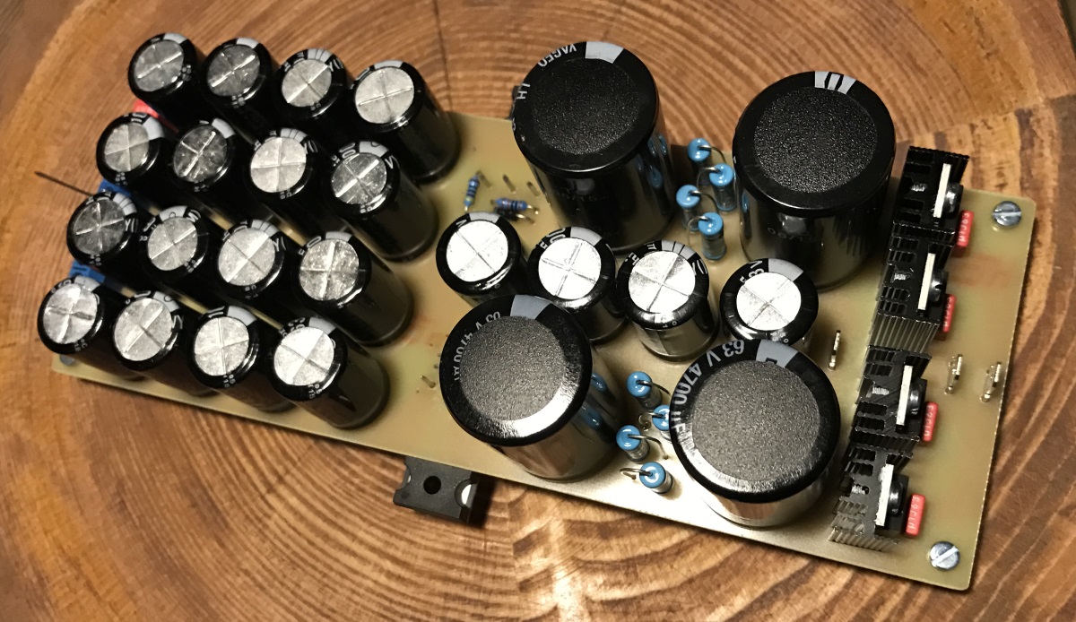

Hi, I have built a PSU free according to the Schematic which X has published in Post No. 95 with the parts I had on the shelf.
Will be tested next days or weekend. Looks good so far, not yet the optimal layout, but will developed. Just a few pictures for the entertainment 🙂
regards Olaf
regards Olaf
Olafk,
Wowza! That's beautiful work man.
That is Juma's schematic for qubie amp power supply. I only linked it.

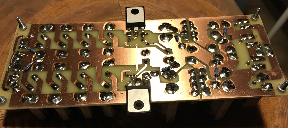

Hi thanks. PCB is released when everything works. Must still install a little cooling for the Fets, the discharge resistors must be finally on the PCB, some LED for check function and test everything. But looks already imposing 😀
75 x 195mm. Maximum length that I can etch at home.
regards Olaf
regards Olaf
Olafk: That looks great...good work. I see you got the pinout correct on the P channel MOSFET so you must have read my post #110, or you used juma's original in his post #1 in Cubie3 thread. I am looking forward to hearing your listening impressions, and I think you will be very pleased as x is and I am.
