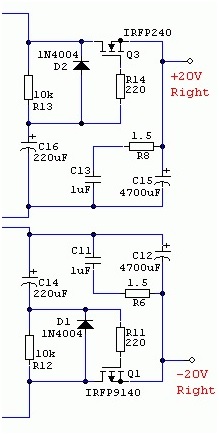

A cap multiplier uses series active device (bjt or mosfet) and it could be switched off. You need a DC offset detector on the power amp output and triggering circuit to switch off the cap multiplier (or other type of series PS regulator). This was used by John Linsley Hood in his 80W mosfet amp and I use it in my PS regulator here http://www.diyaudio.com/forums/solid-state/182554-thermaltrak-tmc-amp-22.html#post3907062.
It works very effectively, ones it saved my loudspeaker and amp(some cold solder in the amp caused full DC on the amp output).
It's simple to add overcurrent protection too.
The main requirement is not to have to big caps after the cap multiplier.

More listening impressions with the cap multiplier. It seems to make the contrast much much better so the "blacks are blacker". I am hearing very low level detail that was probably garbled in PSU noise/ripple before. For the low cost of $4 in MOSFETs and maybe $2 in caps - this is one of the best sound quality upgrades for the dollar. Also, if you listen to rather quiet passages and at lower levels the cap multiplier is a great enhancement.

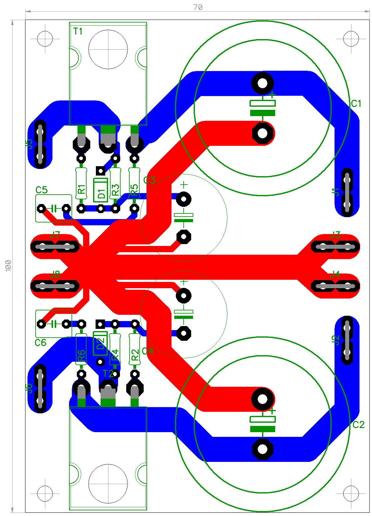

Build this cap multiplier and and have a listen - it makes a difference. Easy Peasy - no excuse not to. You don't need a PCB. In fact, I think a PCB will take more space here all you need to do is bolt the IRFP to some convenient location inside your case for some heat dissipation (it's not much). Solder up the 3 pins which hold it all together.

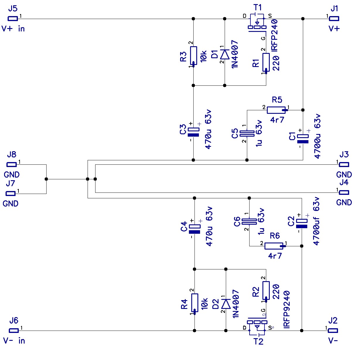

Are there limitations for higher voltages or changes in component parameters (+-50V) or can the same circuit be used?
once up to operating voltage the voltages are quite low so operates at high output voltage just like a 317 can even though it is rated @35V
But you have to look at start up when full supply voltage can appear across some devices.
IRFP240/9240 are rated 200+ volts? Make sure your electrolytic caps are rated for the voltage and should work.

One request. Can you make it 100x100 mm and have all 4 for a stereo setup like I have?

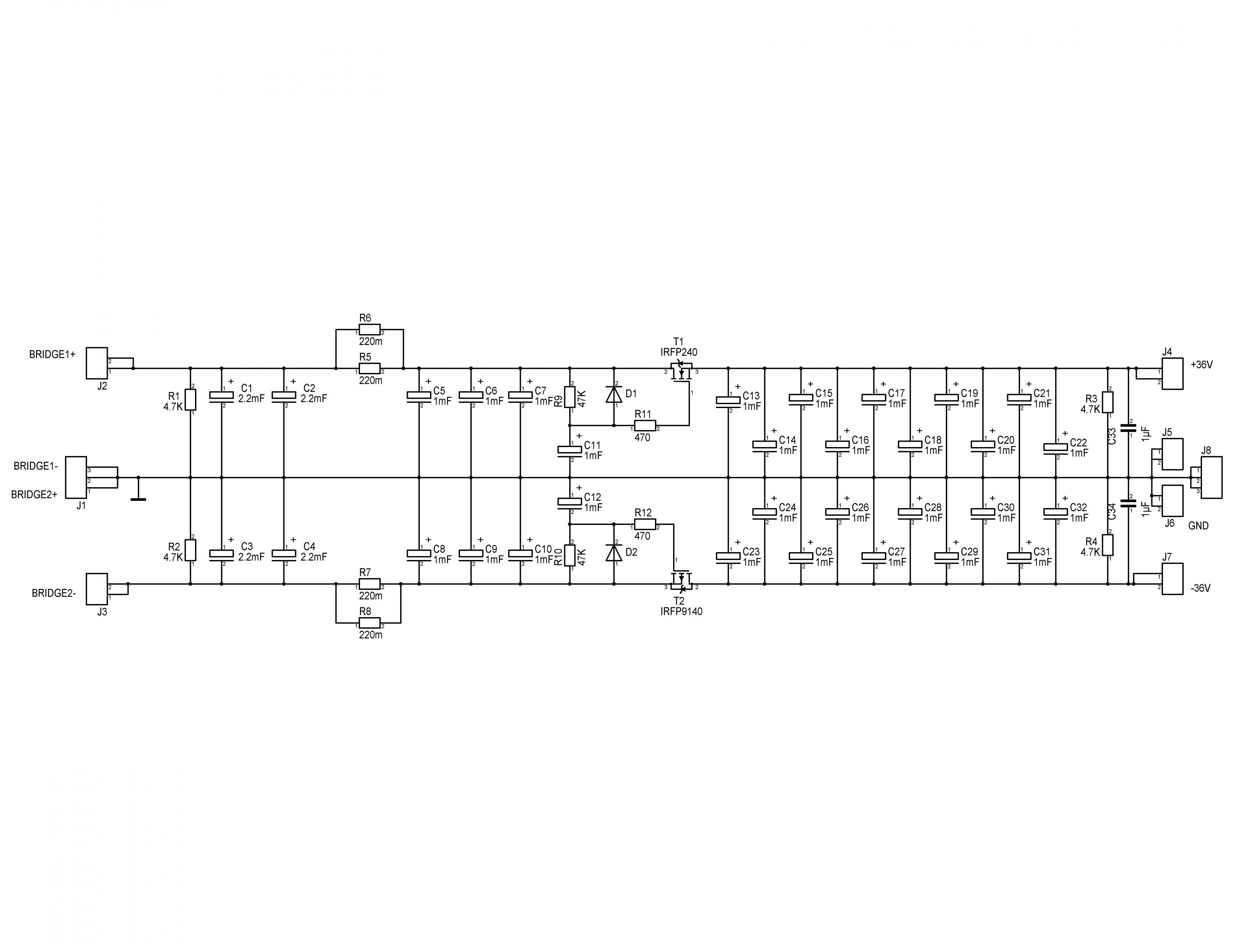

I'm a bit puzzled as to the inclusion of a 4,700uF cap on the OUTPUT of the C-Mx even though it's written in juma's circuit with a 47,000uF ripple cap after the diode bridge - IMO, this is a bit counterproductive - would possibly be better with 470uF or even smaller - maybe I'm missing something?
It seems you need some capacitance on the output and the more the better. Isn't that the capacitance that is being "multiplied"?
Here is another Juma CM:
Maybe because rds on of these fets can be over 1 ohm at these operating points? I know the gate capacitor is supposed to be "multiplied" , however, those caps now have an esr of the series resistor as far as the gate see's them. It may be effective at filtering the power supply side but seems to me would have quite high ac impedance from the load's point of view.
The cap being 'multiplied' is C11/C12 - the 1mF (1,000uF) - the larger values don't actually guarantee better performance even tho the ripple maybe at vanishing amounts - the impedance and the very nature of the caps contribute to the overall product (ie. a better power supply)

I consider Juma a "guru" of amp design, so if he uses big caps on the output of his CM, I trust him that it works. Anyhow, it's simple enough to run a simulation to see effect of size of output cap.
