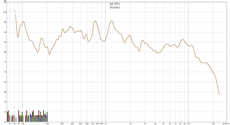

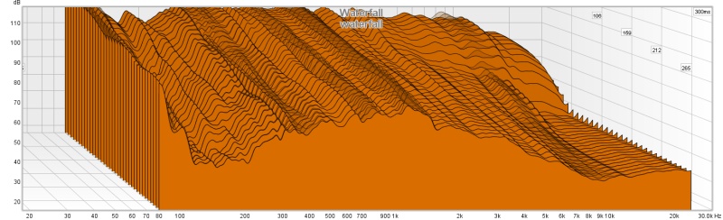

I assume that REW is doing a sine wave sweep to have produced these measurements.

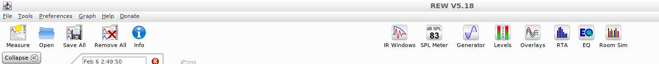

Click on the EQ button at the top of the screen.

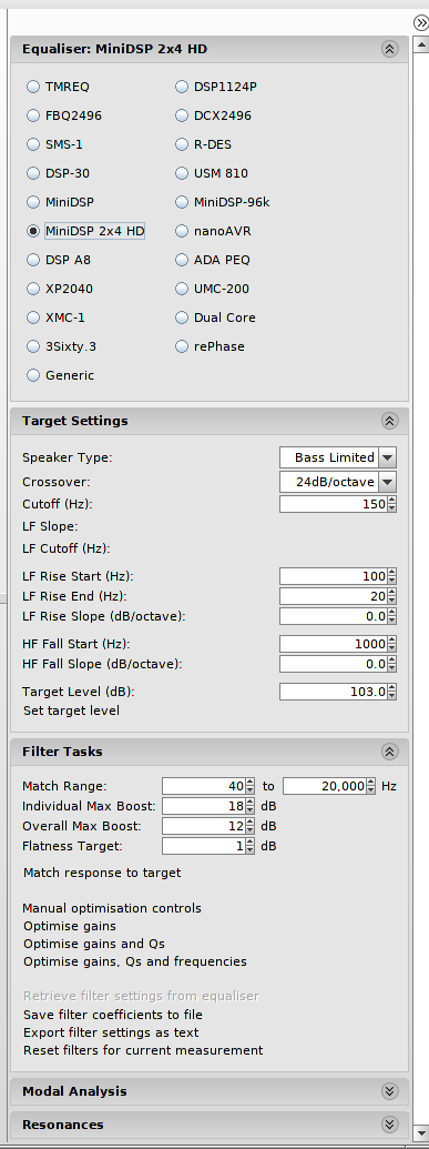

Tell REW what equalisation to do - the attached screenshot is a good starting point.
Click on "match response to target".
Click on EQ filters button at the top of the screen. REW should have produced some filters. You can save these filters and import them into the miniDSP software (sorry, can't remember details). Read REW help.
I don't get the measurements based on the musician, either.
Did you watch the YT video I referred to?
It all explains it, and should get you started.
Apparently, my set up is wrong. I need to reconfigure my soundcard. Reference to musicians? Don't they all sound different, and will produce a different graph? When making multiple measurements it doesn't matter if different recordings are used? Thanks
^^^^^^^^^^^I have probably 20 times. Still didn't see any reference that you measure without music. I'm a bit thick at times.
That's what it means when it says it uses sine wave sweeps. You can't be too thick you've bought some Jordan Eikonas, even some supposedly clever people here aren't that smart 😀
Thanks, Scott, that part probably went over my head. I've probably have over 40hrs vested messing with this REW & Mini DSP thing. Good thing my wife still works or it would have taken me a month instead of a week. Still not sure if my measurements are good. Heck of a way to log some break in hours though.
