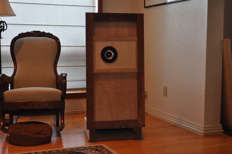

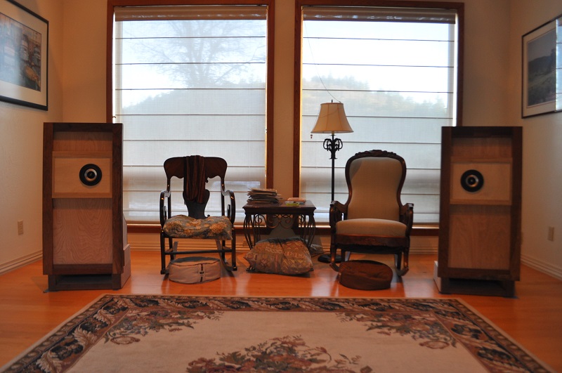

I finally got my new system up and running and I couldn't be happier!
I can understand your hesitation about the Eikonas mid-range, I have a pair of the mark 1. They are easy to listen to for long periods.
They look really good. Are the cabinets cut shapes from a sheet of plywood, with a hole in the middle? That would make a very strong and stable cabinet (apologies to UK readers for the unintended political reference). Does it use lots of plywood?
Andy
Yes, Its a Baltic Ply translam build. It does use more material then a standard build but it also makes for extremely stiff cabinets. And I love the look of the exposed grains...
The Eikonas 2 are the most natural sounding driver Ive heard to date!
I don't have plans, I just came up with a shape I liked and made sure the volume of the enclosures is correct. Having an odd shape and the cabinet being braced really well, will help with standing waves and maximizing driver output...
I have a MDF plinth (between the monitor and sub) with sticky tack on both sides to help with vibration isolation from the subs...
The Eikona 2s are in sealed cabinets at 5L for volume.
The subwoofers are 40L in volume and are tuned to 25Hz, F3-31Hz, F10-22Hz.
These sound very nice with no corrections.

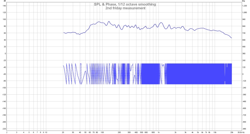

And when I posted the plot above I didn't have a clue as to what I was doing and still don't. After a few more hours pushing buttons, I came up with this. Still in the dark as to how to use this software. Thanks for the reply Andy.
