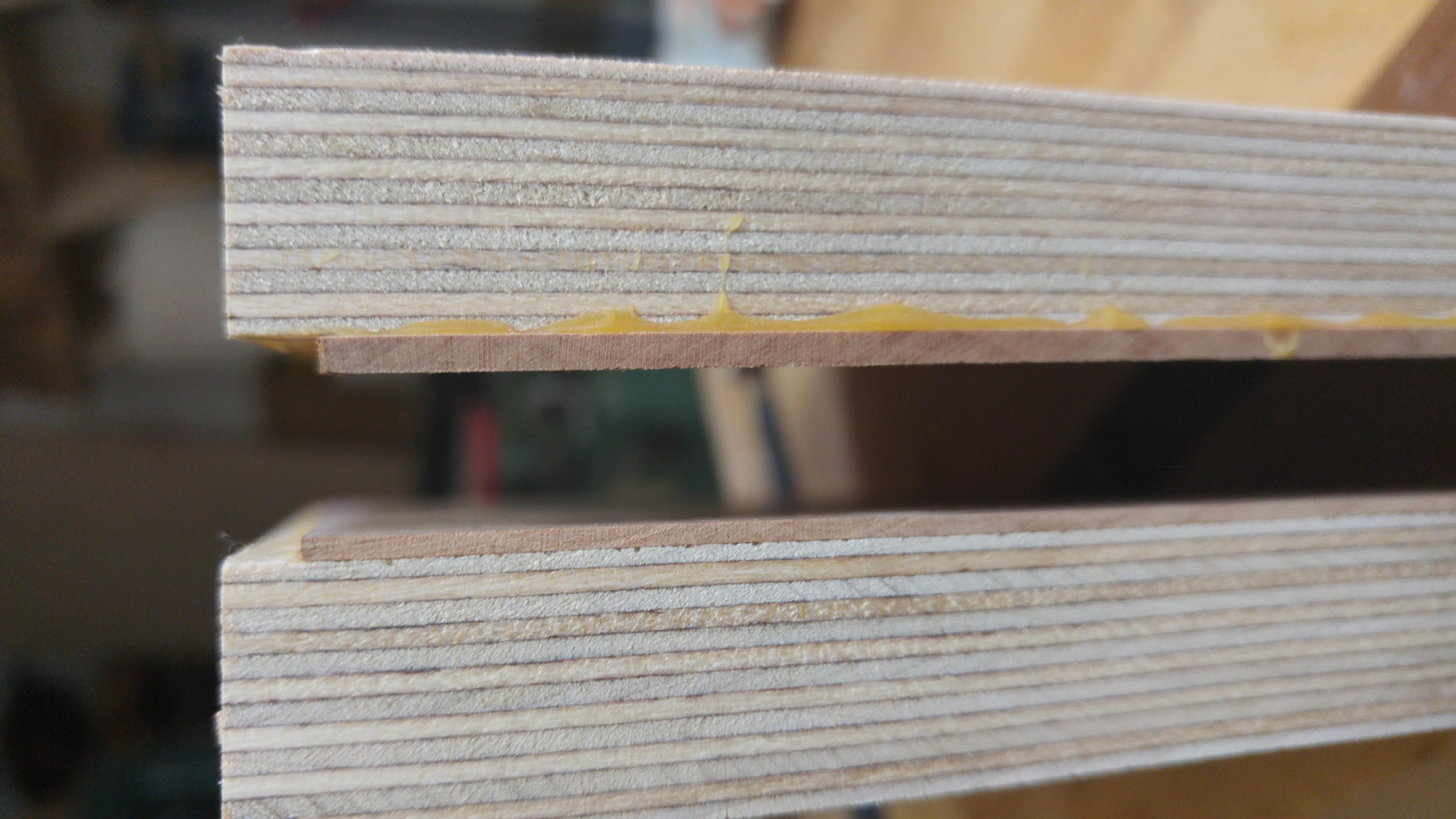

I've had pretty good success with combinations of dadoes and brad nails on my plywood builds. When a design calls for removable panels (usually back or bottom), those will be screwed onto perimeter cleats/battens and gasketed with foam weatherstripping tape. Dovetail or finger joints look gorgeous on Apple ply drawer boxes for higher end kitchens and office furniture, but I don't have the skills for that, and prefer post veneered finishes that would hide all that anyway.
