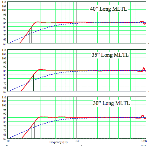

This afternoon I modeled three variations on a MLTL for the Jordan Eikona 2 driver with Martin King’s MLTL simulation spread sheet. The procedure with the MJK spread sheets is that you are the optimizer. Thus you vary the physical configuration (length, driver location, port location, port diameter and length, cross-section area of the line, and stuffing density) to yield a desired goal. My objective was to attain a flat system frequency response. Some inherent knowledge of MLTL variables and the simulation assist the user as they navigate through the effort.
For this example the three cases are all straight transmission lines and have inside tube lengths of 40”, 35”, and 30”. Most MLTLs are floor standing speakers so you wish to have the driver located so that sitting listeners are near ear height in the room. For each case in this study the driver is spaced at 1/5th times the length of the line down from the inside top. Thus the spacing is 8”, 7”, and 6” for this study. The port is centered two inches above bottom of the tube in all cases. I iterated and established the internal cross-sectional area (product of the width and depth) of the MLTL cases at 56 square inches. To smooth the response of the MLTL I used a stuffing density of 0.75 pounds per cubic foot for the filling material. Iteration of the port diameter and length established 2” diameter by 6” long as sufficient.
The specified stuffing fills the volume from the top of the enclosure to 3 inches below the driver. Meniscus Audio offers flat sheets of a bonded Dacron which is 0.75 pounds per cubic foot so this would take the guess work out of stuffing the enclosure.
I have attached a file that shows the system frequency response of my simulation efforts. Notice that the responses are all excellent and extend below 30 Hz before their 3 dB down low end response. The 40” line extends to below 24 Hz, the 35” line extends to below 26 Hz, and the 30” line goes to about 28 Hz. Any of these examples would provide exceptional performance. The Eikona is an impressive driver!
Now I always state the MLTL (and any ported box for that matter) will perform well for most musical situations but their performance is limited by the linear Xmax of the driver. These aren’t subwoofers and shouldn’t be expected to be used as such.
Finally, as with all of the Martin King simulation results, they are not for commercial usage without licensing from him.

Sims w JX92, but the Eikona will not affect the box related artifacts.

Simiaone asked about my Eikona 2 models summarized in Post #8 and repeated in Post #82 above in this thread. His questions and answers are below)
A) Other than height of the speaker and the driver location (8" down from speaker top for the 40" example) all the other dimensions remain the same?
Yes
B) the port is on a side of the speaker, not on the front? Does this matter?
Should not matter. I prefer rear port exits but if you wish you could use front or side if you wish.
Notice that the low end (F3 down points) for the frequency responses in Post #8 are all close. Hence, the performance is excellent for any of these three designs.
Jim
As per Toole, F3 is a meaningless determinant of LF response, one is much better to look at F6/F10. I have taken the liberty of editing Jim’s simulated FR graphs to give people a better idea of the responses. Dofferences are small, they all fall into the low 20s (an exceptional result), with the 30” probably having the best looking knee at roll-off. The knee of the 40” could likely be tamed by substituting a high ratio slot terminus.

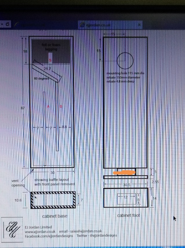

I want to build the cabinet for eikona 2. See picture.
My question : Can i raised the area marked by red from 5 to 15 cm so that it is at my ear level.?
Hi - Yes, you can raise the height of the foot. The distance of the port to the floor is not critical.
If you want to see the MLTL designs, there are some on our website
loudspeaker plans - E J Jordan Designs
