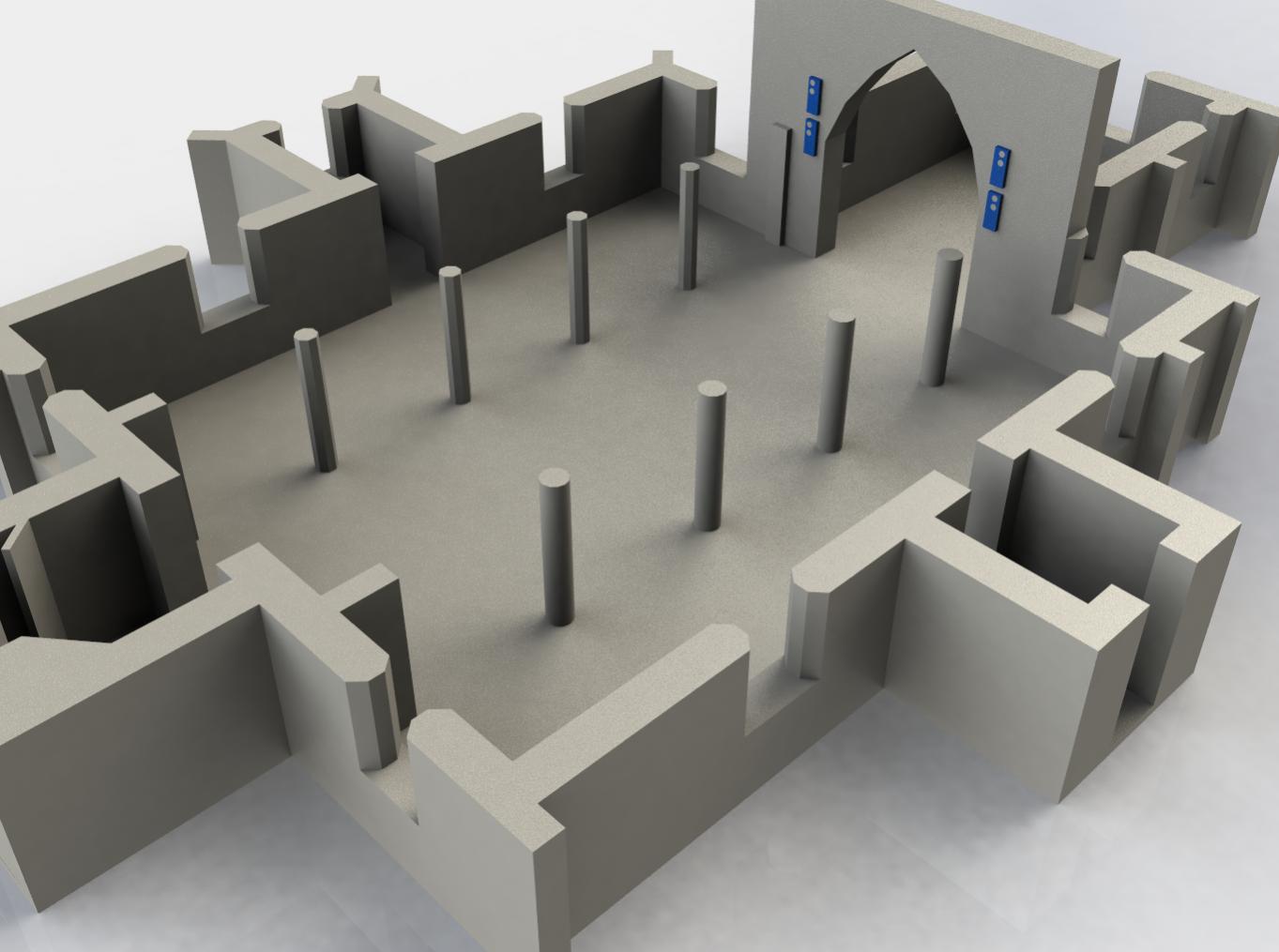

Hi!
I'm considering building four pairs of the DCR for a digital organ project (Hauptwerk). With Hauptwerk you can use an 8 channel firewire box (MOTU etc) and direct particular instruments at particular channels. I've not decided what amps to put in between or whether to run series or parallel. Are there any 8 channel valve amps around?
A 16 feet stop has as lowest frequency 32 Hz. A 32 feet stop has as lowest frequency 16 Hz. I'd only get down there with my Definitive Tech SuperCube 6000 I think. It shakes the foundatons of the house!
Channels Instruments
1-2 All 16' & 8' pedals , reeds, midi notes 36-48 and 16' manual stops. Stereo mixed with sub.
3-4 Manuals, reeds and strings and 4' pedal stops - C,D,E,F#,G#,A# ... C#,D#,F,G,A,B
5-8 Manuals, principles, flutes - C,C#,D... D#,E,F... F#,G,G#... A,A#,B
Channels 1 - 4 will be at ear level and 5-8 above 1-4.
Would the Marantz MM8003 ( 8 ch 140W amp ) be ok to run the DCRs? I picked this up a few years ago for ~£300 ex demo.
I would be interested to work with anyone here to develop an organ console speaker system based on the Eikona-2. Maybe dropping back to a single driver for each channel.
Let me know your thoughts.
David.

SGPU - What size room are you planning to use the Eikonas in and what is the maximum SPL you wish to achieve?

I'm glad to see the Supercube is a sub. Even the MLTL Eikonas won't get to 16Hz.
The DCR will go down to around 50Hz. Doubling the Eikonas gives greater power handling and sensitivity (if wired in parallel). The Marantz looks like it has plenty of power but is rated to 6Ω rather than 4Ω (correct me if I'm wrong) in which case series connection (12Ω) would be safer. I run a pair of Aurora 800s here with a Marantz AVR also wired in series and it works well and with much lower power than your 8003.

Used that way and in conjunction with the sub, the DCRs should work well.

The organ practice room is 22ft x 15ft. With room for a dozen seats. SPL wise 70 peak to 80 ish would be OK. I believe two DCR speakers might do the trick, maybe four MLTL 38s.
I'm also investigating an organ speaker system for in the church itself. Ours is a 800yo doomsday church. We recently had the pews taken out, replaced by under floor heating and oak flooring.
The old organ in church is beyond economical repair so I've been tasked to remove it and build something digital. We'd like it to be discrete. I don't want big PA black boxes around or white metallic boxes. My first choice is Triad Gold 6s. They're less than 90mm off the wall. We could cover with with a nice acoustic fabric / banner / or tapestry. Dispersion is great too. Another option is Definitive Tech UIW.

I'm guessing 10 to 14 Eikona drivers from a localised area would not be sufficient to fill a church 13m wide, 17m long with an full range beautiful organ sound peaking at 80 ish. The congregation averages 50 people so we want to hear it above singing voices.

Some quick renders with four DCRs in place. First driver is 2m from floor level. The vertical angle from first driver to our new front row of seating is ~ 18'deg.
I would probably set all four as some instruments and stereo mix others. It would be a trial and error.
