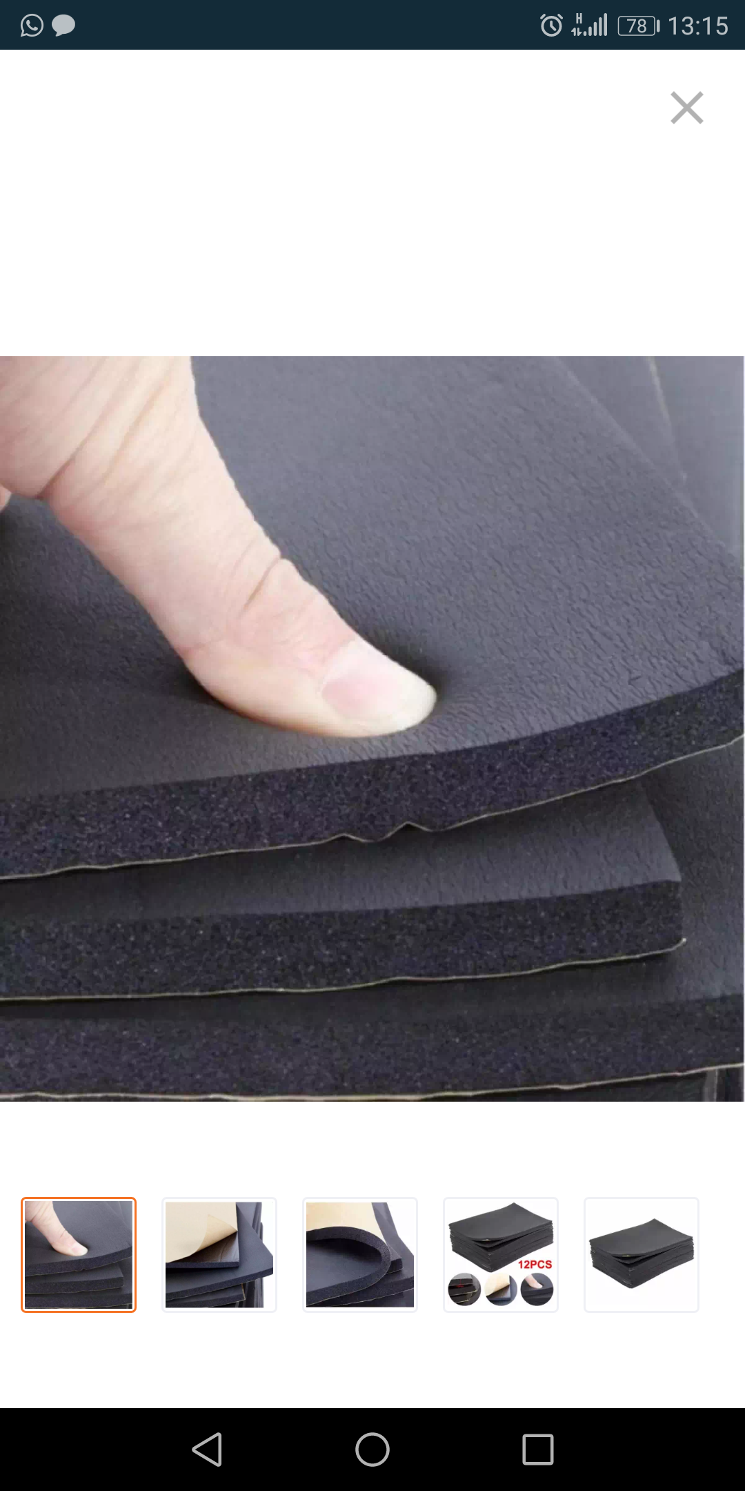

Something like this
Use more bracing if you're concerned about panel resonance. Belting a box with your knuckles is not representative of how the cabinet & drive units function & is usually only of value in quickly establishing where a main panel mode exists.
The foam pictured looks on a quick glance to be a closed cell type, so it will be ineffective for acoustic damping (it will be bordering on reflective) & probably just take up internal volume. However, it doesn't look to have a sufficiently high mass to dramatically affect the resonant behaviour of the panels either, making it the worst of both worlds.
AFAIC the knuckle test is not very valid.
Yeah, one can only tell if the cab sounds 'hollow' at a low frequency, which for speakers with a tuning down low is useless as it either needs to sound like one's knuckles hitting a concrete slab [well below tuning] or when hitting a braced metal panel [well above tuning] to ensure the driver can't excite any cab panel eigenmodes.
From this we see that increasing the cab's stiffness via full 3D bracing to tie all six sides together is the cheapest, easiest, least bulky way to achieving our goal, so if one is going to use a knock test, at least use a ball peen hammer or similar.
