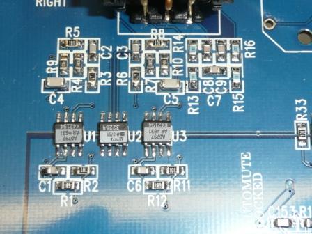

Do you think that the cap used in the circuit that Demian has used a .1 npo cap? DEMIAN, please respond.
Here is the circuit diagram for the demo board in question ESS SABRE 9012 Demo board schematic
The circuit calls out 2 .1 caps to ground (my mistake, its more serious than I thought) on pg 1 U2. all of the components are really low value. the size is approx 2mmX4mm. The sample NPO's I have are easily 10X that.
And here is a picture of the board in question:
I think RFI is a serious issue that degrades everything, but the fixes don't necessarily improve things.
