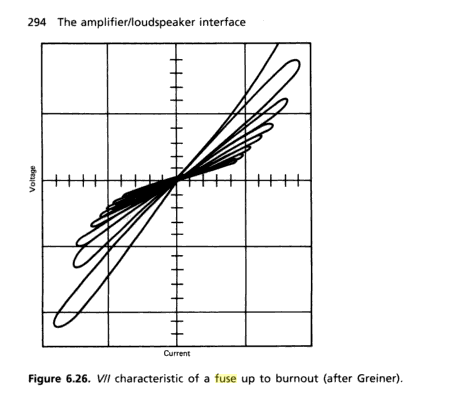

bear said:
I think I mentioned this some time back, but iirc, Borwick in his book on headphones and speakers has a very clearly written and detailed chapter on the non-linear effects of fuses.

I usually remove all fuses, but for different reasons. Note: I do not like to listen to music loud and never have had an incident due to a lack of fuse.
But on their non-linearities, yes, they are easily derived. Like most non-linear resistances one would be hard pressed to argue for any effects that were not low order, symmetrical, and most important at an appreciable fraction of their rated use. Most importantly like things analog the effects monotonically decrease with level.

Dimitri this plot is unscaled. In general without scales this data is not useful. You can show non-linearity of RN60 resistors at -130dB and blow it up to fill the screen.
Put a fuse in series with a speaker and then replace it with a resistance and look at the difference. Hard since fuses are tiny fractional Ohms. OTOH a four wire measurement on a fuse is easy to do with a good instrumentation amplifier.
