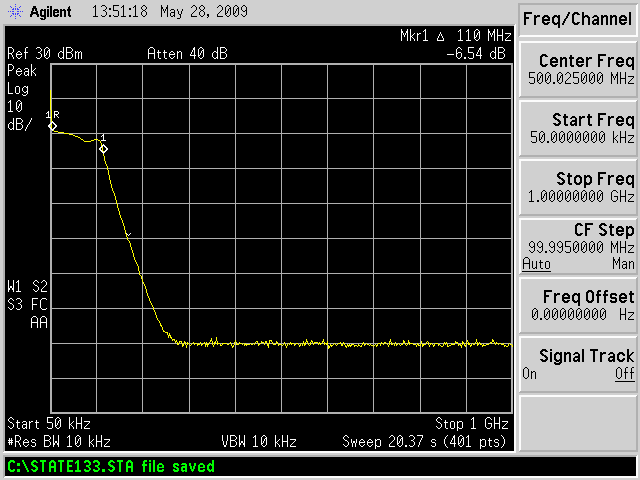

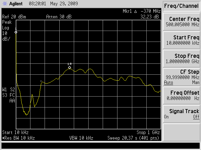

Regarding RFI immunity, I can show proper and standard design approach.
The 1st image is a 100MHz amp, on a PCB out of any metal box, designed according to RF rules. Displayed is frequency response.
