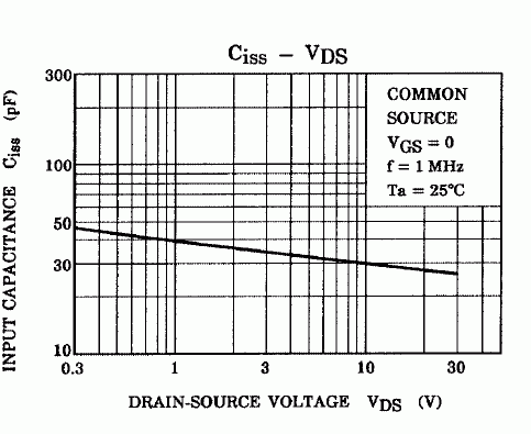

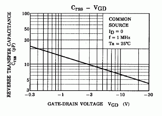

Especially with large diaphragm mics, I am more concerned about varactor effects than of noises.
Edit: see attached picture.

Wavebourn, do the numbers, first you will find that low noise high capacitance JFETs' like 2SK170 buy you nothing on noise and second you will find that the seconds due to capacitance modulation are swamped by the distortion of the typical source follower/phase splitter. The distortion (I posted actual measurements a few weeks ago) can be trimmed to a -90dB null by simple bias adjustment on the JFET and this trim absorbs all the sources of seconds. Mr. Wuttke has confirmed that this is done on every production mic. The null is so sharp that I remain a little skeptical on how well a -90dB null will "age" but some improvement must be maintained.
B&K uses a different approach stressing ultra low (or negative) input C, there are good reasons for this and it makes good reading.
Being "analytical" instruments B&K mics are not liked by some recording engineers. I really have no comment on this or on the large number of engineers who won't use anything but Neuman mics with VF-14 valves.
I skinned the cat by another way, John.
The exercise was, to take original devices, add a transformer, and arrange such a way distortions will be introduced less (not compensated, because compensating the 2'nd order of a complex function you gain nothing sonically, especially when it is modulated by real signal's envelope).
Variant 1: original. Varactor between D and G, large swing on D in respect to G. Varactor between G and S is effectively bootstrapped: the same swing, but opposite, on S as on D.
Variant 2: Cascode on top. Varactor loaded on a naked diode, C of top transistor loaded on b-e junction of a PNP transistor. Feedback by voltage bootstraps Cgd, but Cge is loaded on a naked eb junction.
Variant 3: No cascode. Сds varactor loaded on be junction of PNP transistor. Higher voltage -> lower capacitance. Diode shunted by a resistor. Feedback by voltage bootstraps Cgs, and Cgd is loaded on a eb junction with resistor in parallel.
Tradeoff: higher Igsx, but it is shunted by the capsule.
Result: lovely sound, compared to harsh original.
Your preferences may be different, however. My cat, I did skin it my way.
