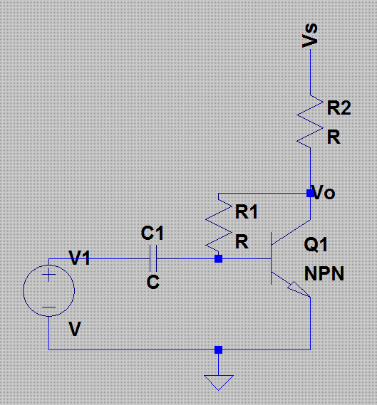

interview question
Ok it’s better to be helpful so here’s a little example from my interview questions.
In the figure with no additional information, what is the small signal AC gain? You can assume that resistor values can be chosen so that incidental properties of the transistor don’t matter.
ANS: ~(Vs-Vo)/Vt or ~40(Vs-Vo)
To the first order it does not matter which transistor or on any of its properties. A simple but profound result a gain of 40 per volt of drop no matter what. The fact that there is a T term in Vt also directly leads to PTAT (proportional to absolute temperature) biasing. If the interviewee insists on knowing the beta even after being told it does not matter they usually end up being sent on their way.
Re: interview question
I would say, very technological, production - specific answer is needed.
This is the whole spirit of American education: Engineers are less scientists, but more knowledgeable technicians prepared to work for companies making money on electronics.
dimitri said:
Scott, your circuit is confusing a little bit as it looks like R1=R2=R, transistor would be in saturation. Also you might mention that Vo is dc operating point and the question might be what is the small signal AC gain at relatively high frequencies?
The R's can be different but the transistor is definately not saturated there is at least a Vbe of Vce. Any midband frequency would do. It's an illustrative example gm = Ic/Vt and Ic = Vs-Vo that is something a new graduate should know.
