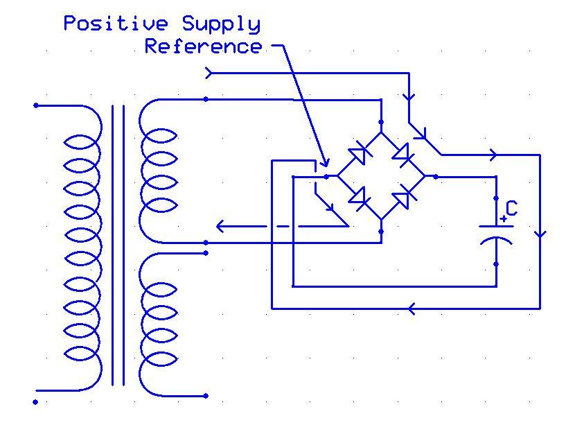

MikeBettinger said:
I’ve experimented with both approaches and sonically, when both approaches are implemented the same; I prefer a center-tapped approach. I hear the effect on strings and the purity of voices.

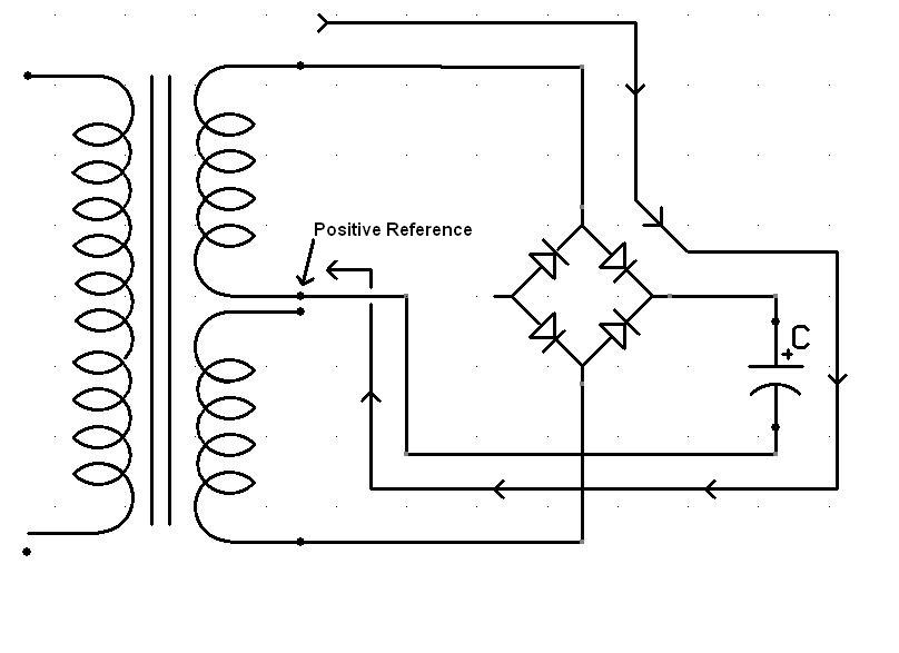

Wavebourn said:Mike;
Please explain once more, a bit slower this time: what happens with currents and voltages? I could not understand what do you mean.
Take a look at these two images.
And. Hopefully this clarifies the point I was making between the John's approach without center-tap and with center-tap and that the effectiveness of any filtering (mains or higher frequency on the secondary) will be affected by the implementation of the path to the reference, which is what I believe Jan is saying.
Mike.
Mike.

Confusion I guess
I guess I'm not being understood.
I'm commenting on John's post about diode switching noise and his suggesting that it could be contaminating the ground.
My comments were basically saying that, I agree that it can happen but, if the ground reference is working it should filter out this switching noise from the diodes through the filters (and their bypass caps). With a little care the noise (as well as any mains residual (60/120hz) does not have to contaminate the ground reference or circulate on any of the circuit grounds; or between components in a system.
It's my experience that the center-tapped design does a better job at this and the two images show the loop paths of both the center-tapped rectifier loop and the bridge derived ground reference loop. The second image illustrates the diode in series with the latter. From current probe measurments on this leg of the loop it is a less than perfect ground return for these currents relative to a center-tap arrangement.
I did not show the negative side because as far as what's happening at the bridge output it is irrelevent; as all of it's noise and charging currents are contained within the other secondary loop.
Hopefully this clears it up. If not we can let it go and move on.
Mike.
