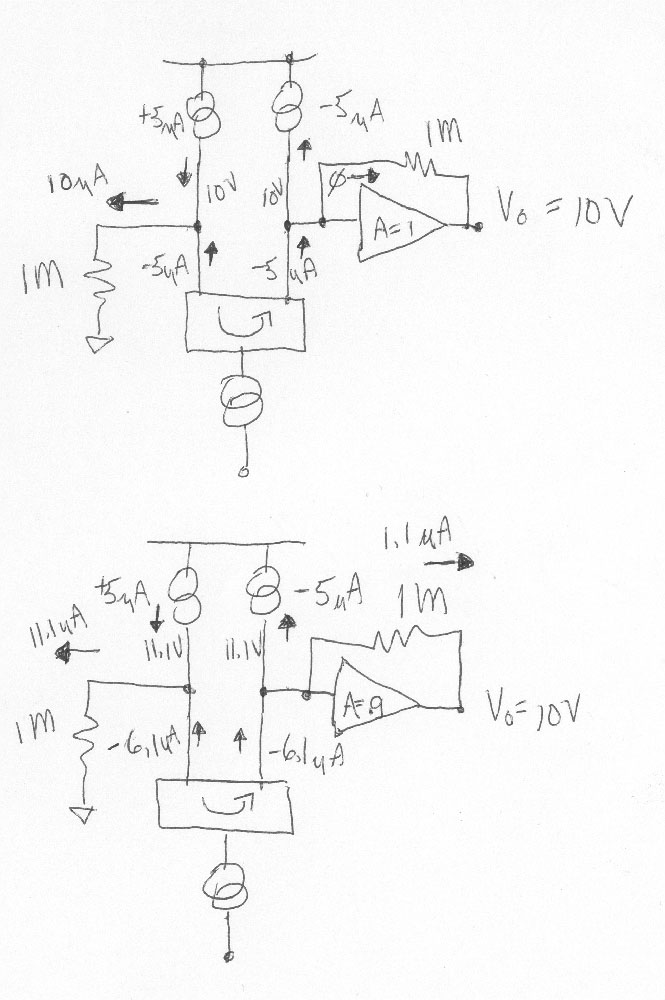

Let me clarify my needs: I have 2 separate circuits that I have to optimize.
One circuit has a gain of about 30, and is used to amplify phono MC cartridges.
The other MIGHT have a gain of about 30, but is used as the front end of my ST 1700B analyzer.
One is for listening, the other is for measuring.
Measuring is always a challenge, and I want to get to below -130, if possible, with 7th harmonic being the MOST important harmonic that I don't want to see on the screen. I, now, have some 7th harmonic on the screen. How can I reduce this? Is it the fault of the AD797 or is it some other IC or component in the circuit?
The other need is for best sound. Measurement is OK for such a circuit, but open loop linearity is suspect. This is more important to me than closed loop measurement, especially with the nasty pulse like signals that this stage is subjected to from the MC cartridges. I have measured them and published the results, so I know the mine field that I am walking in. I also make open loop designs that accomplish this task with flair, but they are too expensive and exotic to be used in a commercial product, such as the phono stage that Parasound wants to make.
I must use whatever IC that I get in the most optimum way, and this requires both inside knowledge of the design, and experience with the IC, even before the product is subject to subjective evaluation.
Not so easy, is it?

Traderbam,
I think I have a picture that explains the operation of the circuit. Taking a step back let’s just look at a DC case to show how the current mode cancellation works. I admit my use of the term neutralization might be unfortunate because it has a specific meaning in the RF world. In both cases we have a floating current mirror circuit trying to make 10V out with a load of 1M on the current mirror to ground. The input gm represented by the two current sources on top has to supply 10uA (differentially) to make 10V across the 1M load. The output buffer is in the first case a perfect G = 1 follower. In the first case the second 1M does nothing because the voltage across the buffer is always identically 0. In the second case let the buffer be G = .9, a fixed 10% error (in fact the input to output transfer function could be non-linear). I hope it’s clear that the output buffer supplies the current that is mirrored so that the input stage still needs exactly the same +-5uA to make 10V at the output i.e. the voltage transfer function of the output stage has no net error back at the input gm so that the global feedback does not see it. Please forgive that I rounded 1 1/9 to 1.1. Yes, if you want to consider a current mirror as a feedback circuit then you could argue such. These arguments like, “an emitter follower is feedback”, don’t send circuit design, as an art, forward. Extension to where the 1M resistors are replaced by the compensation capacitance should now be obvious. In this case the correction is only for AC signals which is OK since the DC gain is >5*10e6 anyway.
John - This IS a linearization of the open-loop transfer function.
Stinius – No the capacitance is the compensation capacitance parasitics are cancelled by symmetry
Wavebourn – I hope this explanation is OK.
