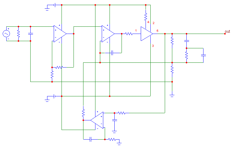

Just one question regarding the class D amp that you liked at the show, do you know if it was based on UCD or B&O or was it another design?
I made something similar and it is not that bad.
