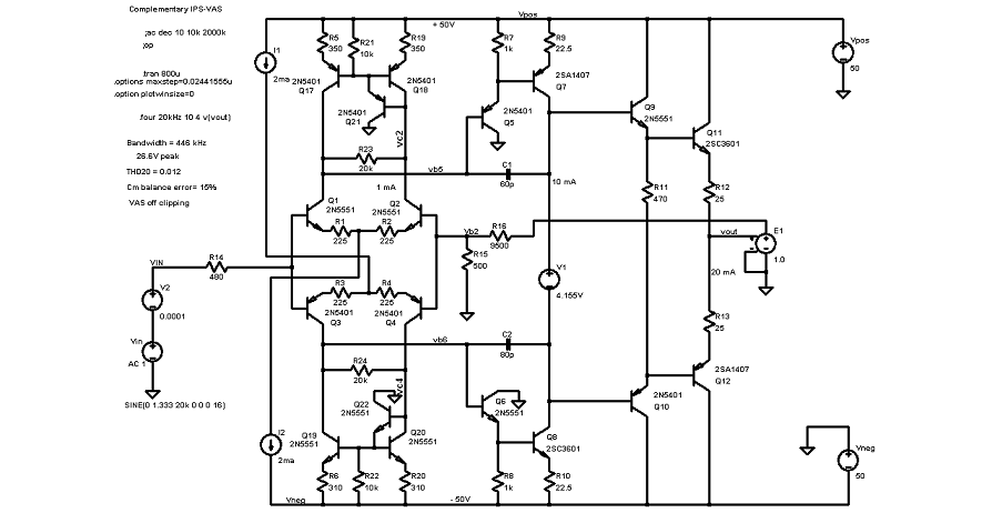

Below I have posted an example of one of the circuits I simulated which demonstrates the VAS fighting problem. At 20 kHz and about 27 V peak sinewave, the VAS current just softly cuts off.

Hi Glen,
Take a look at the circuit I just posted. This one is quite stable on the VAS bias and relatively un-crippled, yet it exhibits the VAS fighting problem. I want to emphasize that not all complementary input pair architectures are prone to this, but it is something that one should be on the lookout for.
Bob
