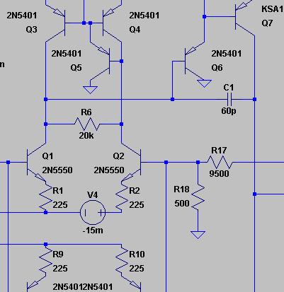

Re: Re: Re: VAS fighting
Hi Bob.
With 20k LTP loads is is not surprising that this circuit will have the VAS fighting issue.
However I have played with this circuit in the past and I can assure you that it does not work in real life with out a CMCL as the input stage gain is far too great (The VAS will not bias properly with the slightest Ic imbalance between the complementary long tail pairs.
Glen
Bob Cordell said:
Hi Glen,
Take a look at the circuit I just posted. This one is quite stable on the VAS bias and relatively un-crippled, yet it exhibits the VAS fighting problem. I want to emphasize that not all complementary input pair architectures are prone to this, but it is something that one should be on the lookout for.
Bob
Hi Bob.
Glen

andy_c said:Bob is talking about a complementary VAS in which the impedance "seen" by the bases of the VAS transistors is large - on the order of tens of kOhms. This makes the Miller loop gain large, which in turn makes the output impedance of each half of the VAS small in the audio frequency range (because of the high local feedback). This leads to the VAS "fighting" problem. Neither the Leach amp nor the APT will ever approach this condition without some major changes, so these amps have nothing whatever to do with this subject.
To be fair any non-ideal symmetrical VAS WILL have an issue with common-mode signal currents (I'm not just talking about VAS fighting here due to Miller cap values), it's just a matter of degree.
Any asymmetry in the gain between symmetrical push-pull stages will cause common mode currents to flow, and this strictly has nothing to do with frequency compensation. Even an LTP, for example, with a current mirror load will suffer common mode effects if the current mirror does not perfectly complement the opposing leg signal current.
The effect exists in the Leach amp and The APT (but not much). My main point regrading these two amps was to point out that electrically, they are both symmetrical topologies that inherently cancel even harmonics.
Re: Re: Re: Re: VAS fighting
Absolutely true, Bob's circuit is one of those simulation traps. As you already know, in simulations the VAS biases correctly even without any LTP load. Dare to build it 🙂
G.Kleinschmidt said:With 20k LTP loads is is not surprising that this circuit will have the VAS fighting issue.
Re: Re: Re: Re: Re: VAS fighting
The simulator will actually show you just how non-workable the circuit is, you just need to be aware of the issues and know what you are looking for.
Just insert a voltage source of several mV in series with the emitter of one of the LTP transistors to simulate an offset error between the complementary halves, then double check the quiescent VAS current 🙂
Glen
Glen

Re: Re: Re: Re: Re: Re: VAS fighting
I just simmed Bobs circuit. An input offset error of +/-15mV (between the complementary LTP's) is enough to cause the quiescent VAS current to vary ~ +/- 10mA from the nominal 10mA.
I guess the issue here could be described as input offset fight. If there is an opposing input offset error between the long tail input pairs, the global nfb can never steer both LTP's into balance (in attempting to balance one the other will be thrown out).
For optimum performance you really do not want the LTP imbalance to cause a variation of more than +/-10% to the calculated, or ideal VAS standing current. In the case of Bobs amplifier, this would mean trimming the input offset error between the complementary LTP's to 1.5mV or better.
The most basic fix is to limit the LTP gain so that the resultant Ic imbalance and the deviation in quiescent VAS current is maintained within reasonable limits (and this will also fix the VAS fighting issue 😀 )
Glen
