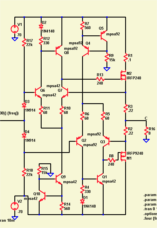

Talking about strange topologies , some amps use the
comp. differentials to drive the OPS directly (with no H7 at
all) This strange amp also sounds better than any I have
heard.. (attached)
OS

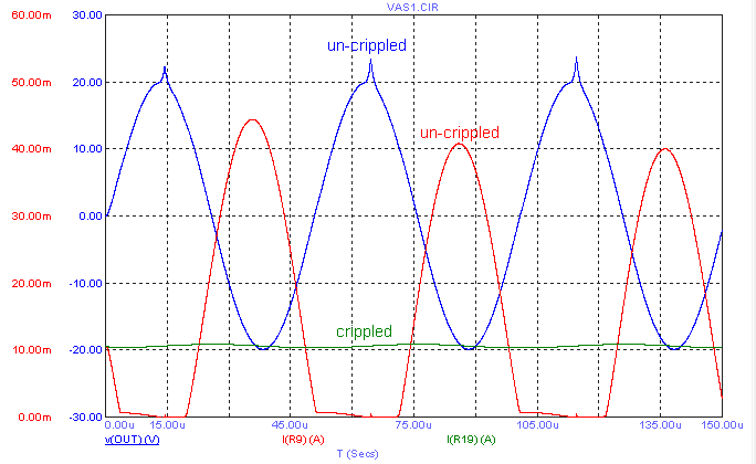

G.Kleinschmidt said:
I have to admit to being confused now because your experimental results have resulted in rather different conclusions to mine.
As far as the VAS common mode current that flows in a fully symmetrical design goes, as far as I can see, the value imbalance between the Miller compensation capacitors is a relatively minor issue (in some cases).
To illustrate the point I’ve attached a screen shot of a basic sim to this post.
The red trace is the output voltage (at 20kHz) and the green and blue traces are the PNP and NPN VAS transistor emitter currents respectively.
The VAS idle current is 10mA and there is about double the AC voltage swing in one VAS transistor than the other due to one Miller cap being 100pF and the other 150pF.
This is a significant imbalance, still, however neither VAS transistor comes close to being cut off.
[snip]
Glen
Hi Glen,
You are right, hardly any VAS fighting IF if the gain is considerably reduced (i.e. crippled) by terminating the inputs (of the VASes) with a low impedance (1k). However, this is what Bob said (bold font by me):
"The effect may be worse when the VAS is very un-crippled, with a very high impednace at its input (VAS transistors with emitter followers in front of them, stabilized helpered current mirrored loads top and bottom of the input LTPs)."
See below how devastating it can be.
Edmond.
