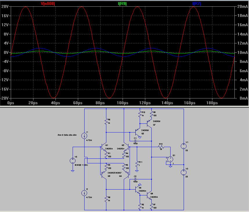

Bob Cordell said:
It is notable that John's JC-1 DOES NOT use the usual pair of Miller capacitors back to the VAS inputs, and so appears not to be subject to this problem.
I showed ages ago in another thread that the CM currents due to gm / Miller cap value imbalance need to be pretty large for the overall linearity of a typical amplifier to be significantly degraded (even for a class A TMC amp with ~0.001% THD-20).
The JC-1 has seems to have a such a non-linear MOSFET VAS anyway (the amplifiers rather high low-order harmonic spectra shows that the output stage distortion is not dominant) that even if it did have the conventional Miller compensation, I doubdt that even 10% capacitance value imbalance would make a jot of difference.
Hi Glenn,
I don't recall your particular simulation, but I have done simulations of a complementary bipolar input pair architecture that actually showed the VAS transistors going into cutoff under some conditions due to fighting. This may not always be the case with every design, but I was surprised how bad the effect was if I looked at the actual current flowing in the VAS transistor, rather than just looking at the output of the amplifier.
This was at 20 Khz, near full power. The VAS signal currents were fairly low when the pair of Miller caps was of identical value, but rose quite high when the caps were altered +10% one way and -10% the other way (e.g., 18 pF and 22 pF). The effect may be worse when the VAS is very un-crippled, with a very high impednace at its input (VAS transistors with emitter followers in front of them, stabilized helpered current mirrored loads top and bottom of the input LTPs).
The effect is likely less in situations where there is a lower impedance at the VAS input because this will reduce somewhat the local shunt feedback effect of the Miller capacitor, raising the output impedance of each half of the VAS.
Closed loop bandwidth was set to about 500 kHz and the output stage was an ordinary Triple. VAS bias current was 10 mA and each LTP tail current was 2 mA.
Take another closer look at some simulations and I bet you'll see the effect.
Bob

I have to admit to being confused now because your experimental results have resulted in rather different conclusions to mine.
As far as the VAS common mode current that flows in a fully symmetrical design goes, as far as I can see, the value imbalance between the Miller compensation capacitors is a relatively minor issue (in some cases).
To illustrate the point I’ve attached a screen shot of a basic sim to this post.
The red trace is the output voltage (at 20kHz) and the green and blue traces are the PNP and NPN VAS transistor emitter currents respectively.
The VAS idle current is 10mA and there is about double the AC voltage swing in one VAS transistor than the other due to one Miller cap being 100pF and the other 150pF.
This is a significant imbalance, still, however neither VAS transistor comes close to being cut off.
It probably should also be noted that a common mode signal current that flows in a symmetrical VAS can be induced by any gain imbalance between the positive and negative halves of the circuit and is not strictly a Miller capacitor tolerance issue (Using an alternative compensation scheme just removes one source of error).
This will possibly cause a stink, but IMHO jfets are not desirable devices for the input stage (LTP’s) of fully symmetrical topologies because of this.
The gm imbalance between obtainable N and P channel parts is too great. With bipolar transistors you have scope for linearization with emitter degeneration, which essentially makes gm independent of device parameters (within reason).
Glen
