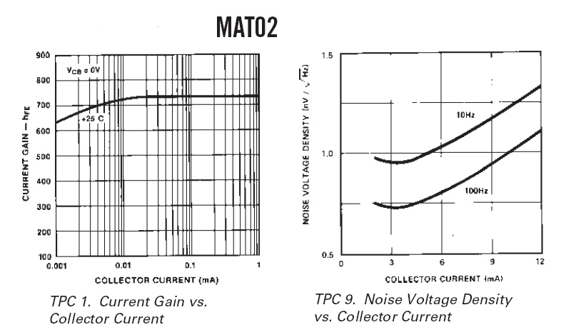

PH, I should have said 'beta peak' or the current where the beta is maximum. I have the graph in front of me, because Analog Devices used to think that such data was important to design engineers.
This is an exceptionally LOW 'beta peak current', as most small signal transistors peak at 4 ma or so, and many popular transistors peak at 50 ma or so. This is why I asked Scott the question in the first place about his AD797. Now, this may make it more clear, as to why I needed this info.

Graph - me too, at least for the AD820 series. It's pretty dog-eared by now. For the NPNs, I only have a brochure-like thing for all the old AD duals.
It seemed low - and thanks for mentioning that.

John -- do you have any idea/guess how closely the VBE of the transistors in one AD810 might match another - separate - AD810?
Phil
Phil
Anywhere above 100 ua, I would guess, but isn't that the exception, not the rule? Or is every AD component that good?
PH104, I suspect they would track fairly closely. The big problem for me has been the Vbe 'matching' of the NPN's to the complementary PNP's. It seems to me that time constants in fabrication would really make the difference in any NPN's, so batch to batch might be slightly different.

Since the gm of a bipolar has nothing to do with absolute Vbe, I don't see how this would matter. I would think 60mV or so would be the most difference you could ever see.
