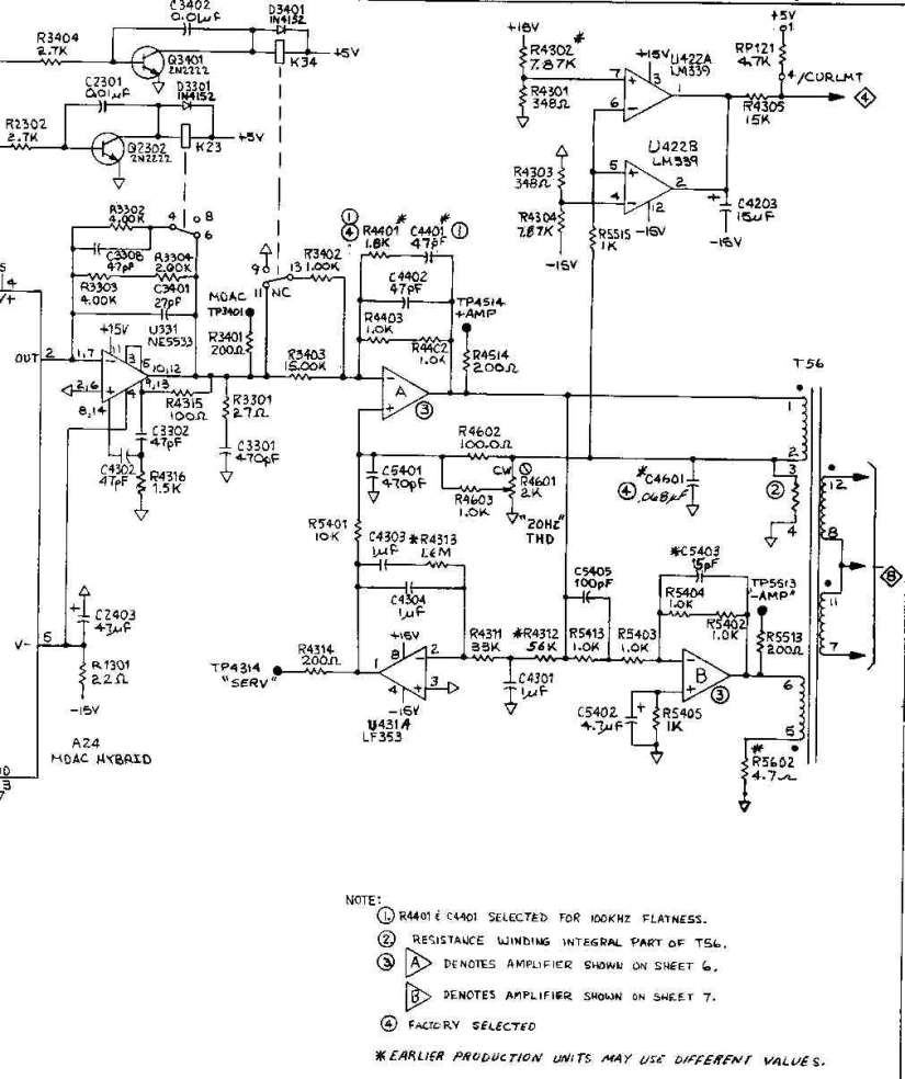

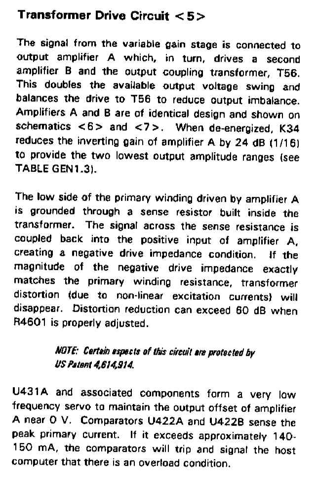

That AP output stage with the transformer is a beauty. The transformer non-linearity is cancelled, sort of, with pos feedback in the driver stage. A source with <-120dB harmonics, with transformers and relays. Eat your heart out, transformer-and-relay-haters! (I could post the circuit if anyone is interested?).
This is one of several patents in that instrument. After 25 years (and AP just announced end-of-service for the S1) this still remains one of the best instruments if not THE best in it's area. When you think hard and long about a distortion analyzer, chances are you come up with a used S1 for the money.
Sorry for the off-topic rant; I LOVE these things for flawless design and execution.
