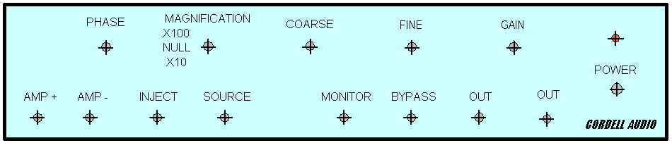

dimitri said:For my limited knowledge, the first distortion magnifier was used here: Jan Lohstroh and Matti Otala, "An audio power amplifier for ultimate quality requirements." IEEE Transactions on Audio and Electroacoustics, Vol.AU-21, No.6, December 1973, pp. 545 - 551.
Does anybody aware about earlier implementation of this idea?
Yes, this is a pretty old idea. I first used it in 1983 to make possible the distortion testing of my MOSFET power amp with error correction, and mentioned it in my JAES paper.
Bob
Joshua_G said:
Thank you, Bob.
Any chance for a detailed schematic?
Hi Joshua,
Let me see if I can dig something out of my files. The DM was implemented on perf board and the schematics were hand-drawn.
Send me an email.
The pic below shows the front panel layout.
Bob

Hi Chris,
Good point about the web site. I'm embarrassed that I have not kept adding material to the web site. Twenty four hours sometimes is just not enough in the day. I should probably spend less time posting on DIYaudio and spend more time putting material up on the site 🙂.
Bob
