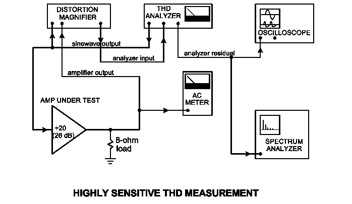

Hi Chris,
Here are a few more details regarding how I do distortion measurement and fight noise. I hope this helps. Most of what I’ll talk about is measurement of THD, but I’ll also touch on 19+20 kHz CCIF. All of this is an analog-centric approach. However, the analog spectrum analyzer I use could clearly be replaced by a digital sound-card-based spectrum analyzer.
The figure below in this post shows my overall setup for THD measurement with the maximum sensitivity I can achieve. It is built around my THD analyzer, which by itself can see down to below 0.001% out to THD-20 in a 200 kHz bandwidth. It filters the residual with a tracking second-order LPF at high frequencies. This means that it will read 20 kHz THD out to the 10th harmonic.

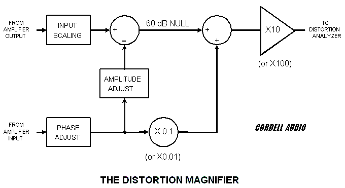

I precede the THD analyzer with my Distortion Magnifier (DM), whose block diagram is shown in the next post. It subtracts a version of the input signal from a scaled version of the signal from the DUT to form a deep (>60dB) null at the fundamental. A controlled amount of the source signal is then added back to achieve a known amount of distortion magnification, either 20 dB or 40 dB. This also provides fundamental energy needed by the distortion analyzer to lock onto.
The DM magnifies the distortion of the DUT without magnifying the distortion (and noise) of the oscillator. My analyzer’s lowest range is 0.003% FS. If I use the DM in front with 40 dB magnification, that becomes 0.00003% FS. Of course, this is generally noise limited.
The DM includes coarse and fine amplitude and phase adjustments to optimize the null. The phase adjustment is simply a first-order LPF that constitutes a very simplified model of the amplifier DUT. Amplitude and phase must be tweaked a bit if the fundamental frequency is changed. Because of the simple model, there will be some amplitude and phase error at the higher harmonic frequencies that will detract a bit from the cancellation process, allowing a bit of oscillator noise and distortion to come through. A more complex model of the DUT high-frequency response could be used, but I have not found that necessary for my use. Similarly, the DM could incorporate low-frequency phase matching for low-frequency THD measurements on AC-coupled power amplifiers, but that has not been implemented.
I then send the distortion residual out from my THD analyzer to the HP3580A spectrum analyzer to knock out the noise and see the individual spectral components.
For THD-20, the use of the spectrum analyzer is too limited, since it only goes out to 50 kHz. The use of the DM in front of the THD analyzer still helps greatly, largely causing the noise floor for THD-20+N to be limited by DUT noise.
For evaluation of amplifier high-frequency nonlinearity, I prefer 19+20 kHz CCIF with spectrum analysis, just like what is done in the Stereophile reviews. Here I use a custom-built twin-tone generator with a very low distortion summer. This becomes the source for the DUT and the DM. The output of the DM is then fed into the spectrum analyzer. The analyzer is rated for 80 dB dynamic range. If the DM is set to 40 dB magnification, the combination ends up with a usable dynamic range of 120 dB. The DM also has a switch position where NO source signal is added back into the path, leaving only the 60+ dB nulled signal to go into the spectrum analyzer (which does not need any fundamental to lock onto).
Hope this helps,
Bob

For my limited knowledge, the first distortion magnifier was used here: Jan Lohstroh and Matti Otala, "An audio power amplifier for ultimate quality requirements." IEEE Transactions on Audio and Electroacoustics, Vol.AU-21, No.6, December 1973, pp. 545 - 551.
Does anybody aware about earlier implementation of this idea?

Hi Bob,
Thank you very much for responding. I've got a copy now and I'll be able to try these things out with my equipment. You may have helped me quite a bit here!
-Chris
Edit: I've been looking at the residual output from the THD meter for years. That alone is a huge advantage over simply noting the number.
