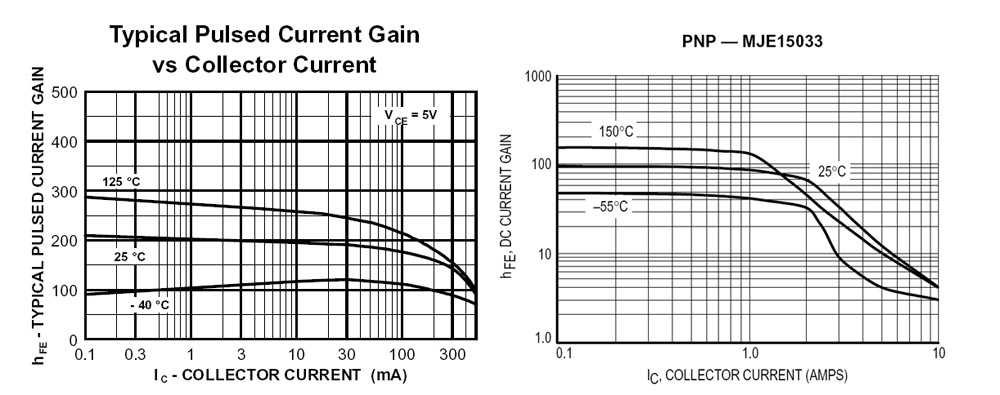

Here's a quick example from a MOTO datasheet. I don't consider the slight monotonic rise in beta interesting YMMV.
On another point the axes are mislabeled on several plots (1000A indeed). This is indicative of a sloppyness that is sweeping our industry.

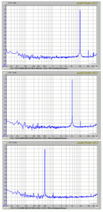

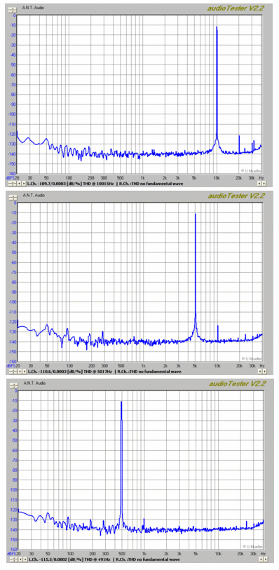

I checked my setup for its capabilities for measuring 5 kHz THD (THD-5). The setup consists of the THD analyzer I designed a long time ago (it uses 5534 op amps, mostly) where the residual distortion output is fed to an HP3580A analog spectrum analyzer that can go up to 50 kHz. This analyzer is pretty good at getting the noise out by selecting a very narrow bandwidth, but that is at the expense of long sweep times. I think these measurements were done with a 30Hz bandwidth and 100 seconds per division sweep time. The distortion analyzer was just connected back-to-back, with 1 V rms going across.
The meter on the analyzer read 0.0006%, or about -105 dB (THD+N) in a 50 KHz bandwidth (my analyzer always LFP’s the residual signal at a frequency equal to 10X the original).
The second harmonic was most prominent, and it read -106 dB. I think this is distortion from the oscillator leveling circuit. Third read -124 dB, and everything else was in the grass, which was at 130 dB. The readings took about 17 minutes to get, due to the slow sweep time – one of the disadvantages of the old-fashioned analog approach.
My analyzer would probably profit from more up-to-date op amps to reduce the noise and residual distortion, and possibly some tweaking of the oscillator to get the second harmonic down further.
Largely because of my spectrum analyzer bandwidth limitation and my desire to conduct distortion measurements at higher frequencies, my preferred method these days is to do CCIF 19+20 kHz tests. This is also easy to compare to the same kind of tests done in Stereophile. The spectrum analyzer specified dynamic range of only 80 dB (90 dB on a good day) is a limiting factor here, so I must do a subtraction. I do it in the analog domain using my Distortion Magnifier, which magnifies distortion by 20 dB or 40 dB before it is applied to the spectrum analyzer (it just subtracts a scaled version of the generator signal from the output of the DUT, with careful gain and phase equalization). This allows me to see down to about -120 dB on the CCIF test. One thing that is nice about the CCIF test is that the two oscillators themselves do not have to be extraordinarily low in distortion; only the summer has to be really good.

Scott, compromise is not MY middle name. Isn't that a PNP transistor? If so, well DUH! The IC NPN example that I got from Raytheon looks like a mountain range.
However, not all is lost. Even if you used the Gummel Poon model, you would see big problems, but apparently the newer model, VBIC, shows more linearity over the center range of the device.

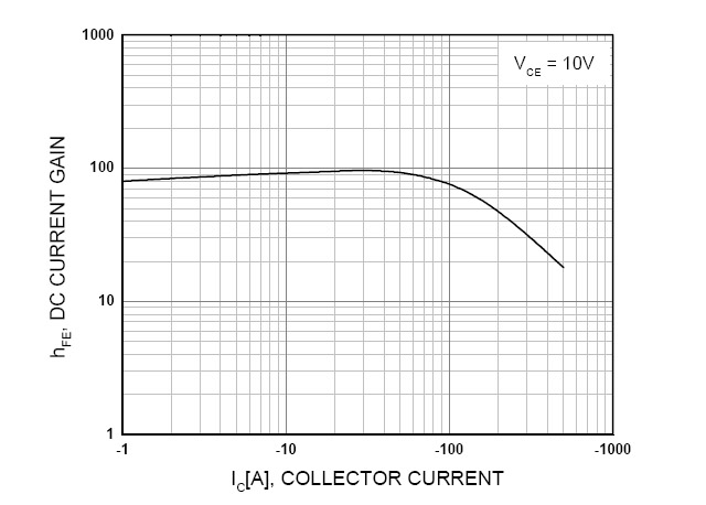

A couple more. The one on the left is the venerable 2N4401, no peak beta (@25C). Please show me an well designed output stage where the beta induced distortion is more than the Vbe vs Ic transfer function non-linearity.
Hi John,
Wow, there's more data on the 2N2219 and others there than normal in the book. I was looking for other devices and ignored these. I have used them for many years in housekeeping applications.
Also, I'll agree that the beta non-linearity is a problem. That's why I had been using JIS parts for years, and why I'm so happy about On Semi's new outputs. Ain't perfect, but much improved.
