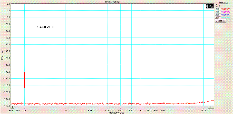

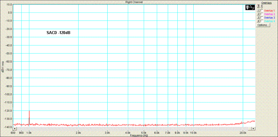

john curl said:Oh, SACD is perfect. Wow! However, at my place, records still sound better. Go figure.
Really?
To me not. Especially not the classical music - great orchestra and big difference in dynamics.
Hi John,
I think records sound better to some people because of the different way in which they are typically mastered. This is a subjective thing, so different people will react differently.
The mastering of a record must take into account a host of limitations of the LP medium. Groove amplitude, velocity and acceleration must all be controlled with limiting, compression or careful gain-riding.
Moreover, some of the results of these actions, like limiting, will subsequently be softened by the RIAA equalization at the far end.
All of this can tend to soften and smooth the sound of an LP. This is not necessarily a bad thing, even though technically it is a departure from transparency.
The digital media does not have as much limitation in regard to the equivalants of groove velocity and acceleration, so some of that mastering activity that may have softened the sound and made things more forgiving may not be there.
This all is why it actually makes sense that Michael Fremer rips LP cuts to CD to demonstrate the LP sound.
Bob
