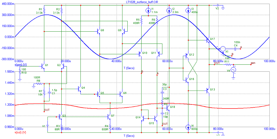

How about additional active filter (so called 'capacitance multiplier') behind the monolithic regulator? BJT, or MOSFET? Why MOSFET, why not BJT?
Reduces noise and improves HF suppression considerably.
For Scott Wurcer
I tried something similar, there is an improvement compared to
http://www.diyaudio.com/forums/showthread.php?postid=1722023#post1722023
