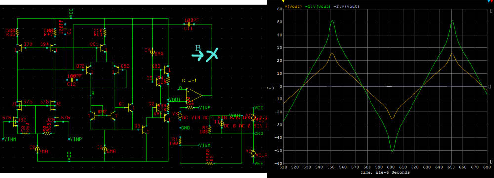

I cooked up this little demo of the crossover distortion removal (797) applied to a fairly ordinary amplifier architecture, the only difference being the differential ”chasing its own tail” VAS. BTW with some work this would make a nice little discrete op-amp even without the error correction.
Because this is a two stage amp, the trick involves a unity gain buffer in addition to the cap. The simulation results show three plots. The amplifier is in a gain of 100 with +-100mA at 10kHz being shoved into the output. The orange plot is with G = 0 on the buffer (little triangle in schematic) and shows the glitch due to the crossover (PMA, sort of looks like your “other guys” plot?). The white plot is with G = -1 showing virtually perfect cancellation. The green plot is with G = +1, horrors positive feedback? No because it’s not feedback, the error is just doubled. In fact if you break the loop at “B” you will see that there is no loop gain (in fact huge attenuation). The little triangle is indeed just a gain of -1 buffer and this is just subtractive neutralization. In all three sims the displacement current in the comp cap (C12) contains the same distortion signal, but at G = -1 it is cancelled exactly by subtraction.

Re: For PMA
Thanks, I will review it.
scott wurcer said:(PMA, sort of looks like your “other guys” plot?). The white plot is with G = -1 showing virtually perfect cancellation. The green plot is with G = +1, horrors positive feedback? No because it’s not feedback, the error is just doubled. In fact if you break the loop at “B” you will see that there is no loop gain (in fact huge attenuation). The little triangle is indeed just a gain of -1 buffer and this is just subtractive neutralization. In all three sims the displacement current in the comp cap (C12) contains the same distortion signal, but at G = -1 it is cancelled exactly by subtraction.
