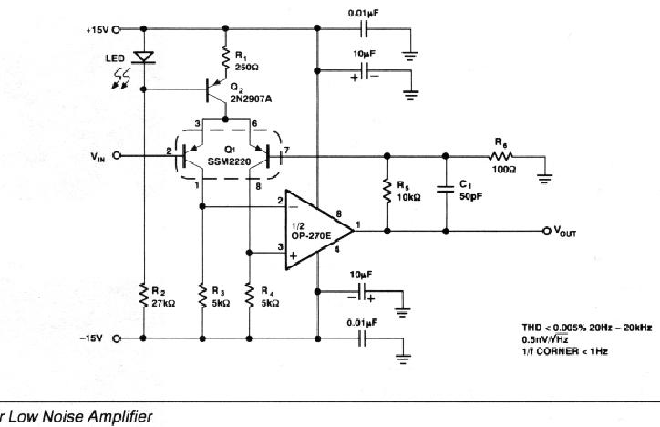

syn08 said:
With the attached MC input stage I got 0.3nV/rtHz using regular K170BL/J74BL with Idss=11+/-0.5mA and 0.25nV/rtHz with selected (for noise) devices. It is also rock solid stable.
The complete MC uses a few more high voltage opamps (OPA552), has servo (OPA445, hence no film or electrolytic caps in the signal path, except for decouplings and the output optional 10uF polypropylene). 28dB headroom (+/-24V supplies, +/-16V for the input stage), 64dB gain, 0.01% distortion mostly 2nd harmonic, RIAA better than +/-0.1dB.
All the above measured and consistently confirmed. BTW, it's a dual mono construction hosted (preliminary) in a single 6 x 6 x 2 inch 0.1" aluminum case with two magnetically shielded 25VA toroids on board. 108dB channel separation, if somebody cares about.
It's part of HPS 3.0 soon to be finished and posted in the HPS thread. Don't worry, it sounds amazing even with that much feedback.
I'm not planning to get into business and sell this stuff so your old SCP-2 record is safe from a commercial perspective 😀
Next, down to under 0.2nV/rtHz with BF862, SMD parts (including inductors), etc... Hard to find good SMD parts (in particular resistors), but not impossible.
syn08 said:BTW, I gave up the Jung regulators. They are not really required.
Well duh.
Way back when you asked about getting around the PSRR problem of single common source input stage, I suggested the discrete differential input + opamp topology.
Saves having to find complementary input devices too.
Glen

Sorry Glen, but that's a pretty poor design for ultra low noise. A differential stage has 3dB higher noise than a single ended (and HPS is single ended!). The CCS is happily injecting common mode noise in the input stage. Maybe not a big problem with bipolar superpairs (haven't tried, I don't think bipolars are the best way for MC) but certainly a problem with JFETs (even 2SK389); even the smallest mismatch will show the noise at the output. Designing an ultra low noise CCS should be treated as a separate project...
BTW, the spec in the schematic you posted is :bs:. Only the 100ohm feedback resistor has a noise contribution of 1.3nV/rtHz. Do you think I'm using 1ohm 0.5% feedback resistors just for fun?
Jung regulators are now replaced with LM317/LM337 and parallel post regulators as shown. Works as a charm, PSRR is measured at about 106dB for the positive supply and 100dB for the negative supply. The negative regulator has a slight noise peak at around 10KHz, certainly nothing to worry about.
