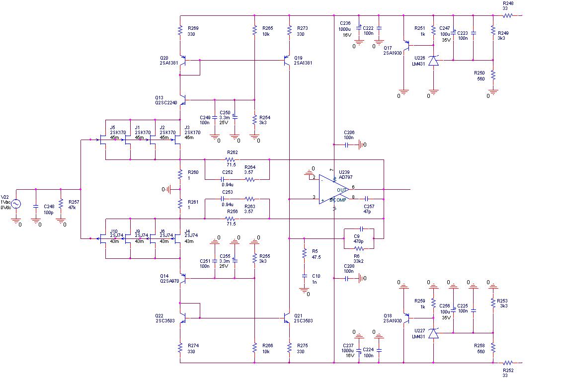

With the attached MC input stage I got 0.3nV/rtHz using regular K170BL/J74BL with Idss=11+/-0.5mA and 0.25nV/rtHz with selected (for noise) devices. It is also rock solid stable.
The complete MC uses a few more high voltage opamps (OPA552), has servo (OPA445, hence no film or electrolytic caps in the signal path, except for decouplings and the output optional 10uF polypropylene). 28dB headroom (+/-24V supplies, +/-16V for the input stage), 64dB gain, 0.01% distortion mostly 2nd harmonic, RIAA better than +/-0.1dB.
All the above measured and consistently confirmed. BTW, it's a dual mono construction hosted (preliminary) in a single 6 x 6 x 2 inch 0.1" aluminum case with two magnetically shielded 25VA toroids on board. 108dB channel separation, if somebody cares about.
It's part of HPS 3.0 soon to be finished and posted in the HPS thread. Don't worry, it sounds amazing even with that much feedback.
I'm not planning to get into business and sell this stuff so your old SCP-2 record is safe from a commercial perspective 😀
Next, down to under 0.2nV/rtHz with BF862, SMD parts (including inductors), etc... Hard to find good SMD parts (in particular resistors), but not impossible.
PMA said:R257 value is for MC?
If you like it so 😀 It's selectable via DIP switches like in HPS 2.0 (10ohm to 47KOhm). Same with C248 (100pF to 500pF).

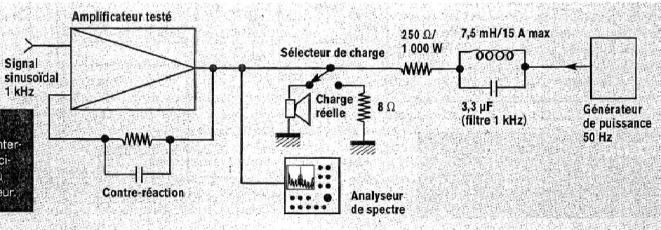

Bob Cordell said:
Hi Joshua,
No. Otala's method for measuring IIM involves feeding a large 60 Hz signal into the output of the amplifier under test through a resistor, like 8 ohms. I just followed Otala's test approach. I don't know of an IIM test that would employ a loudspeaker in place of the resistor in the Otala IIM test.
Bob
Okay, Otala's method for measuring IIM doesn't include a real speaker, or an emulation of it.
Do you think that better real-world results will be obtained by using a real speaker, or an emulation of it?

Lovely design and results SYN08, well done. I don't suppose you have a PCB layout available by chance?
Joshua,
This test feeds the 60Hz test signal in *series* with an 8 ohms resistor into the amp output. It is a specific protocol to measure IIM and compare different amps. As such, it doesn't have a direct relation to a real speaker.
If you want I can send you some literature on this, I think I have something in my library.
Edit: The attached is the way Jean Hiraga did this test. It looks like I was wrong, he does include either an 8 ohms load or speaker load, and feeds the test signal through 250 ohms. In a perfect amp you would only see the 1kHz at the output, not the 50 (or 60) Hz external signal.
But this may be a slightly different test than Bob alluded to.

alansawyer said:Lovely design and results SYN08, well done. I don't suppose you have a PCB layout available by chance?
Of course I do 😀 Just wait a little for the next revision, there are a few last moment minor changes.
All parameters are measured on the real thing, I don't do simulations only 😀

Syn08,
Which attachment are you referring to on your MC input stage, because I don't see anything attached 😕
courage said:Syn08,
You don't see the schematic?
courage said:Well, strangely I can see all other attachments posted, but not yours.
Franklin
The schematic is attached as a link to my web site. You may be one of those that have lately strange connectivity issues to www.synaesthesia.ca Can you access my web site?
Better say he displayed image directly from web addres, no need to be logged (img). Maybe syn08 would like to write the link in a plain html text, for those who have higher security settings.
http://www.synaesthesia.ca/files/input_stage.JPG
