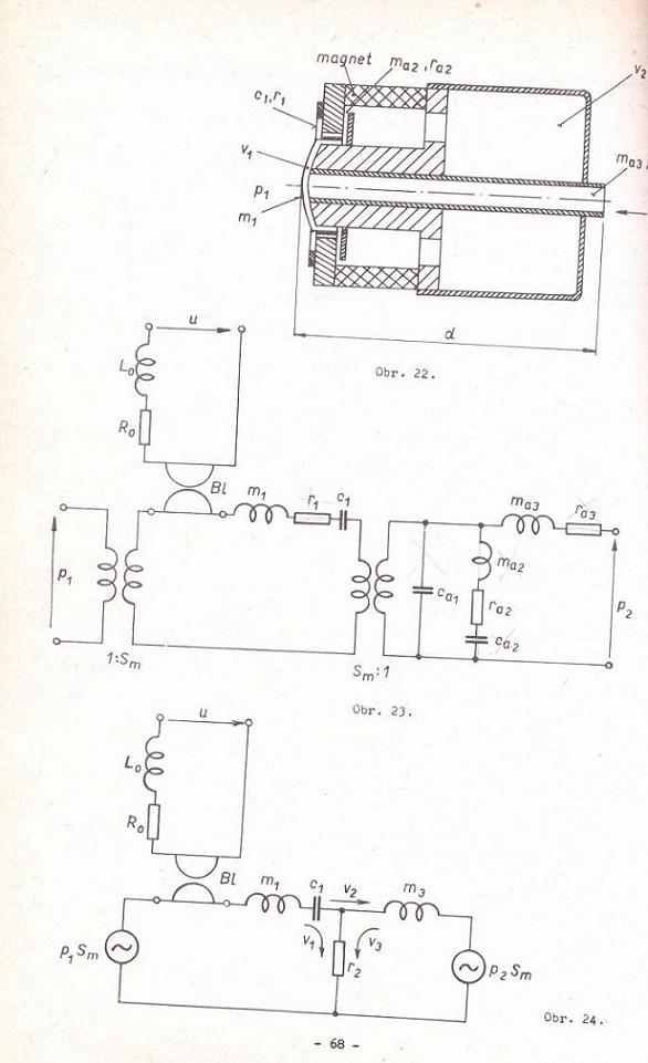

Okay, but guys usually argue with 'energy exchange' (like gossip), not knowing what it means and how it is included in the electrical dummy schematic.
